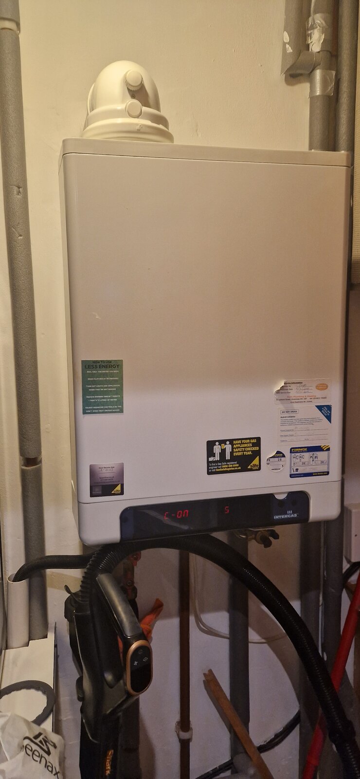

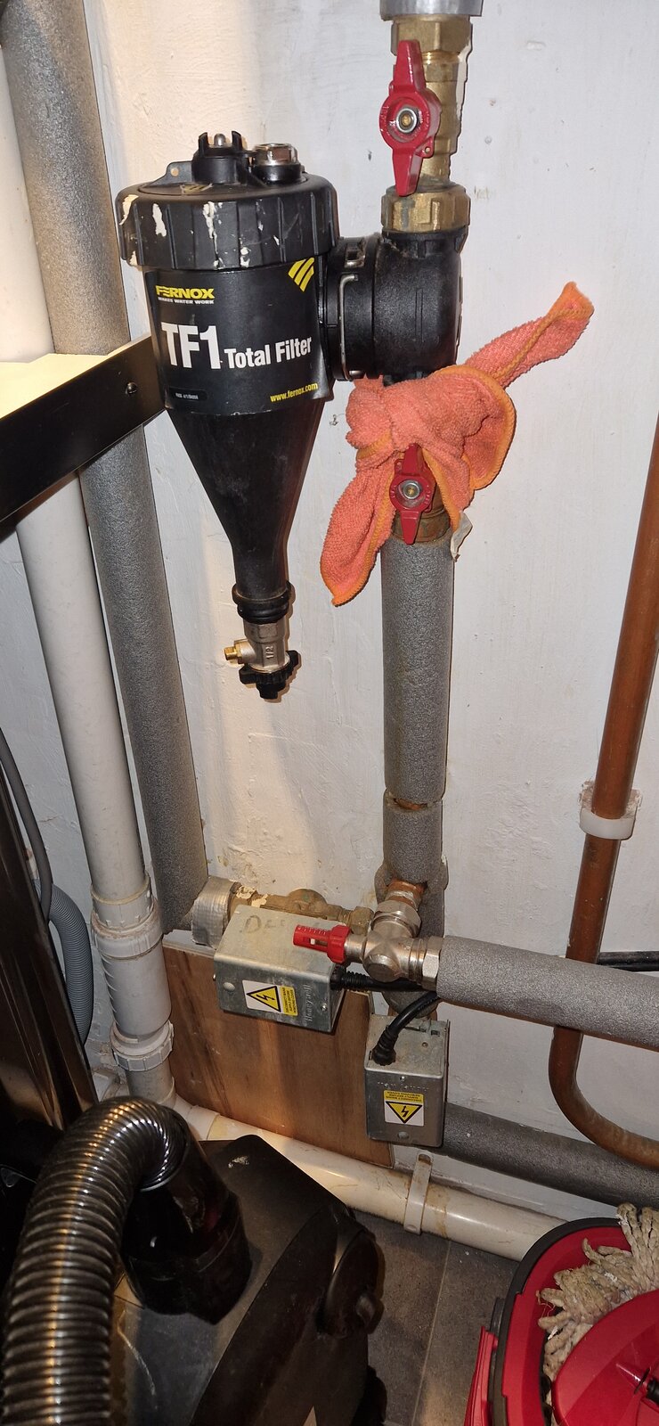

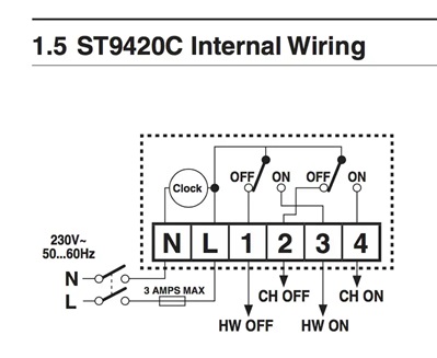

Hi guys,
I've been searching the net for weeks now for any info and struggling to get someone out to change my thermostat system to the Google nest.
I've got a programmer, thermostat and a water tank receiver. Struggling to understand how the nest would communicate with the water tank if the honeywell set up is removed?
I'm being told by some that I might not be able to get the google nest learning thermostat installed. Please help.

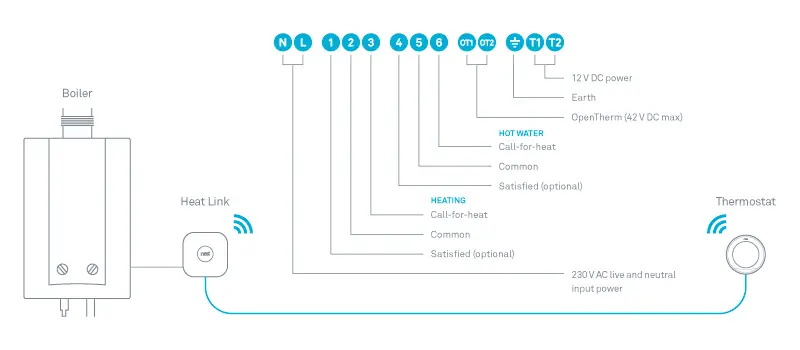

Looks like you have a Honeywell ST9400C programmer. Which as you rightly point out includes hot water control. The version of Nest that has hot water control is the Nest 3rd Gen. There is another version called Nest-e which is for combi boilers and doesn't have hot water control.
Assuming your programmer is a ST9400C as the diagram below, the wires are simply moved from there to the Nest Heat link terminals that have exactly the same function. L, N and E are straight forward, but for the heating and hot water functions, the terminology is slightly different, but can easily be worked out. For example Honeywell 'CH ON' (4) corresponds to 'Nest Heating Call for Heat' (3). Likewise, 'HW ON' (3) corresponds to 'Hot Water call for heat' (6).
Nest 3rd Gen
Nest also requires a link between Heat link terminals L, 2 and 5
The Nest thermostat is connected to terminals T1 & T2 which provide 12v for its operating power

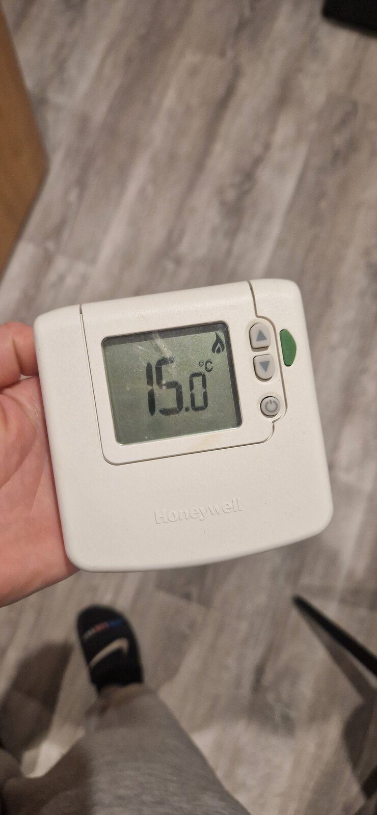

Then the old room thermostat needs decommissioning. The receiver in your photo looks like a Honeywell unit, the most common is a BDR91, but yours looks different. However, inside there will be an N & L and two live switching terminals. The wires in the two live switching terminals need to be joined together to by-pass the old thermostat. If you need more help with this, more details of the thermostat receiver and its wiring would be needed.
Nest 3rd Gen

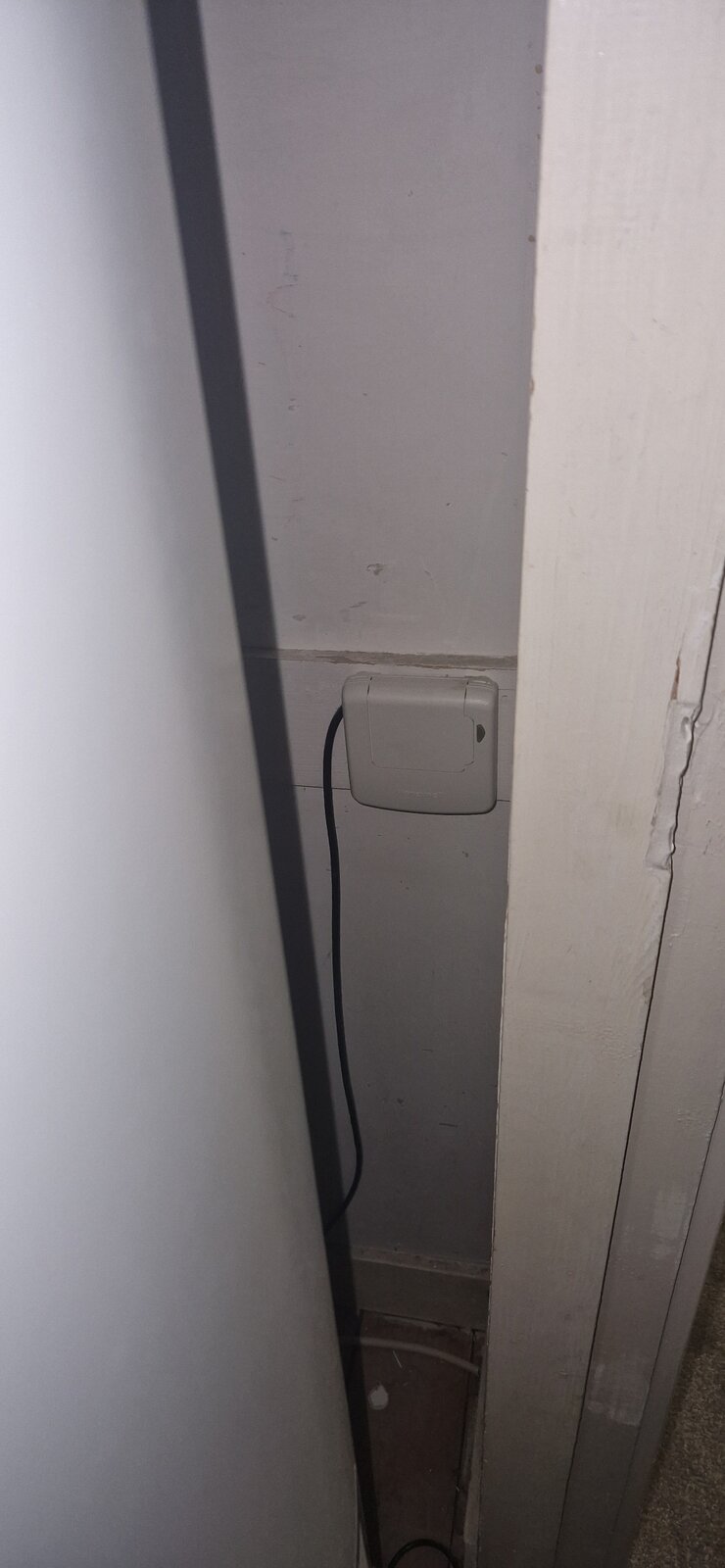

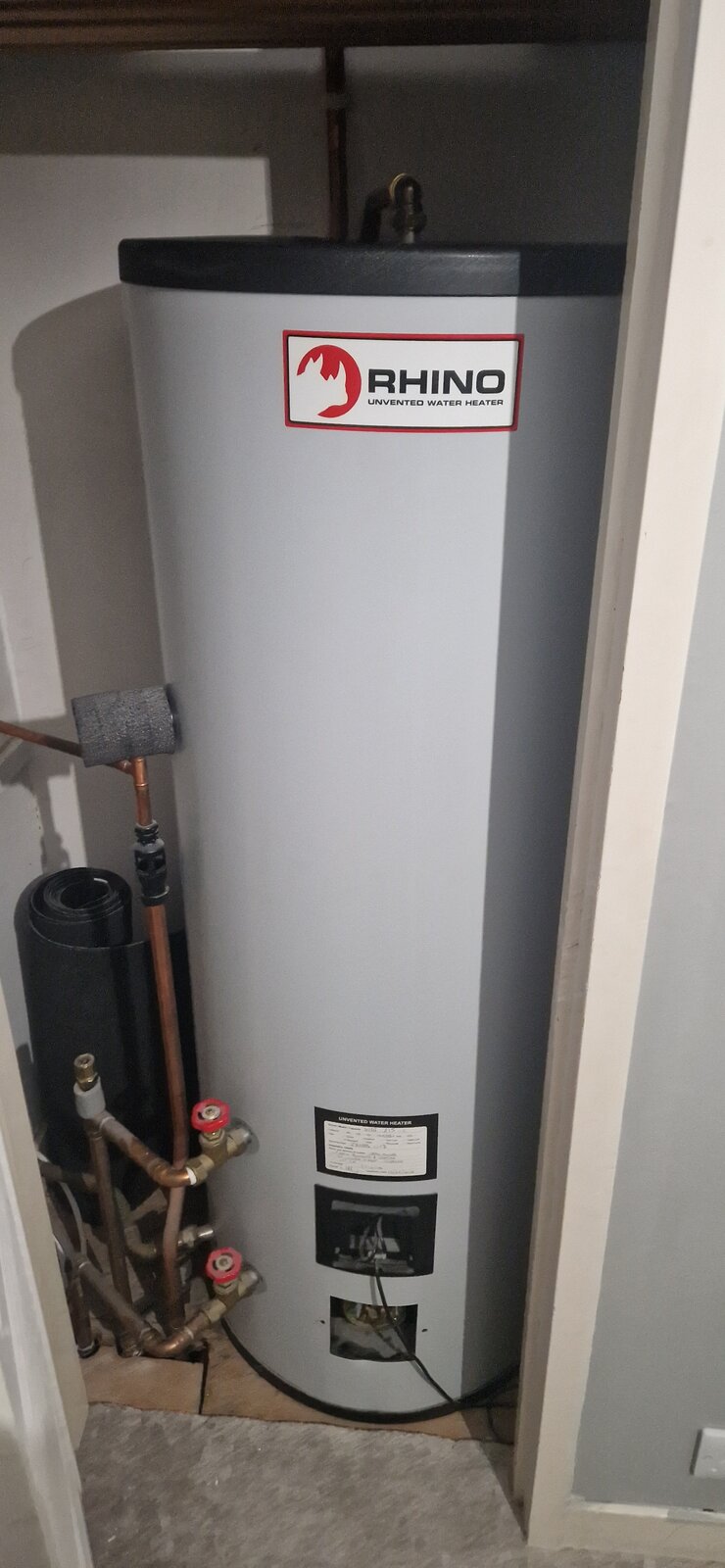

The receiver at the cylinder is battery operated and has a single black wire coming from it and has a metal head on the other end which sits in a wee hole in the cylinder tank.

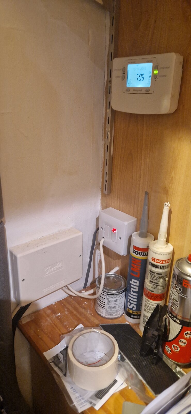

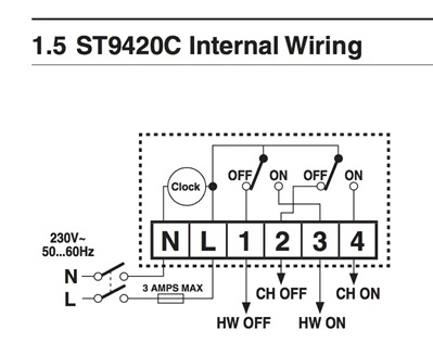

I've just checked my programmer and its a ST9420C.

The ST9420C is the receiver for both stats.
See attached.
Your set up is beyond DIY unfortunately
As a DIY workaround (a slighty inelegant solution!), I would look to retain the ST9420C and tank sensor; having terminal 3 (HW NO) of the ST, feed terminal 5 (HW common) of Nest. The wire that was in ST9420C 3, would go into Nest terminal 6 (HW call-for-heat) - the Nest would then have timing authority, when the ST9420C retains over temperature cut-off.
The other connections to Nest, would be made appropriately, with only a Live bridge required to terminal 2 (C/H COM).

OK, the ST9420C has the same electrical connections, as the ST9400C, so the wiring is the same.

The only thing I have at the cylinder strangely is the little white box that has that black wire coming from it. No thermostat attached to the cylinder though.
I have the same, no thermostat on the cylinder, but I am running C Plan, and you seem to be running S Plan, I can see two motorised valves. I don't understand why you want Nest Gen 3, as I am looking to move to Hive as well, as Nest has no ability to link to TRV heads.

You would do that with my suggestion.
You would set the Honeywell to a constant set temperature (for the hot water) and forget about it.
You would use the Nest to control the on and off times as you so wish, by the app.
Alternatively, to do a full replacement, you would need to add extra wiring and replace the tank stat.
And as it's an unvented tank, that would need to be done correctly.
