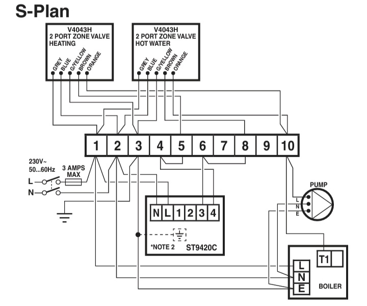

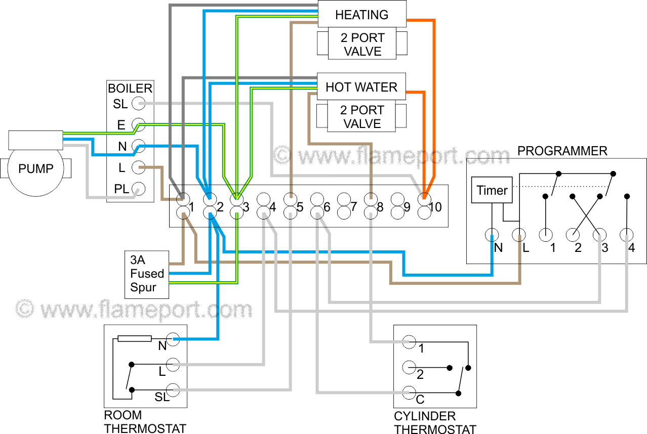

You appear to have an 'S plan' system.
Typically this includes a wired tank stat and room thermostat.

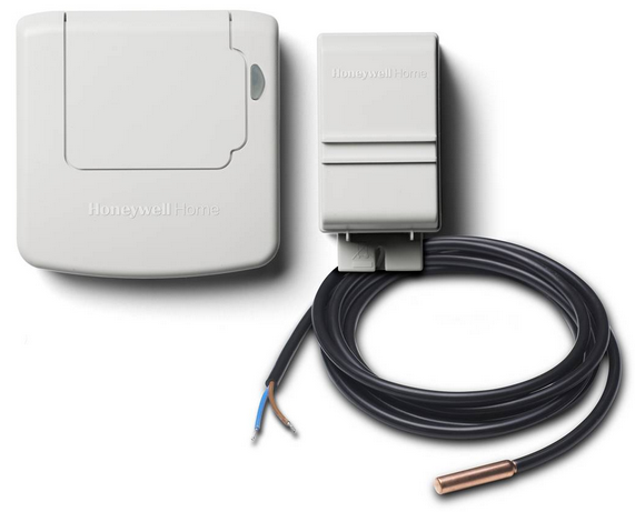

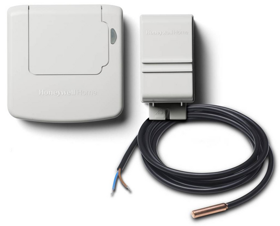

The Honeywell RF2 pack 3, simplifies this setup, by making it wireless.
From this...
To this...

Any change of controller will require a new tank stat and wiring going back to the wiring centre.
Another question, is there something I could potentially get to replace/upgrade the wireless device at the tank that could speak to the nest?
I'm afraid I don't know of such a device, others may - but it wouldn't speak to the nest. It would connect into the wiring centre.
As we've suggested, with this workaround; Nest controls the hot water on and off times, whilst the Honeywell only maintains the overheat cut-off, without the need for any additional work on the cylinder, or additional wiring through new floors.
So basically I'd have to keep the honeywell programmer and run new wires to connect the heatlink that comes with the nest?
Yes...
having terminal 3 (HW ON) of the ST, feed terminal 5 (HW common) of Nest. The wire that was in ST9420C 3, would go into Nest terminal 6 (HW call-for-heat) - the Nest would then have timing authority, when the ST9420C retains over temperature cut-off.
The other connections to Nest, would be made appropriately, with only a Live bridge required to terminal 2 (C/H COM).
The other appropriate connections...
Feed the Heatlink with a Live, Neutral and Earth connection.
The wire that was in ST terminal 4 (C/H ON) would go into Heatlink terminal 3.

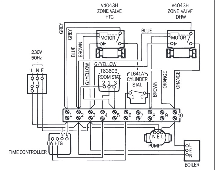

I have the same, no thermostat on the cylinder, but I am running C Plan, and you seem to be running S Plan, I can see two motorised valves. I don't understand why you want Nest Gen 3, as I am looking to move to Hive as well, as Nest has no ability to link to TRV heads.
I am not good at plumbing, so employed a plumber, who in turn employed a heating engineer, who admitted to me they had not got a clue about how to wire it up. Lucky I did, but had not realised Nest does not link to TRV heads, the instructions I had read said they did, but it seems when google took over Nest support was withdrawn.
Domestic hot water (DHW) during summer was simply timed, the floors in my house mean hard wiring is out, so needs some wireless method if using a thermostat, ½ hour 4 times a week gave me hot water to wash hands, today I use an immersion heater and iboost+ so in summer DHW heated with spare solar energy from the solar panels.
But had I not been an electrical engineer not sure how I would have got it wired up? @stem is normally good at working out what to do, but it is hard to realise what others can understand, and was shocked at the comments made by the heating engineer. Also the Nest help line seemed to just want to send out an engineer to sort problems, I had a simple problem, the central heating was turning on when not called for, it turned out due to anti legionnaires software built into Nest, which could be simply turned off, but Nest help line could not tell me that, found out what it was on here.
With Sonoff wireless relays and other devices there are ways around lack of hard wiring, but for me it was the cost, I looked at wireless options and was looking at £140, and this with no labour costs.
So I would say back to the base line, why do you want Nest? @RandomGrinch makes some good points, the wireless links are already built into the existing system. So may be having both in parallel is the way forward?

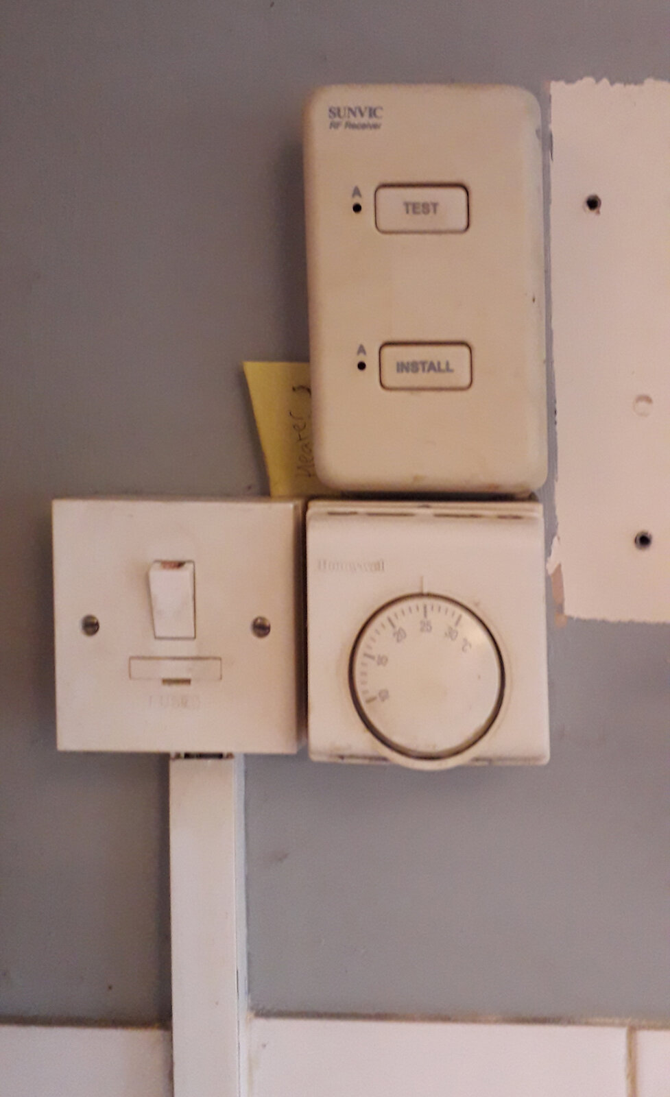

I wonder is this

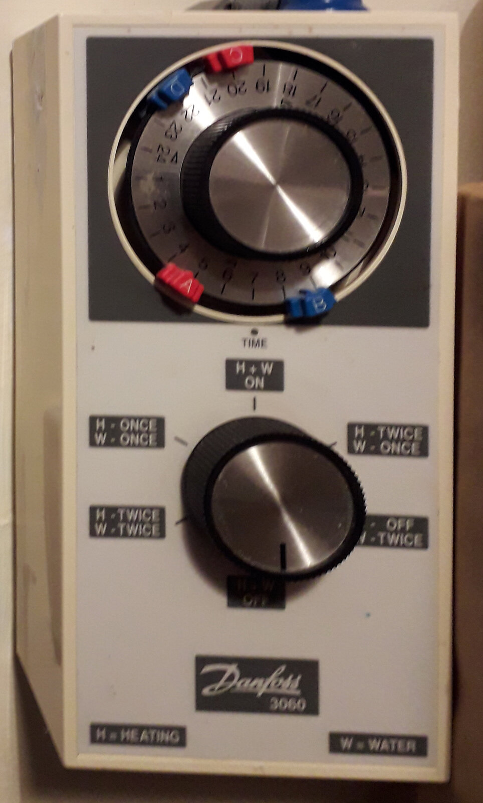

a wireless transmitter for your domestic hot water (DHW) however you have asked what I have done. To start with the programmer in use Danfoss3060programmer.jpg was useless it turned out the triple and earth main house to flat with boiler in it, only had two connected cores. So there was no way to get both CH and DHW independently timed without some bus or wireless connection, I used Nest Gen 3 as it has a bus connection so not relying on wireless. Although it can also use wireless and as user no idea which it is using.
I found a wireless thermostat base 20190619_063642.jpg however no sender why some one would take the sender no idea. The thermostat shown was for the flat not the main house, and we had two pumps, clearly some one thought by selecting which pump is used one could select if house or flat heated, that was not the case, if one pump selected it circulated in reverse direction through the other one.
So I had two motorised valves fitted, and had to set about working out how to wire. I actually made a mistake, and missed out a relay, so house can run without flat getting warm, but not the reverse. However never use flat without house being in use, so never corrected.
With pumps off and valves closed I will get DHW, so Nest can run the boiler only, and unlike the original programmer it can run for ½ hour, minimum with old controller was 1½ hours, it had an option of once or twice a day, where Nest allowed me to have it just 4 times a week, so Mon, Wed, Fri, and Sun and the boiler would actually run for 20 minutes as it would then be too hot on the return as the hot coil not really very efficient at transferring heat. This would give us hot water in the summer, and one hoped it would be hot enough on Mon to stop legionnaires, but never measured the temperature.
In the main this worked, some times would run for extra ½ hour but good enough for warm water at taps. Now I have an iboost+ and solar panels so the DHW is heated with solar in the summer, not as good as hoped as the electric only heats top of tank, so does not really stay hot long enough, I need a longer immersion heater so it heats up more DHW when the sun shines. But only fitted in Sept so not used much before CH was required and I have no way to stop the CH heating the DHW. But the solar only heats the DHW when the battery (3.2 kWh) is full, so does not heat the DHW every day, and the pipe run to the taps means ½ a bowl full of cold water before hot arrives. Had it not been for that, I may have tried to fit some wireless tank thermostat.
By the time my CH switches off, I would think there is enough sun for DHW to be heated by solar. So not doing anything to get the boiler to heat the DHW better.

With my C Plan if the boiler runs then the DHW heats up. It does not need any valve to open, it will heat up DHW.
But with the S Plan that motorised valve needs to open. So in Summer it is the same as C Plan, and using simple time of 4 x ½ hour per week, it will heat the DHW less than max heat, but enough so no cold water in the pipes, and with also having solar and an emersion heater, don't really need it any more.
However in winter likely there will be a problem, as instead of in my case being heated all the time the central heating is running, it would still only heat 4 x ½ hour per week but instead of having full 19 kW going into the water, it will be cooler as also heating the house, plus the water is colder to start with.
Yes one could add relays so when the CH motorised valve opens so does the DHW, but if adding a relay, then may as well use SONOFF and have it connected that way.
