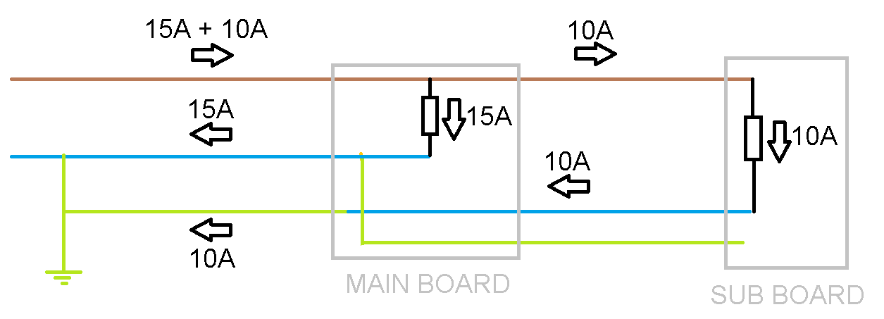

what if neutral and cpc were transposed in one of the non rcd feeds to a sub panel. At the remote point the feed cpc is not connected ( but say is actually neutral from source) and the cpc has become load return ( pseudo neutral?) to source. Load current would balance at the remote Rcd? But at source be flowing in the cpc to DNO earth point?

That would still show as balanced if you test L, N & E. Example:
15A in use across L & N at main board and 10A at sub board but returning via DNO earth
As has been said, that would not result in what you are apparently observing. Indeed, unless you want Mr Kirchoff to start turning in his grave, the results you are apparently seeing must mean that a substantial part of the current in the L must be getting back to the transformer by some route other than the DNO's neutral conductor.
