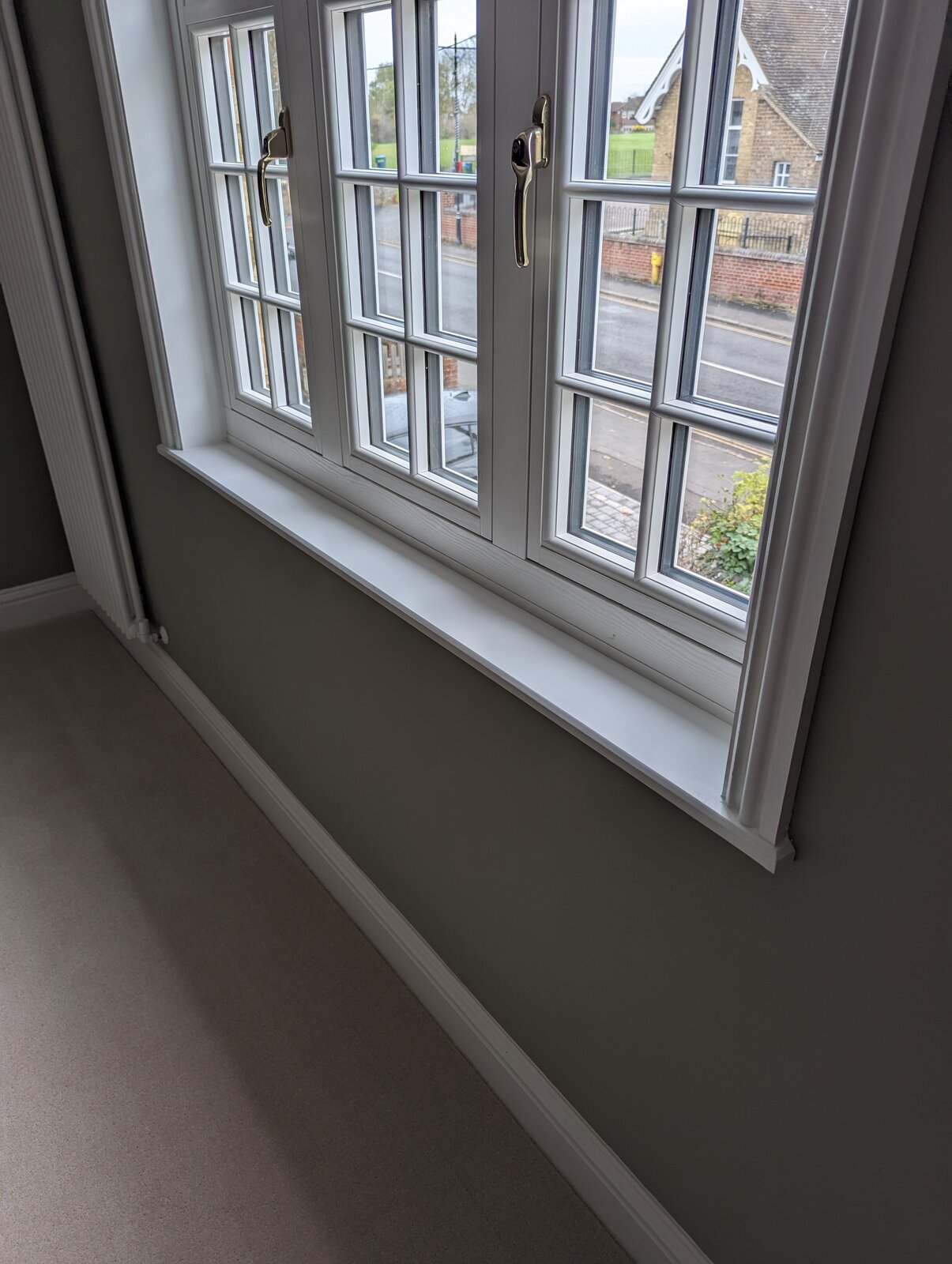

I've done a load of window boards in my house with 25mm MDF, feel free to ask anything.
You can't see it very well, but I did a chamfered edge instead of bullnose to match the original window boards in the house:

Nice job

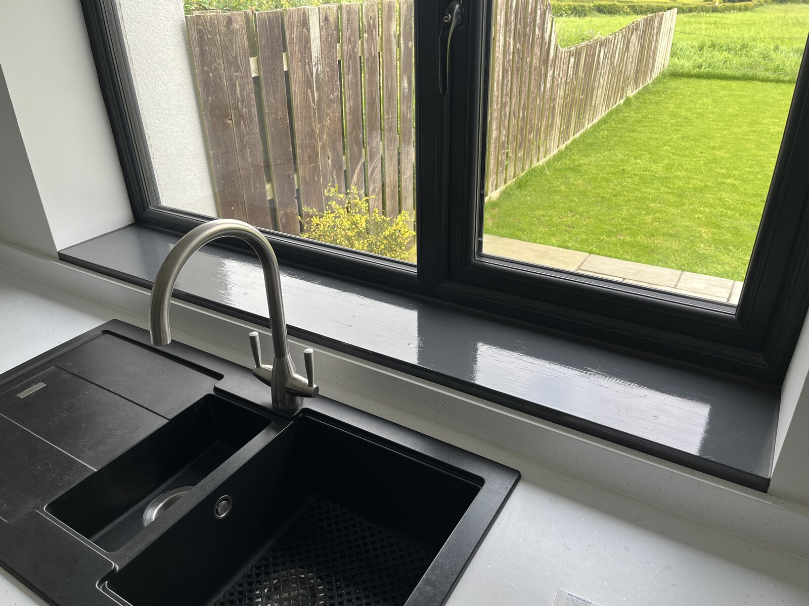

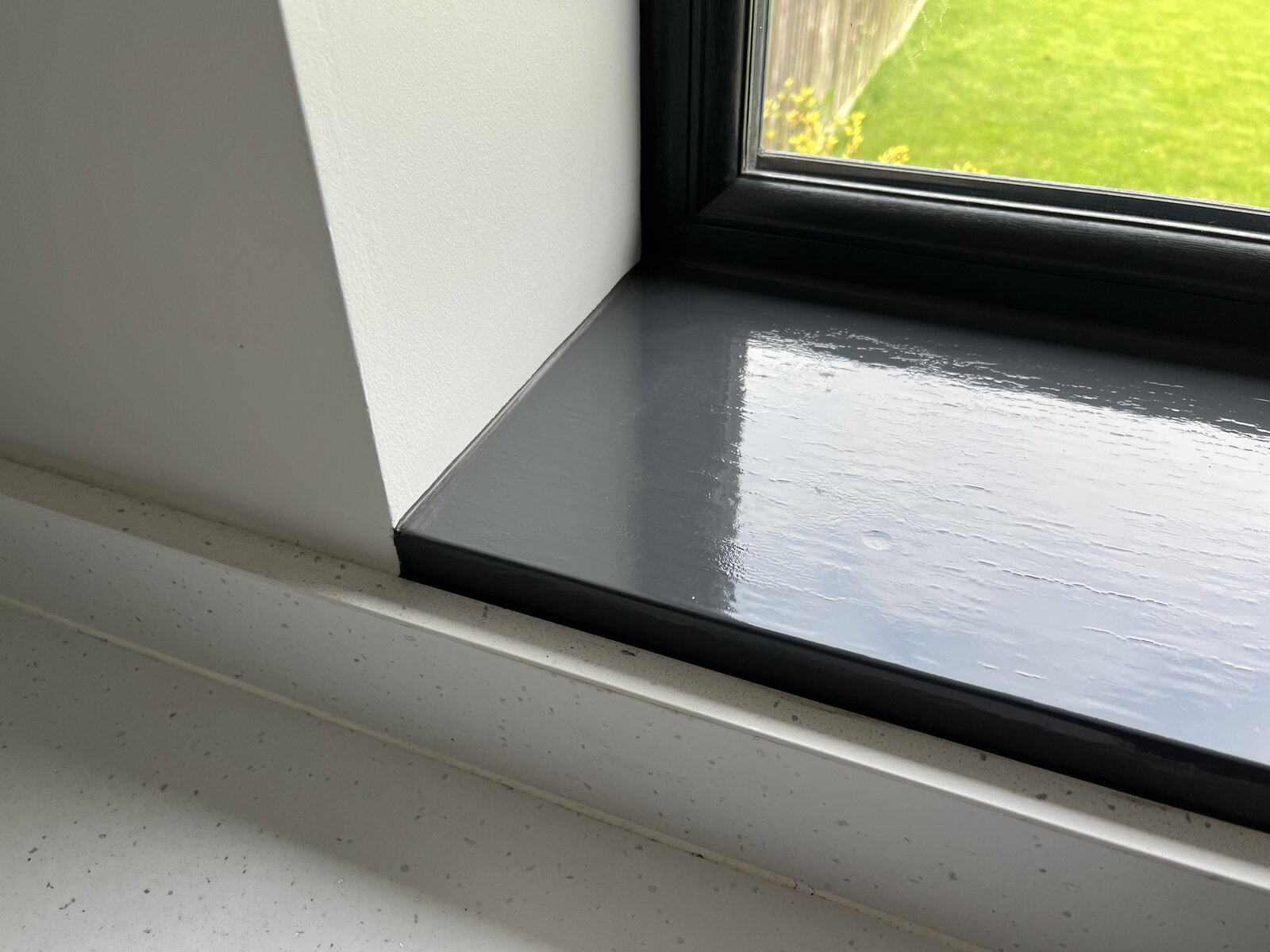

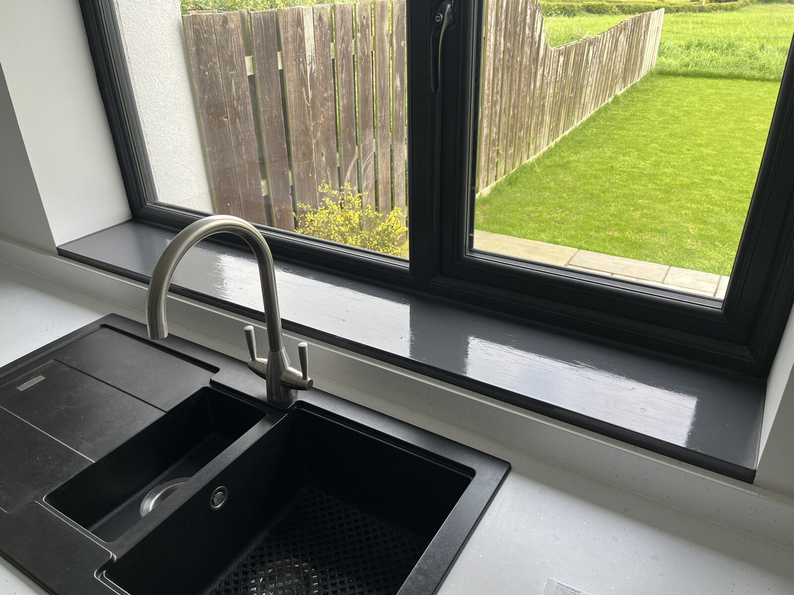

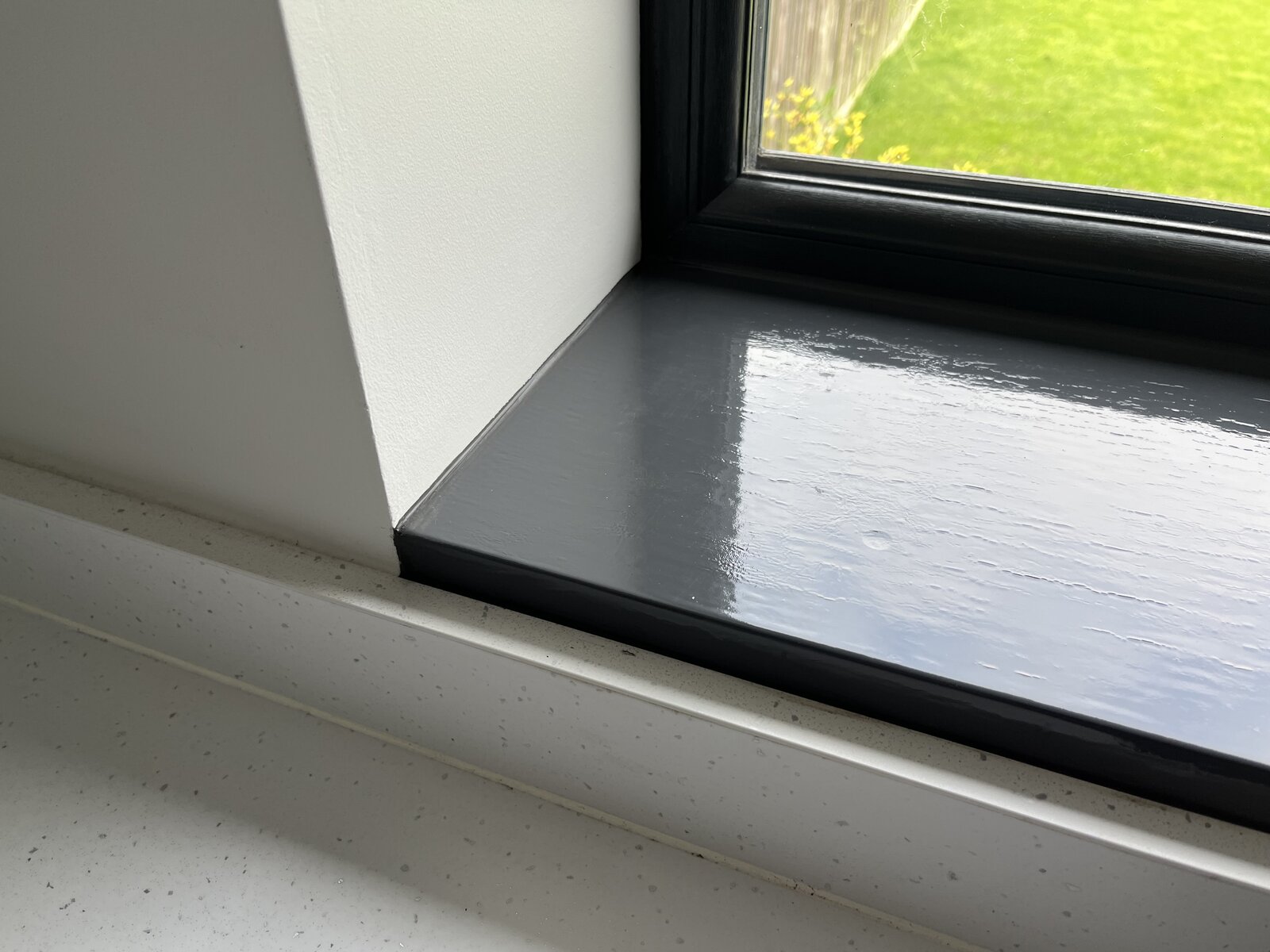

You’ve got that correct. Here’s some pics of the one I did in the kitchen (hard work with a handsaw). The ones I’ve got to do are up to 2.3m, and will be a pain with a handsaw !! And I’ve seen plenty of examples of flush sills online, so it should be ok :unsure: . And all the internal walls are freshly plastered with straight angle bead.

Circular saw will produce and edge like that no problem.
You're much better with a hand saw than I am!
