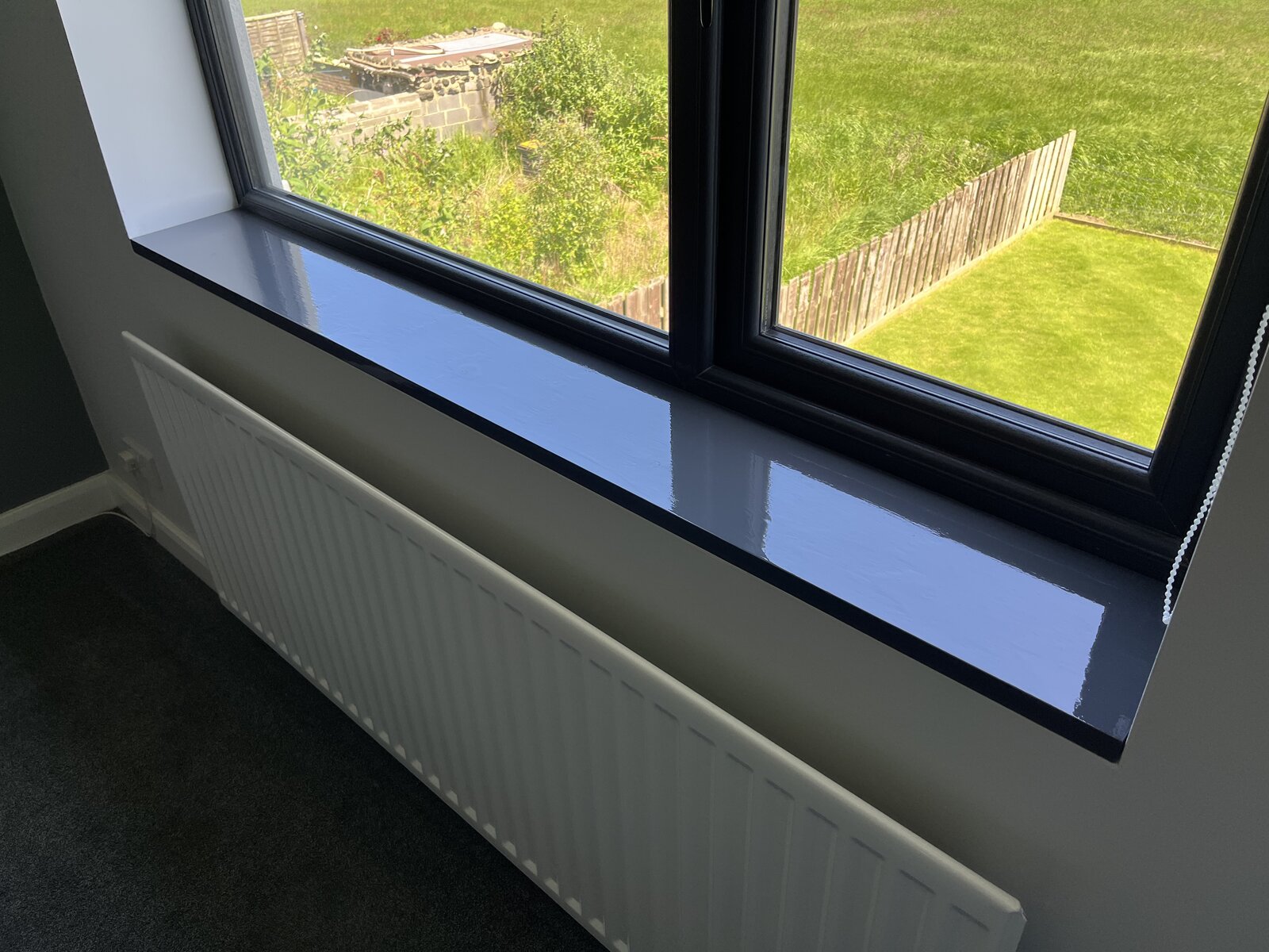

Well….it might not be everyone’s cup of tea, but this is how I like my window sills. No overhang, straight edge, flush with the wall. Looks nice and modern, which is what I was going for :)
Unfortunately, it doesn’t look as good as I hoped, as the paint I was using is very hard to work with…Rust-Oleum, All Surface Paint, Dark Grey. It’s a pain in the ass to work with, leaves ripples and shows slight imperfections like sanded screw holes . Hopefully, a second coat next week will sort that out ;)
