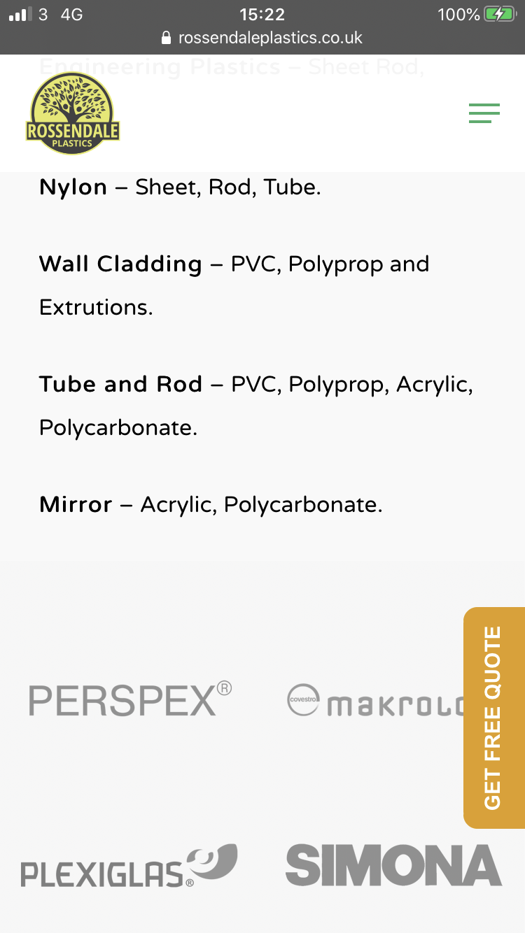

I’m looking for a supplier now but can’t find a local one. Theres a place that make displays from acrylic so I’ve e-mailed them. The others are all online.
Any ideas where I could go in the North West to pick a sheet up?
Amari Plastics in Middleton, Rossendale Plastics in Haslingden. Also many signwriting firms, firms making retail display units, etc carry polycarbonate and acrylic in stock (Perspex is actually a brand name, like Hoover). You could also ring the people who make Perspex and Lucite (Perspex International? - was once ICI) in Darwen to find out who distributes near you
That’s great thanks. Rossendale is very close to me and they do it so I’ve messaged them too (y)
Rossendale Plastics have got back to me already, £102 with the VAT for an 8x4 sheet, that will give me more than what I need so can have a practice on the spare bit.
