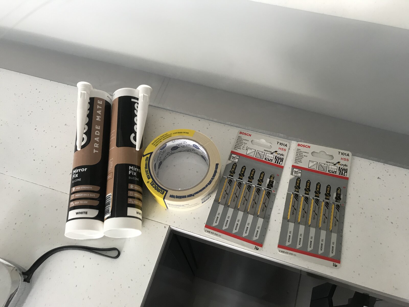

Mirror adhesive (as opposed to grab adhesive which won't always hold well) - it holds the smooth surface better. I've used it on polycarbonate, acrylic and stainless steel (as well as glass) in shops, bars and restaurants for years. Make sure you get a fresh tube, not one which is near its' sell by date (stale or old product doesn't work too well)

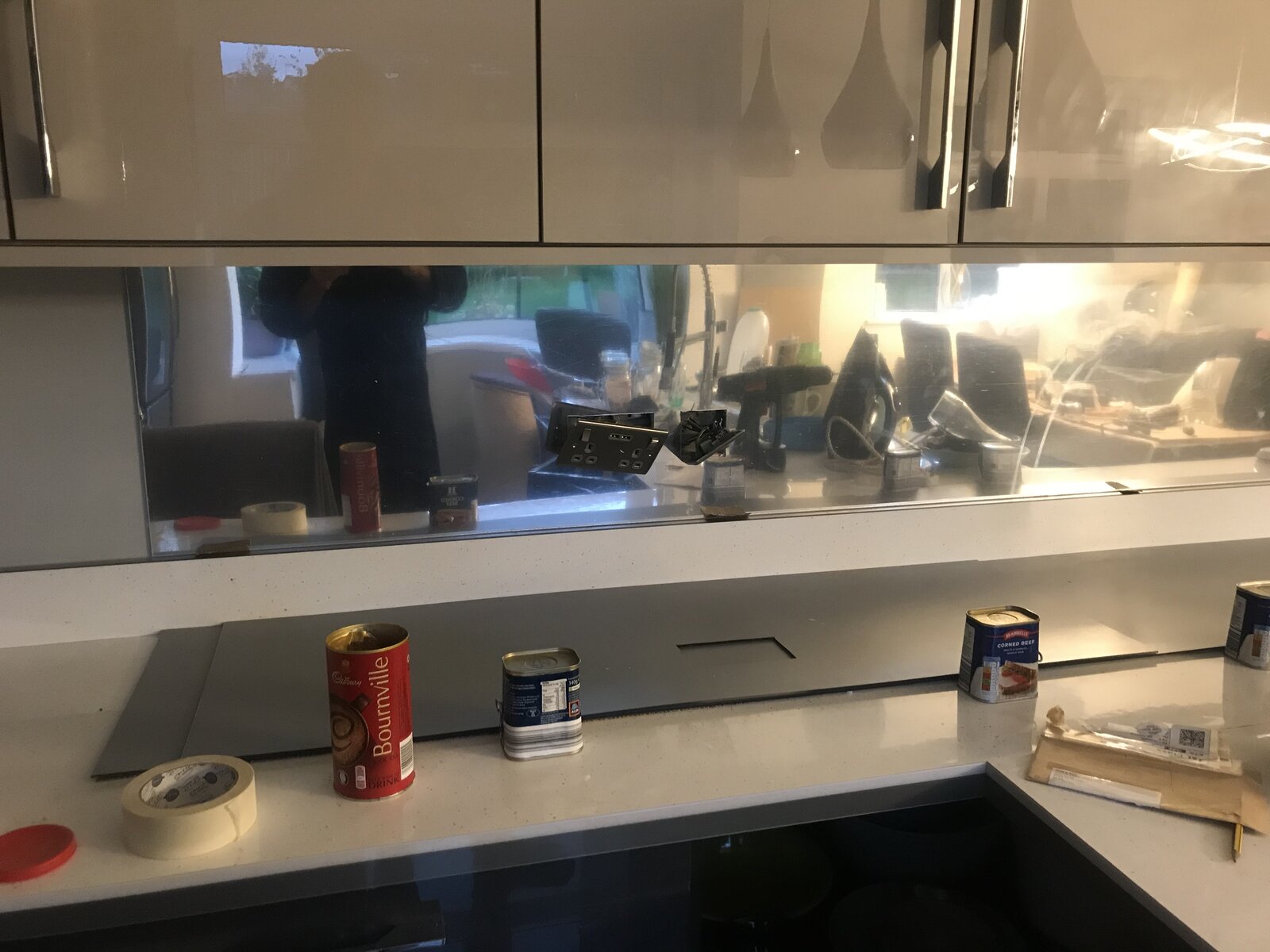

When I cut shall I have mirrored side up or down?
I cut it mirror side facing down and it’s very neat. No problems with the jigsaw blades melting the perspex.

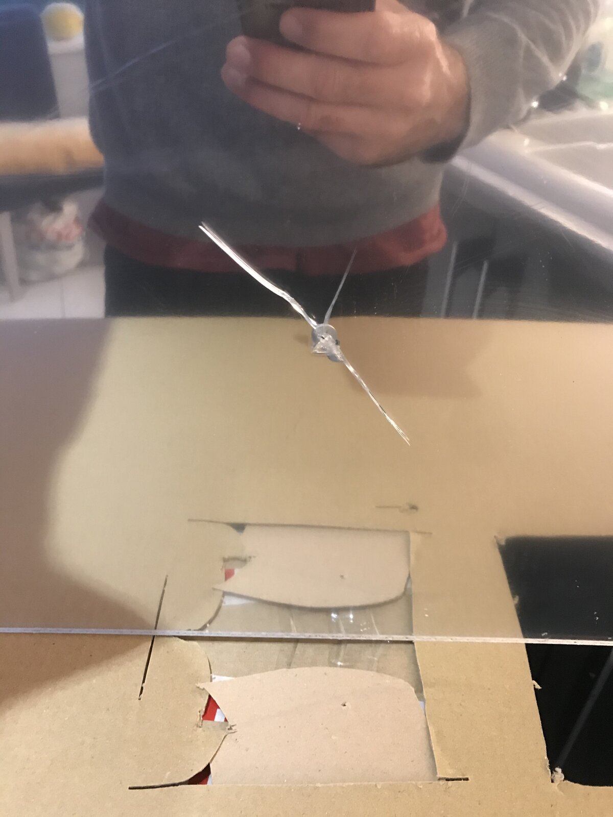

What type of drill bit are you using? Harder plastics tend to benefit from a narrower drill point angle than you get for steel drilling (e.g standard jobber bits). Brad point centre bits (as used for wood working) can be used as well, albeit at low speed
On the first one 1 used a 4mm hss then an 8mm.
The one that cracked I went straight in with the 8mm.

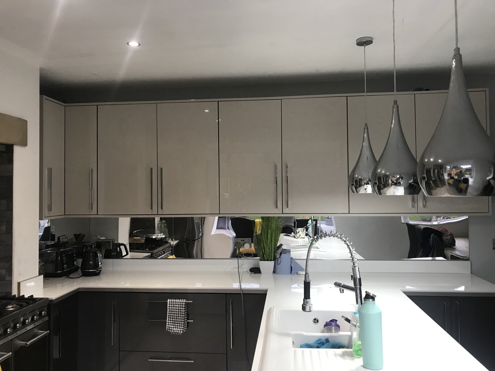

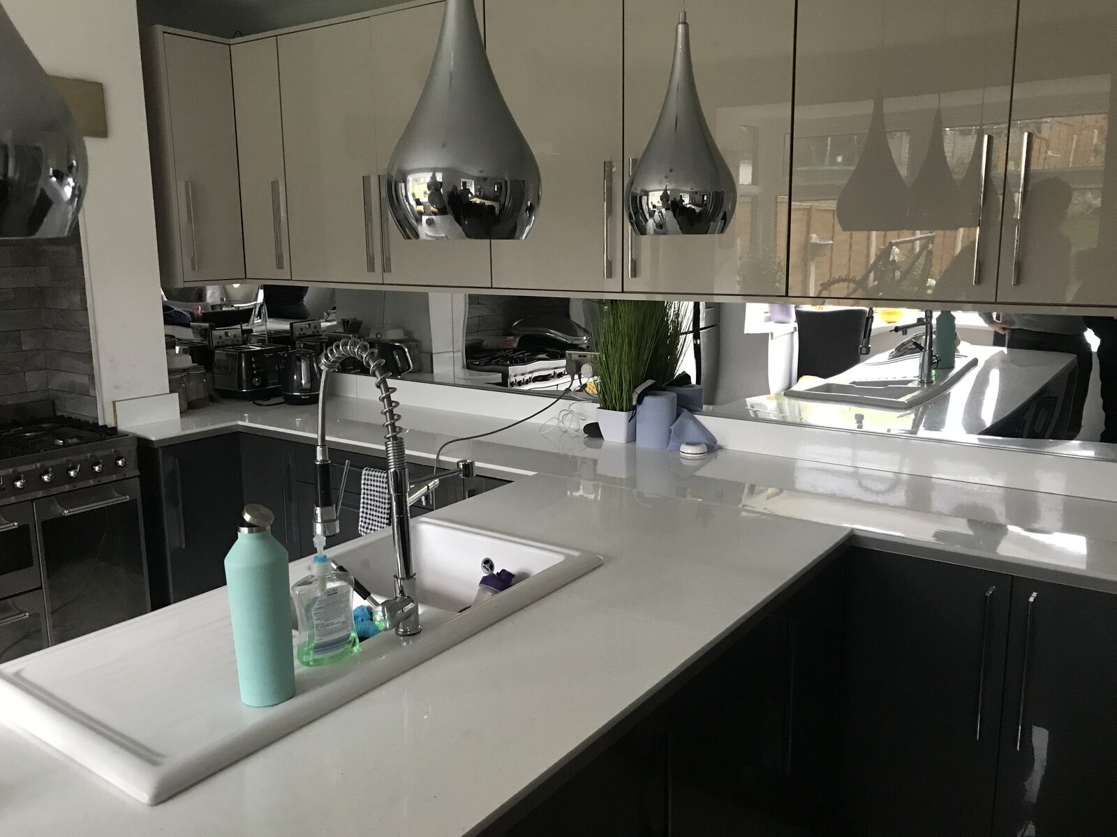

I’ve got 1 on the wall now, it looks OK but I think the wall must not have been perfectly straight so the mirror looks a bit like a commercial kitchen with polished steel. It’s still got its protective coating on for the minute too
Its looking well, Ian - your chosen material isn’t the easiest to work with.
Take care regarding cleaning and scratches...acrylic is pretty soft.
John :)
Yes, nice job.(y) As Burnerman says acrylic is easily scratched. I'd suggest getting one of the cleaners they use in commercial kitchens to keep whiterock walling clean.
Well, on the scale of all my DIY jobs I’d say this one was pretty disappointing. It’s a bit like the bendy mirrors at the circus :LOL::LOL:
I think it looks crap but Amanda and the kids likes it so it can stay for now
Thanks very much for the help and advice and it anyone needs a T101a I have 8 unused here (y)
