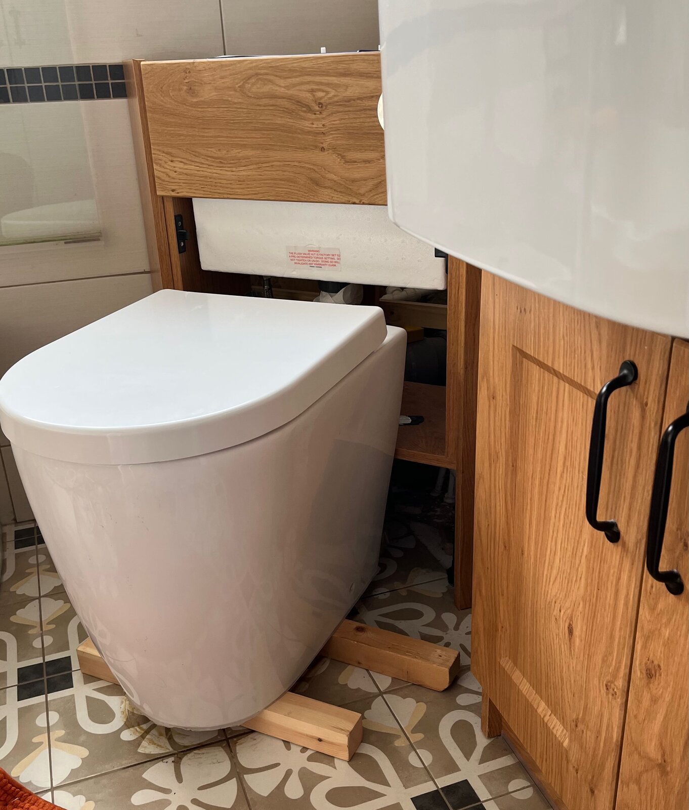

I'm hoping to get a piece of oak, to make into a plinth for a toilet to stand on.
the thickness will be around 44mm
but the OH wants the timber to follow the profile from top - seat to floor - which has a slight taper - gors from 360mm at the seat down to 255mm at the floor part of toilet and so she would like that profile to continue
heres an example of the toilet i have - not sure on the exact one but looks the same
ours came from a local bathroom store, as you can see it tapers from the top and curved around the length
I have a Jigsaw - Dewalt cordless DEWALT DCS331N, i also have an old Bosch corded jigsaw
I dont have a bandsaw

sorry - yes , the floor had been removed and tiled and originally the toilet was on a small plinth plywood - so i said will the toilet still work - and was told yes
BUT
because the floor is lower - to alighn with the rest of the house hallway and then plinth removed - the height difference is probably around the 45cm mark ish
so since replacement 2019 its been a problem
Looking i see that the waste is going uphill , and i measured how much i could modify and move the cistern up - which is 45mm
so now the toilet needs to be OFF the floor by 45mm , now the waste has a very slight fall - and lots of testing today with the toilet on a couple of pieces of wood - its working brilliantly
i have taken a photo to show how it is right now
Cistern raised - so the flush pipe still aligns
The waste has a small portion of flexible going into a horizontal stiff plastic into a stack - and now the toilet has been lifted up , it nolonger is going uphill from the toilet outlet up to the solid pipe work
And as i say its NOW Working - been trying all day , and no paper left in basin
hope that helps what i'm trying to do

Use a proper toilet plinth will look much better.
thanks for that - i looked at those a while ago , not sure it will look any good with the footprint of my toilet , i would have to look to see if i can get another 5mm as i have the cistern touching the worktop now
but thanks
