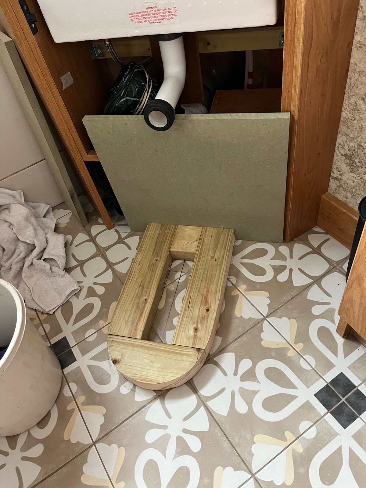

cutting oak plinth
I'd probably go a little bit slower than max - just run it and see how well it cuts and adjust the speed down a wee bit if it feels unbalanced (vibration) or you get any signs of scorching.
thanks - i have some test pieces i can play with
frame all made dowel and glued up - just in clamps now - will see what i get tomorrow - grandchildren arriving tonight for a few days - so not sure how far i will get now
do you mean as a test crew for your plinth :D

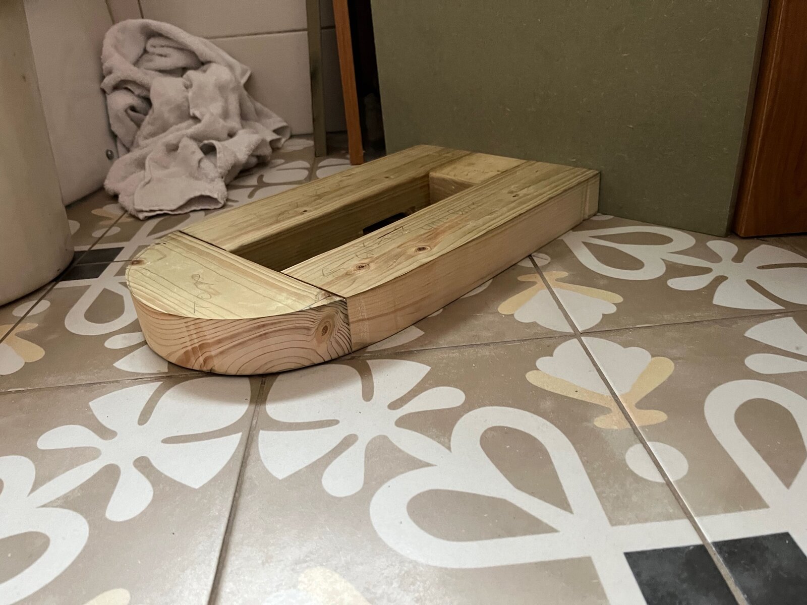

plinth now cut - and just needs rubbing down, will use some PVA to seal - probably 1:1 , and then some sort of paint the other half wants to use and covers anything apparently, she has some antherite which matches the tiles - not going to argue .....
WIP
but thought i would post
Glue gun worked really well to take the 6mm plywood
Router bit was excellent - very easy to do and cut - cut most of the access off with a circular saw
Will post again when its all finished
But a big thankyou JobAndKnock for all the advice and support - gave me the confidence to get on with it
Personally, I think you'd be better off with a couple if coats of oil-based primer. PVA has its uses, but I've always been wary of using it to seal anything at floor level where it is more likely to get wet and retain moisture, although someone like @opps might be better placed to advise (and it might give him a second opportunity to tell me I'm... wrong ;) ). I'd also pay attention to the top and bottom surfaces - the more protection the better.

BLO (boiled linseed oil) also works, if you have any. After all, it is basically what oil-based paints were originally formulated with in "ye olden tymes" (or a couple of years before "I were a lad", so a long time before "I were in me prime")
Yep have loads of that - i replaced all the thresholds in the hall , and double coated those - so have at least 3/4-1/2 a tin left over
brilliant - thats easy
is that better than PVA then ?
I think so, yes. Sand off with fine paper between coats and after the last coat
I have put it on the tops and bottoms if exterior fire doors in the past and it makes quite a difference to durability. Useful to have some in the van

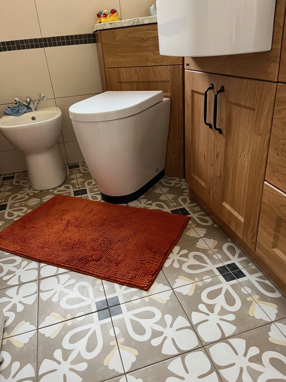

all finished and no leaks - now works properly , and toilet paper goes down on the first flush
Thanks very much for all the help , advice and support, much appreciated
@JobAndKnock - Thanks so much for staying with the thread throughout - helped tremendously - gave me confidence and tools to do the job - with great explanations
