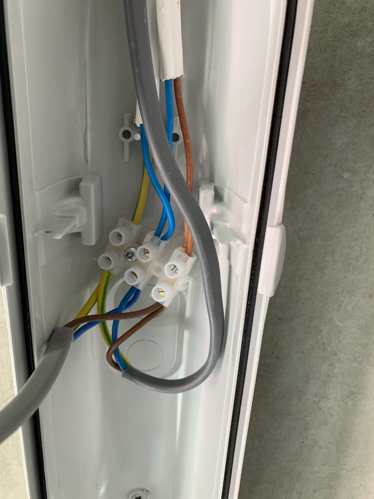

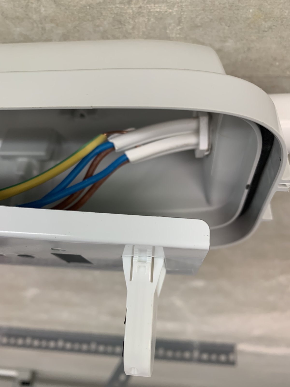

Having opened the first light to take a feed from it, I’ve discovered that it is already feeding the existing second light. See pic. Can I still take a feed for a third light?
And can I then take feed from the existing second light to the fourth?
Electrically speaking, yes - but you need to be sure that there is enough space for all the cables and, more importantly, that you can comfortably and satisfactorily get three conductors into each of the terminals in the connector.
You can take the feed for the fourth from either the second or the (new) third, whichever is more convenient.

Thank you John. Yes you’re right, there’s not enough room in the lamp’s terminals for there cables. I’ll have to add a choc bloc in the lamp for the three cables then add a short length of cable to lamps terminals.
Not ideal but I can’t thinkbof anything else?
Thank you John. Yes you’re right, there’s not enough room in the lamp’s terminals for there cables. I’ll have to add a choc bloc in the lamp for the three cables then add a short length of cable to lamps terminals. Not ideal but I can’t thinkbof anything else?
Well, I can't tell without looking, but a 'nicer' solution (avoiding an additional choc block), if it were possible, would be to replace the unit's existing 'terminal block' (which itself may well just be some type of choc block) with one large enough to take all the conductors.
However, would it not be convenient to take your third light from the second, and the fourth from the third (which should avoid 'terminal capacity' issues)?

Hi John, the trouble with that is that I then end up with a maze of conduit on the ceiling.
This is what I’ve done - see pic. The two white cables are the free in and the feed for the second lamp. I’ve added the two grey cables - one for the new third light.
Then the other grey goes to the terminals in the lamp. I’m not at risk of overloading something by having just one cable carrying all the load to the terminals am I?

This is what I’ve done - see pic. The two white cables are the free in and the feed for the second lamp. I’ve added the two grey cables - one for the new third light. Then the other grey goes to the terminals in the lamp. I’m not at risk of overloading something by having just one cable carrying all the load to the terminals am I?
That looks fine. Nothing will get overloaded.
Some purist may comment on the very small bit of bare copper visible for one of the conductors in the top-right terminal of the chock block :)
