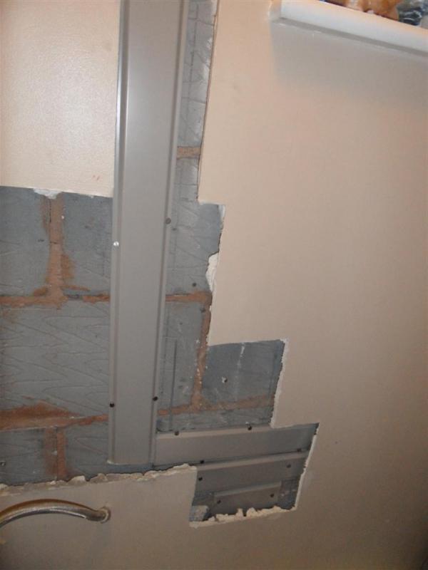

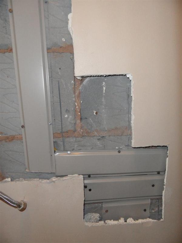

The engineers came at 1400 hrs and found the tails were going diagonally and not straight up the wall! They replaced the tails and chased them in, the specified 35mm before covering with triple layers of steel trunking - see pictures below. The wall now needs to be completely reboarded and the ceiling repaired too, but hopefully they will be sending someone to sort this out after confirmation tomorrow. Only trouble is I still won't be able to hang the toilet roll holder on that wall due to all the steel trunking but at least it now meets the regs and is safe!

35 mm into a horizontal breeze block wall ?
Looks like that "protective" metal is not earthed. Should it be earthed ? I suppose it will be impossible to drill through it by accident and then get a screw in to connect the live tail to the sheet of metal.....
Why are you hmming so much?
Thats not breeze block, it's thermal aircon block which is like butter compared. I was told that if chased in and capped then there is no prescribed safe zone under the current regs and that this would be fine.
I also asked about running in the cavity but that's not allowed apparently.
I would have preferred running the other side of the window but they didn't want to create more mess than already there and beggars can't be choosers.
Isn't trunking the same as capping? It's definitely triple layers of capping.
Feel like my parade is being rained on now.... is it really not ok?
The capping doesn't really count for anything and that installation is now only just marginally better than it was before.
It seems to be a bizarre and pointless remedy.
Capping:
Trunking:
Note how one is as thin as a piece of paper and the other is thick enough to shrug off a casual drilling.
ahh I can see the difference now. Damn, this is going to be awkward as I am not a sparky and can't tell them their job. Any tips on stuff I can put to them? Am I supposed to get a certificate of safety for the job?
