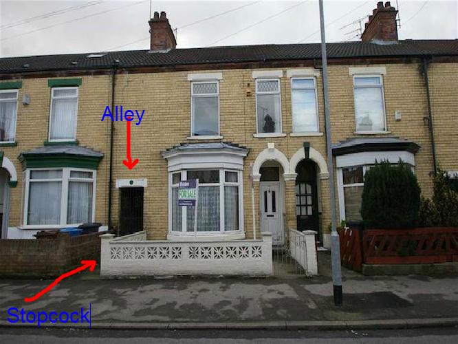

First external stop cock is at the entry point to the alley and turns off ours and our neighbours water supply. The second is at the back of the property just after the alley (This turns just our house off and the neighbour has one in their garden in the same place).
Why do you suppose that you share a common water supply with the neighbour across the alleyway?
The stopcock at the entry point to the alleyway turns off both properties. And pipes as far as we are aware continue under the concrete in the alley.
The picture below shows the alley in question that leads to our back gardens and the position of the first stopcock. (This was before we bought the house, hence the for sale sign)
