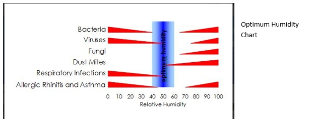

Too dry atmospheres also cause problems.

My utility is no cavity, double brick, so is fairly cold. If the dehumidifier is not turned on, then I can guarantee moisture collecting on the internal plastered walls of the room.
