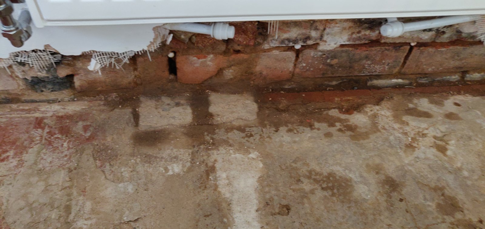

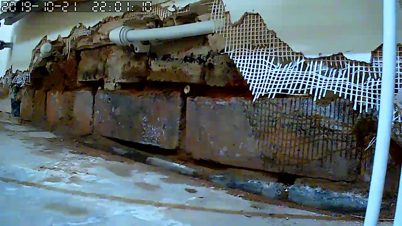

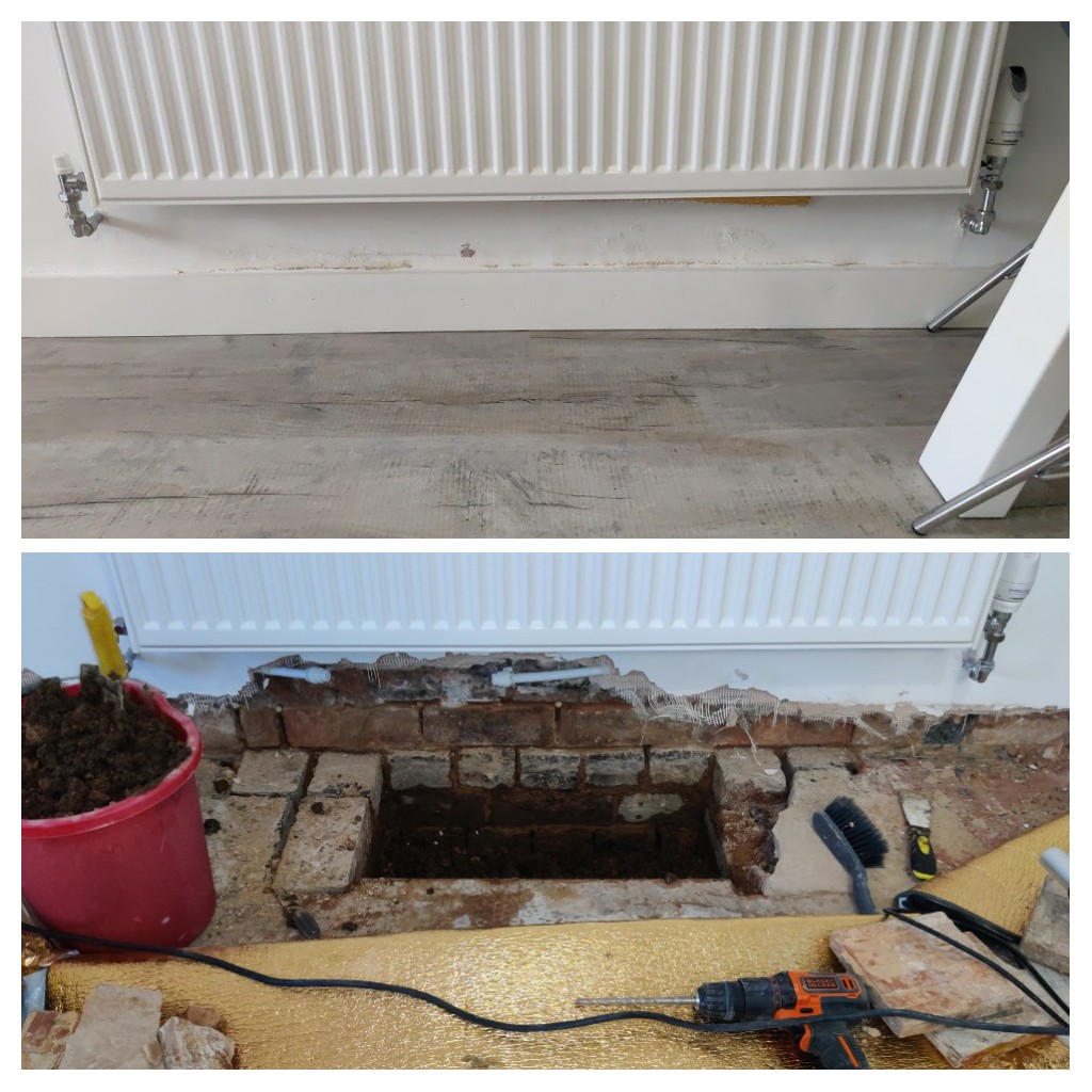

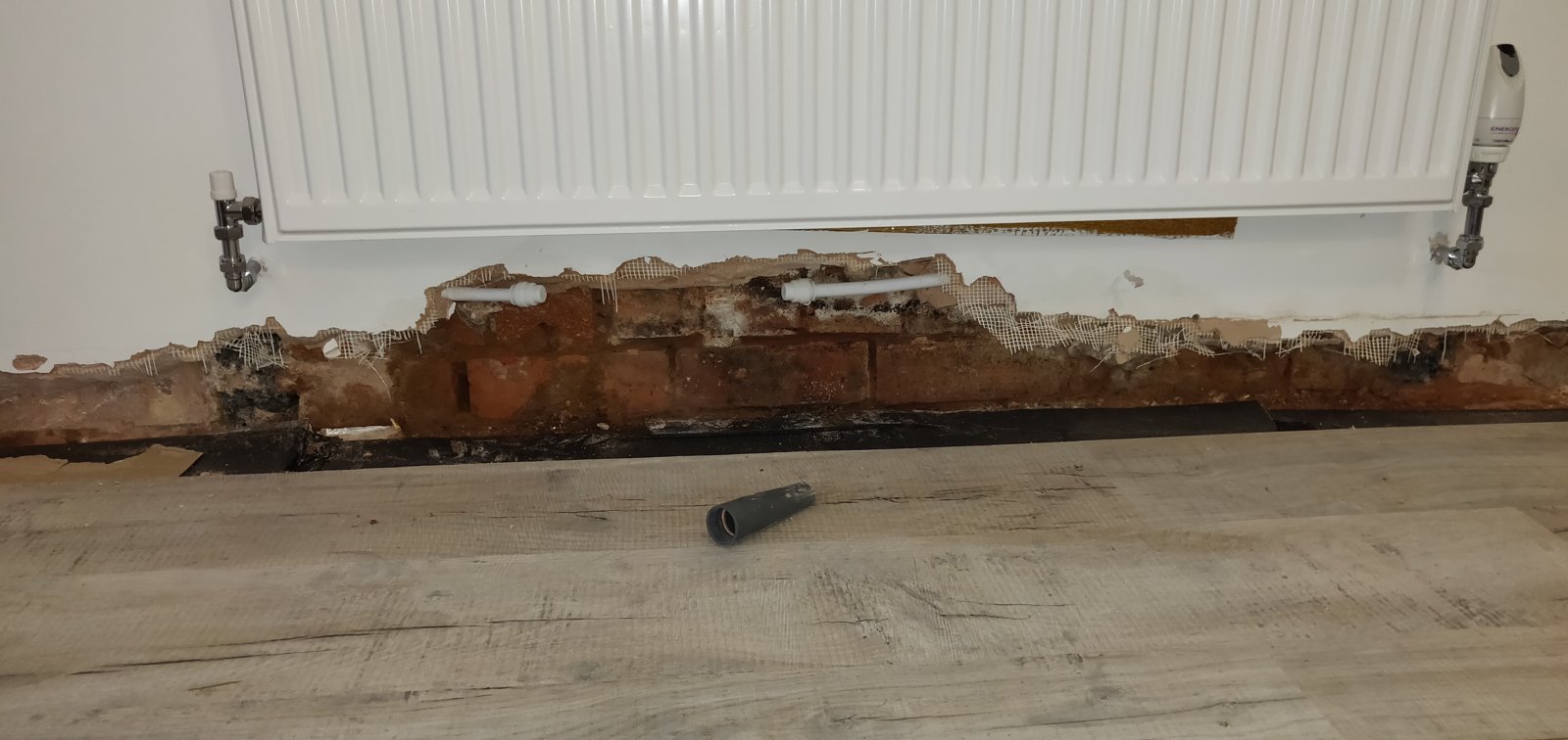

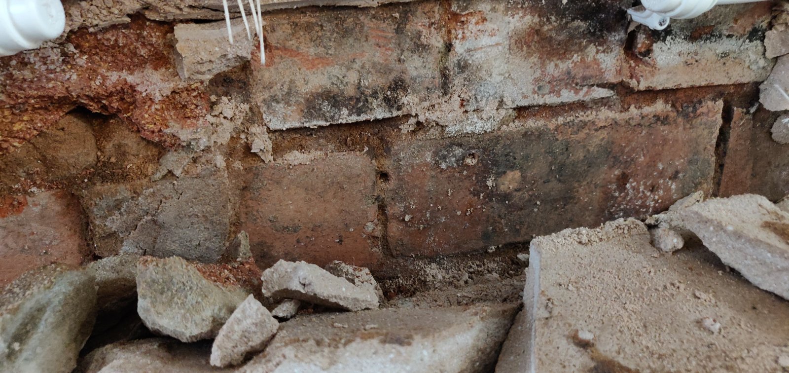

Hi there all, I bought a semi detached 1930s house about 1 y and a half ago. In the living r room there used to be a fireplace breast on the party wall which was removed years ago. The first floor breast and stack are still there. When i was buying the house there was a damp in the area and The seller capped the chimney pot and fixed the flashing. So we let it dry a few months and then replastered.

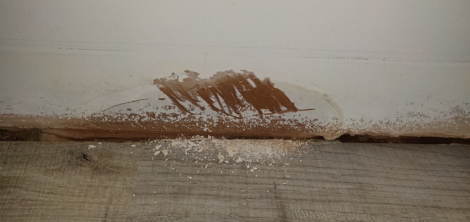

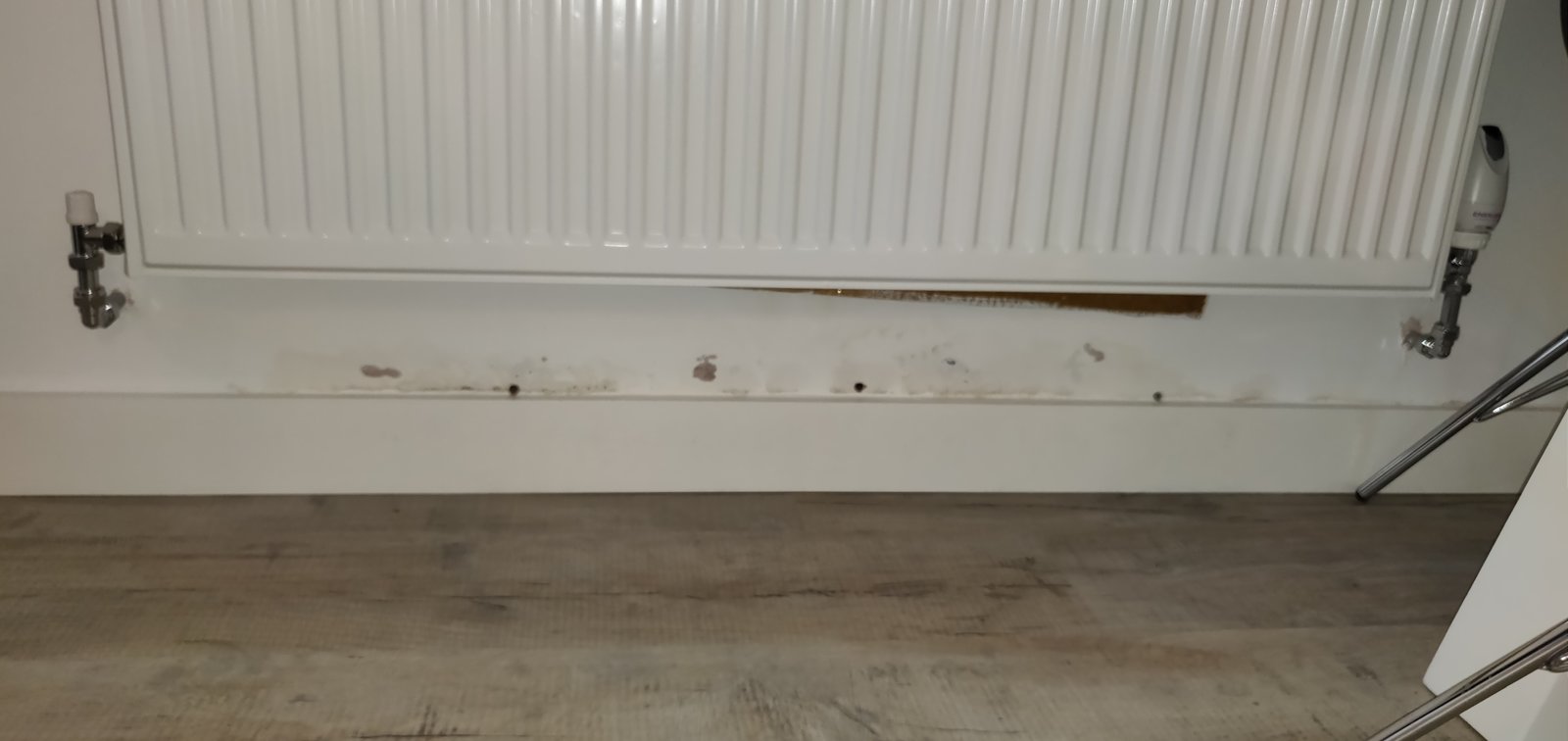

Last month i got some stains just above the level of the skirting board. Trades people seem to disagree on the root cause. Also the quotations are very expensive.
Do you have any comments? I'll share some photos. There are some radiator pipes which I damaged whilst investing the damp area. I'm certain the pipes were not leaking. Also there was damp in on the left of those pipes lurking behind the skirting board and that cannot be linked with them.
Also one question, how thick is a party wall meant to be? I started adding dryrod to create a moisture barrier so better not feel through to the neighbours.
I'll have someone so some work at the chimney. Not convinced it's the chimney but some tlc would not harm?

You have no chimney breast but have neighbours retained theirs,? they could have a damp problem which only shows on your side , have a chat with them .
when you took the skirting off was the back of the skirting rotten? what about the wood flooring after you lifted it - was it rotten?
are there similar stains anywhere else on the walls - in the room or on the walls of other rooms?
where do the pipes come from and where do they go?

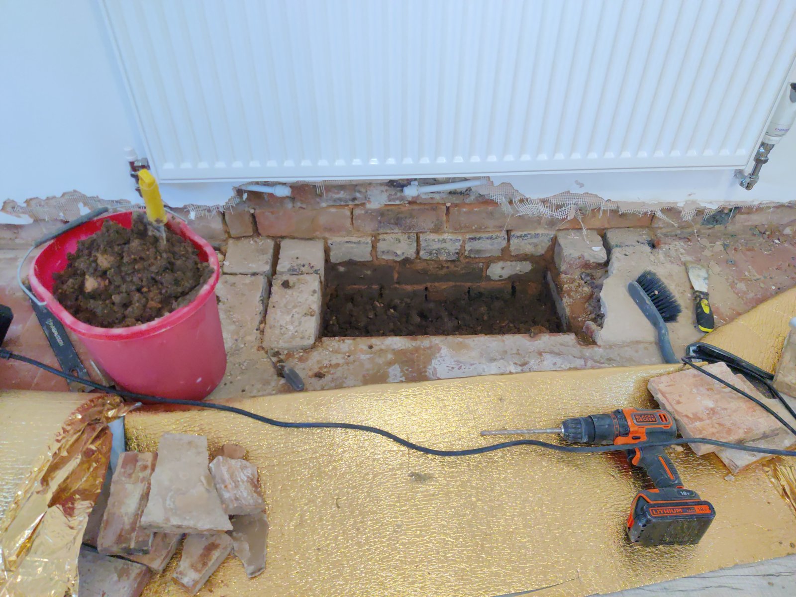

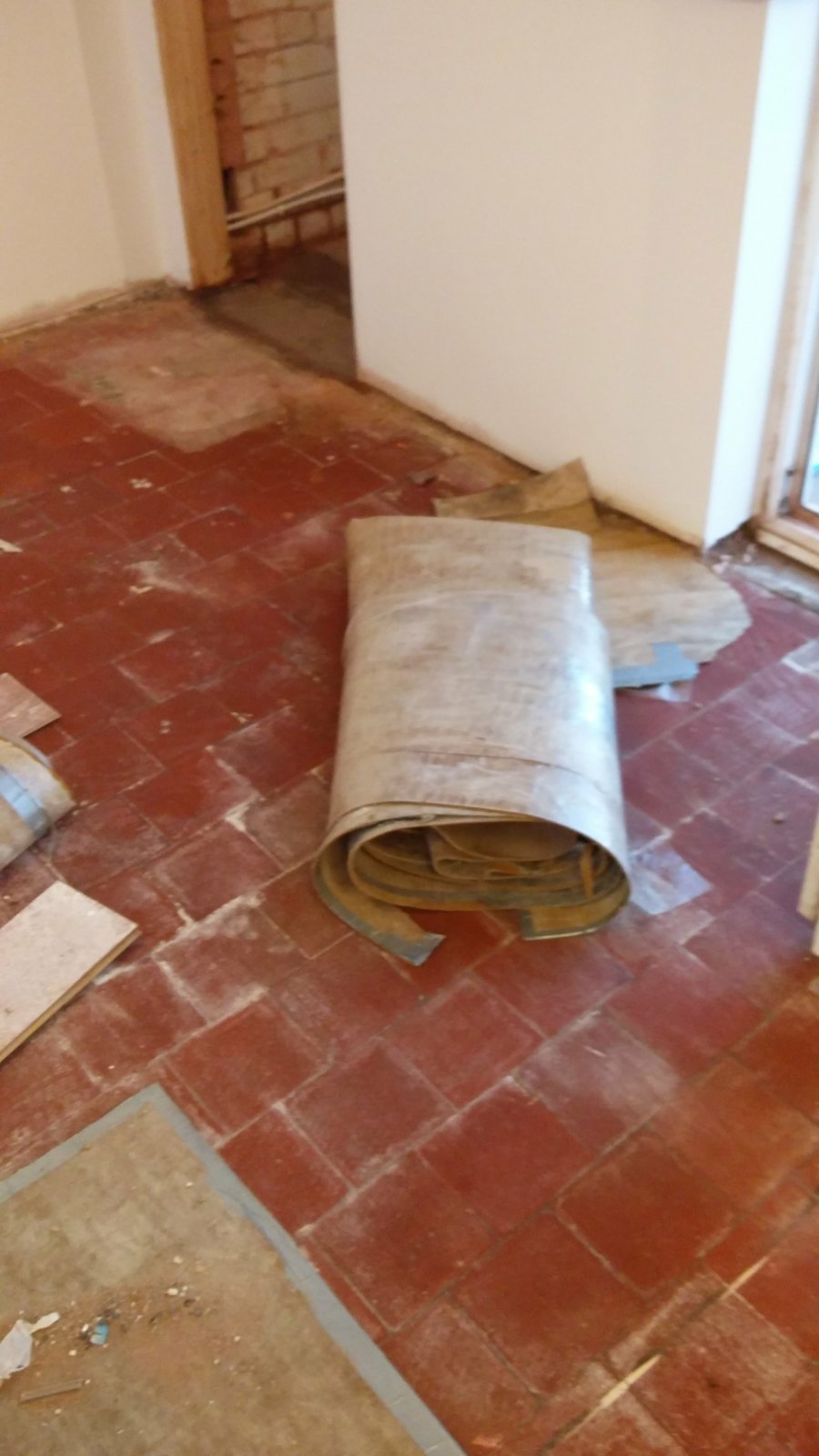

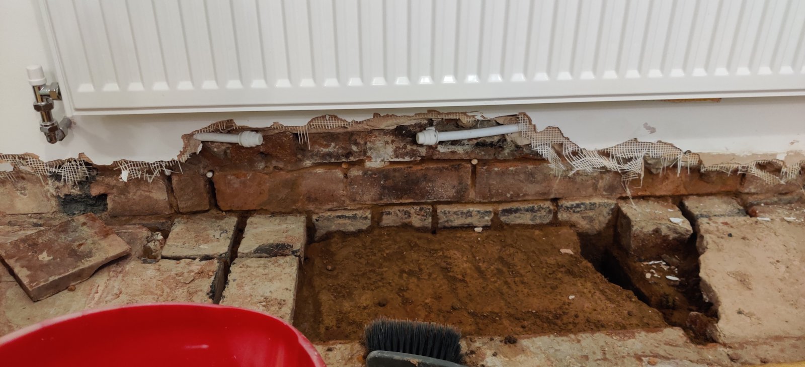

Hi there guys, thanks for the replies. I have continued my investigation. Removed more plaster and started digging too. The pipes are definitely not the source of this. They are radiator pipes and they are not leaking what guaranteed. i found wet clay soil right underneath the tiles. I think all this humidity was coming from the earth and then through bridges over any damp proof layer.
Yes there was a around smell of rot.
How should i fill the hole i made?

what you show is the old hearth - it will have to be excavated and made free from rising damp.
crack out the concrete/mortar and lift all the tiles up to the edge of the hearth area. then post new pics.

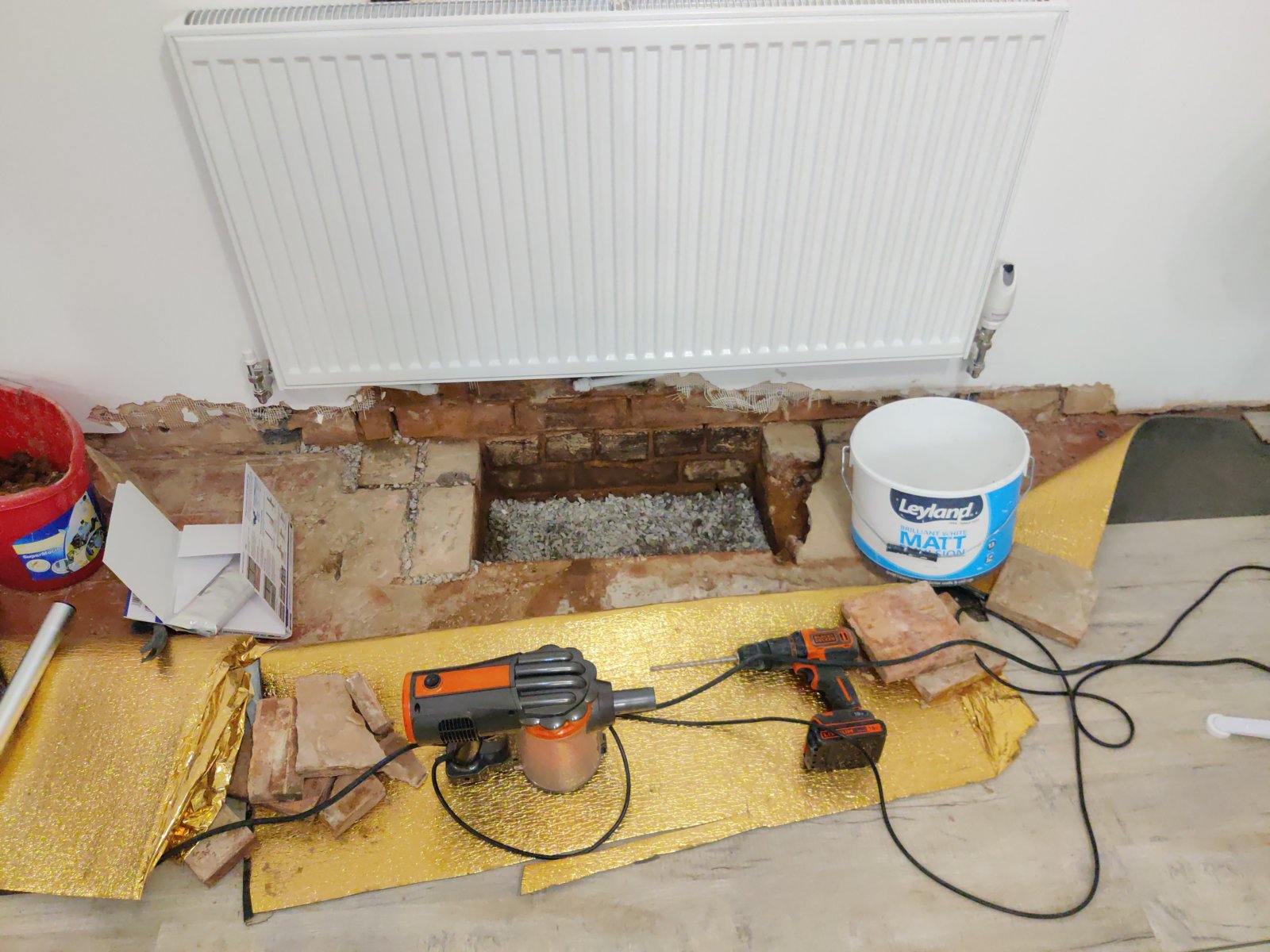

Do you think i should continue excavating? I've gone two and a half bricks down. Also I'd like to avoid removing more laminate to cover a wider area. An i making a mistake?
It already started to dry out. My plan is to put a thin layer of gravel, then a vapour barrier and then fill it with more gravel to the floor level.
I'll also inject dryrods (already put some) to create a new barrier for any further rising damp.
Is the party wall single or two bricks thick? As I would rather not drill all the way to my neighbors living room.

Ref. your post #8:
stop with the injections and gravel.

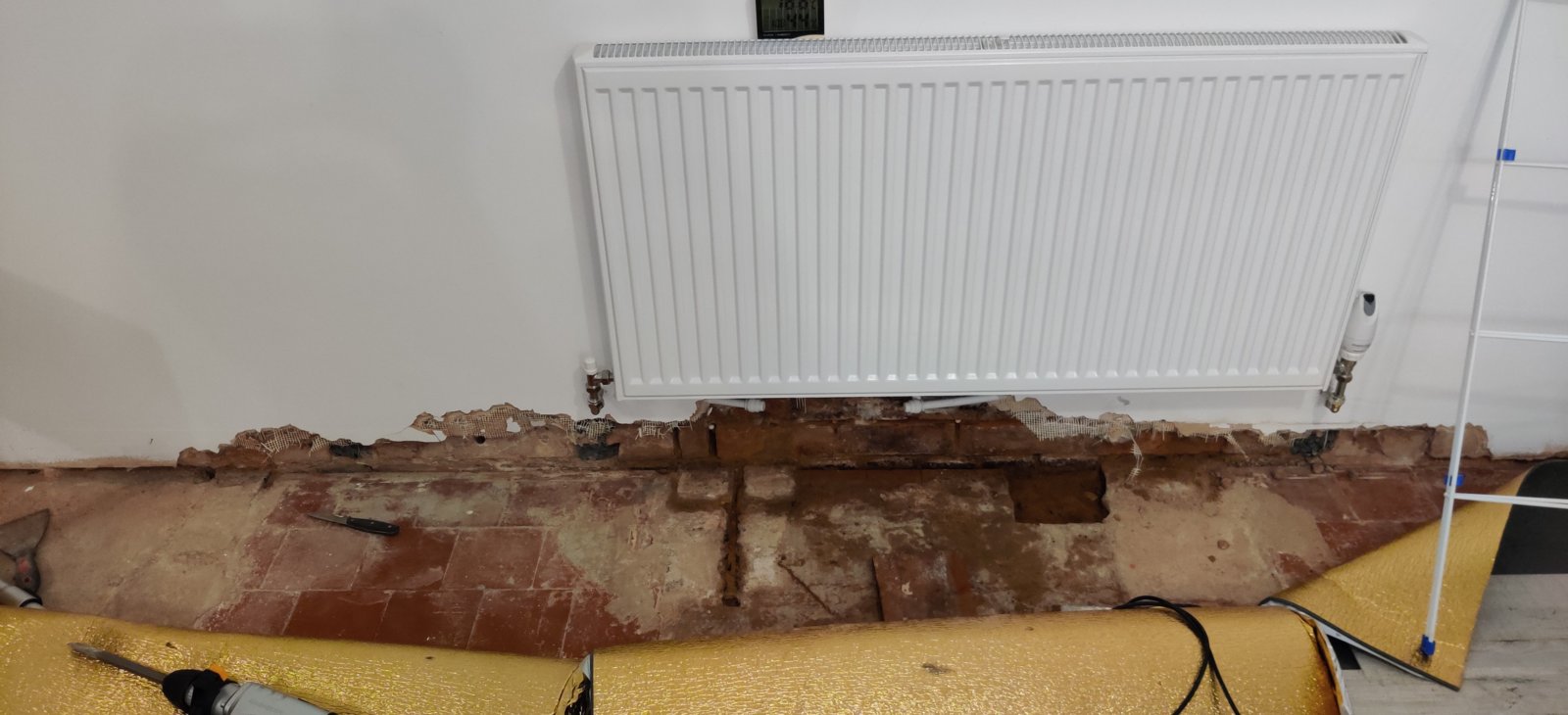

i'm presuming you have a suspended floor?
you will have to excavate the whole area of the hearth to a depth of about 300mm
and expose the surrounding fender wall, and any joist trimming (the wood could be rotten).
its sometimes necessary to remove some of any surrounding boards/laminate to expose the full area of hearth and trimming.
party walls run from 1/2 a brick to a cavity wall - work on 1/2 a brick.

That's the floor. Tiles on some hard concrete or mortar or similar?
is the half around the hearth suspended?
can you pic the whole floor and "paint a line" showing solid and suspended halves?
