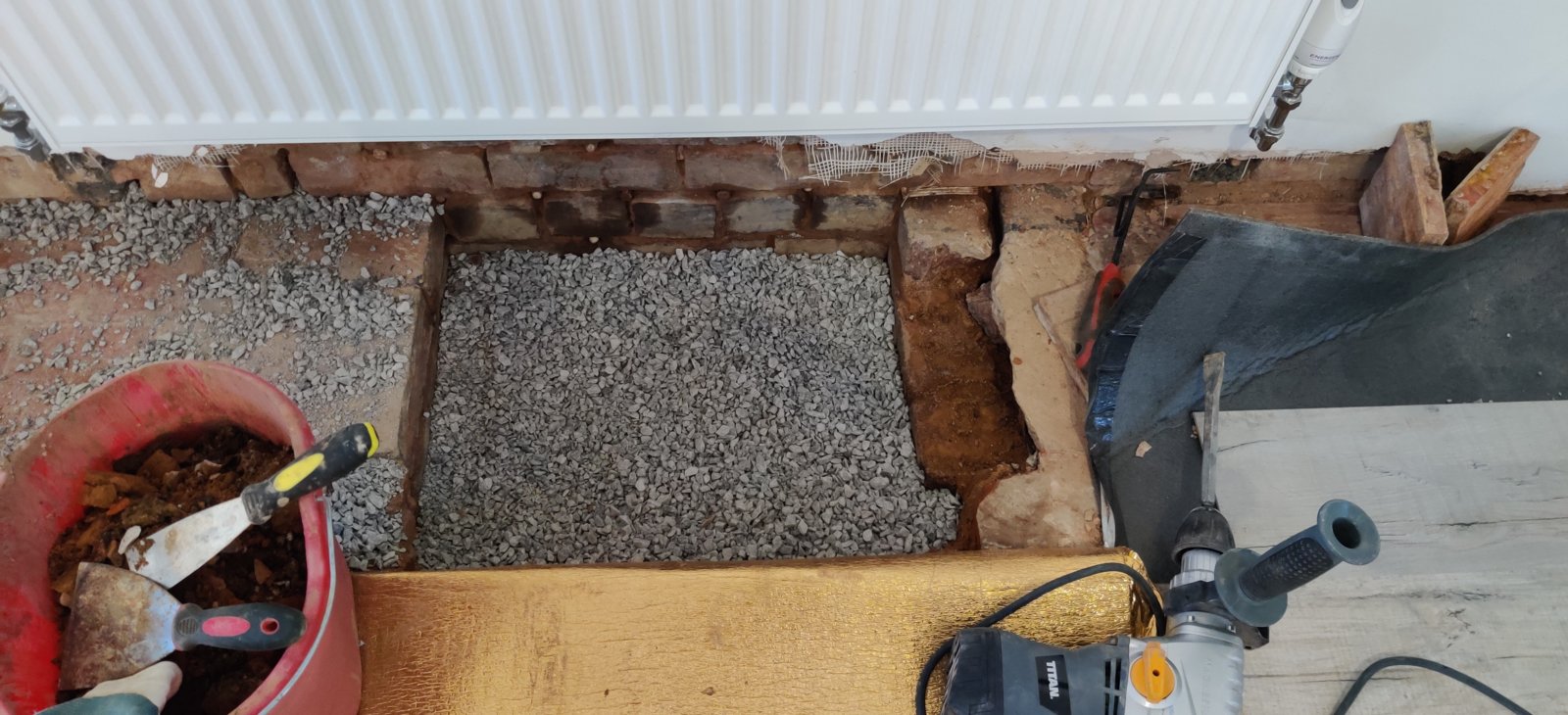

The real question is what caused the soil there to be wet and i think it's heavy rain in the region saturated all clay soil everywhere. Given my house is very old and my floor level is only two bricks higher than the level of the garden, any water rising would have a very small distance to travel.

I'm filling the hole with gravel but the gravel is wet so i move a bucket inside, wait until it dries and then throw it in the "well". I'll leave it open for another week or so whilst I'll be away for a trip. Once I'm back I'll add a plastic sheet and then more gravel, fill it completely flat with the rest of the floor. Then one more plastic sheet, underlay and then laminate to redo the floor.
I'll have to replaster the regions I destroyed. So that would come next. At that stage I'll have to think which player is best for my case. And I'll make sure it will not touch the floor, just in case the floor is ever damp again.
Almost there with the filling process
