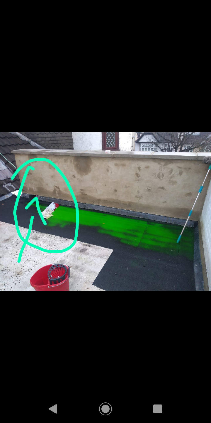

Was hoping anyone on here could contribute helpful advice and diagnosis as my family are suffering and the situation is getting us all down. We have a damp problem on our front elevation wall (first floor) which sits below a parapet wall, - the parapet forms part of an asphalt flat roof. The fall of the roof falls towards the affected wall.
For a while now, damp patches have been forming just below ceiling level occurring within 24 hours of rainfall. There is a strong damp smell which goes away after a few days of dry weather. The wall is a solid wall, but is thick.
We originally had problems with water streaming down the internal face, and this was caused by a cracked cement fillet. Water was travelling down the rear of the flashings and into our bedroom.
After this was repaired, we continued to get the damp patches, although the direct water streaming down the internal wall ceased. To try and resolve the issue damp patch issue, new coping stones were added to the affected wall and the face of this wall was also rendered. The flat roof at the junction of the asphalt upstand and wall was treated with torched on felt.
The issue however still continues. The following was undertaken to identify the cause:

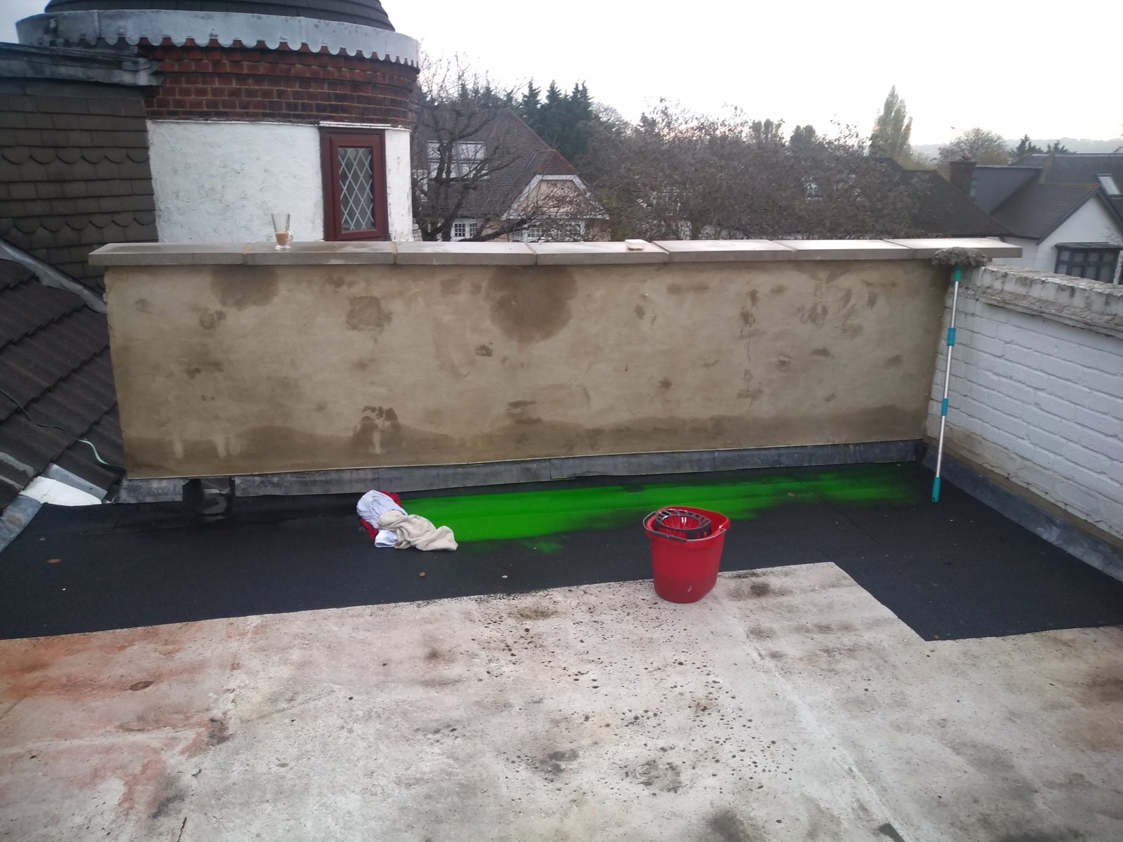

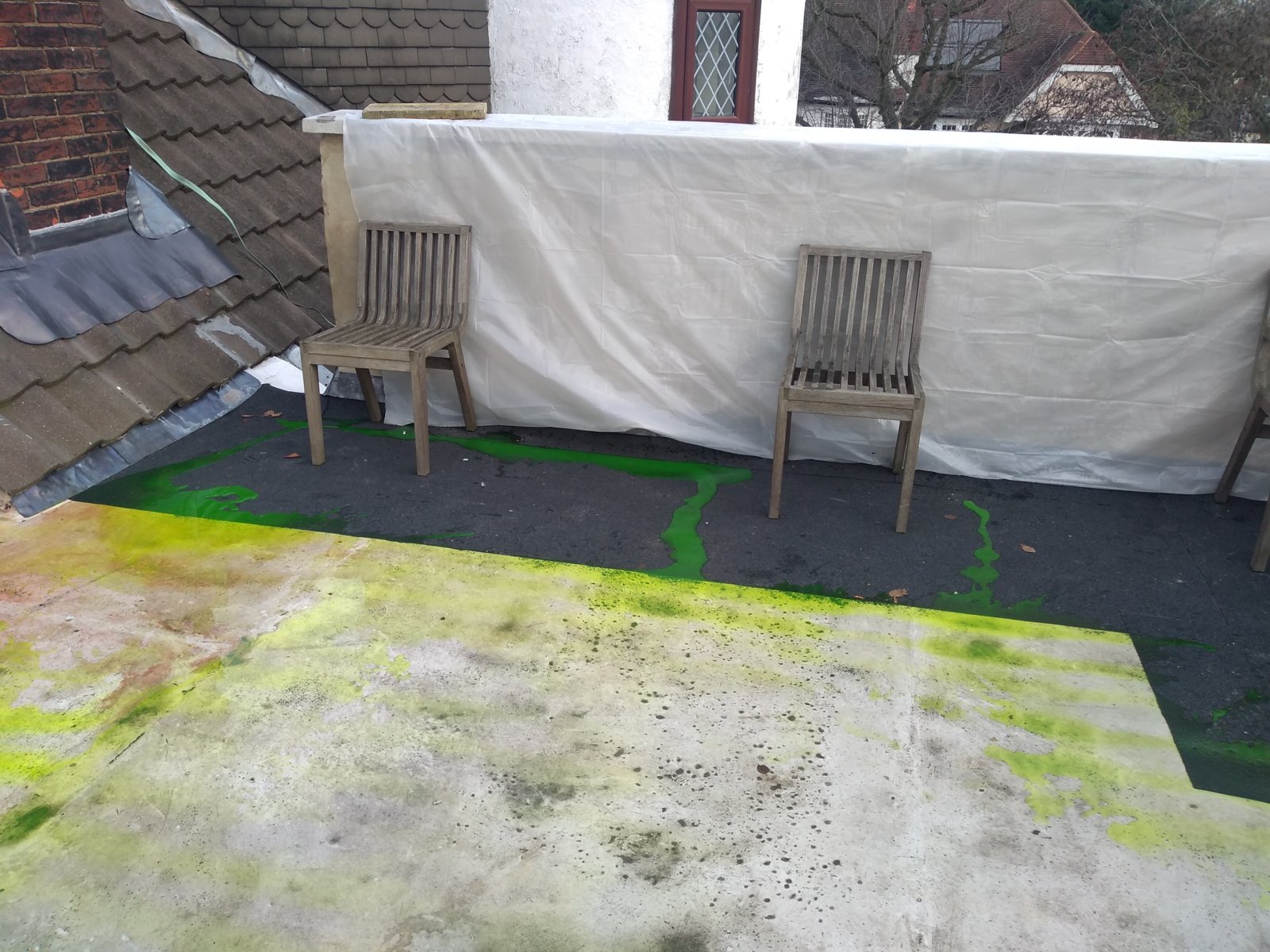

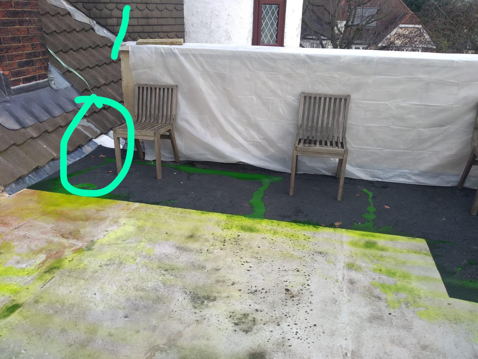

· A dye test over the felt and asphalt was undertaken. No dye seen on the bedroom wall.

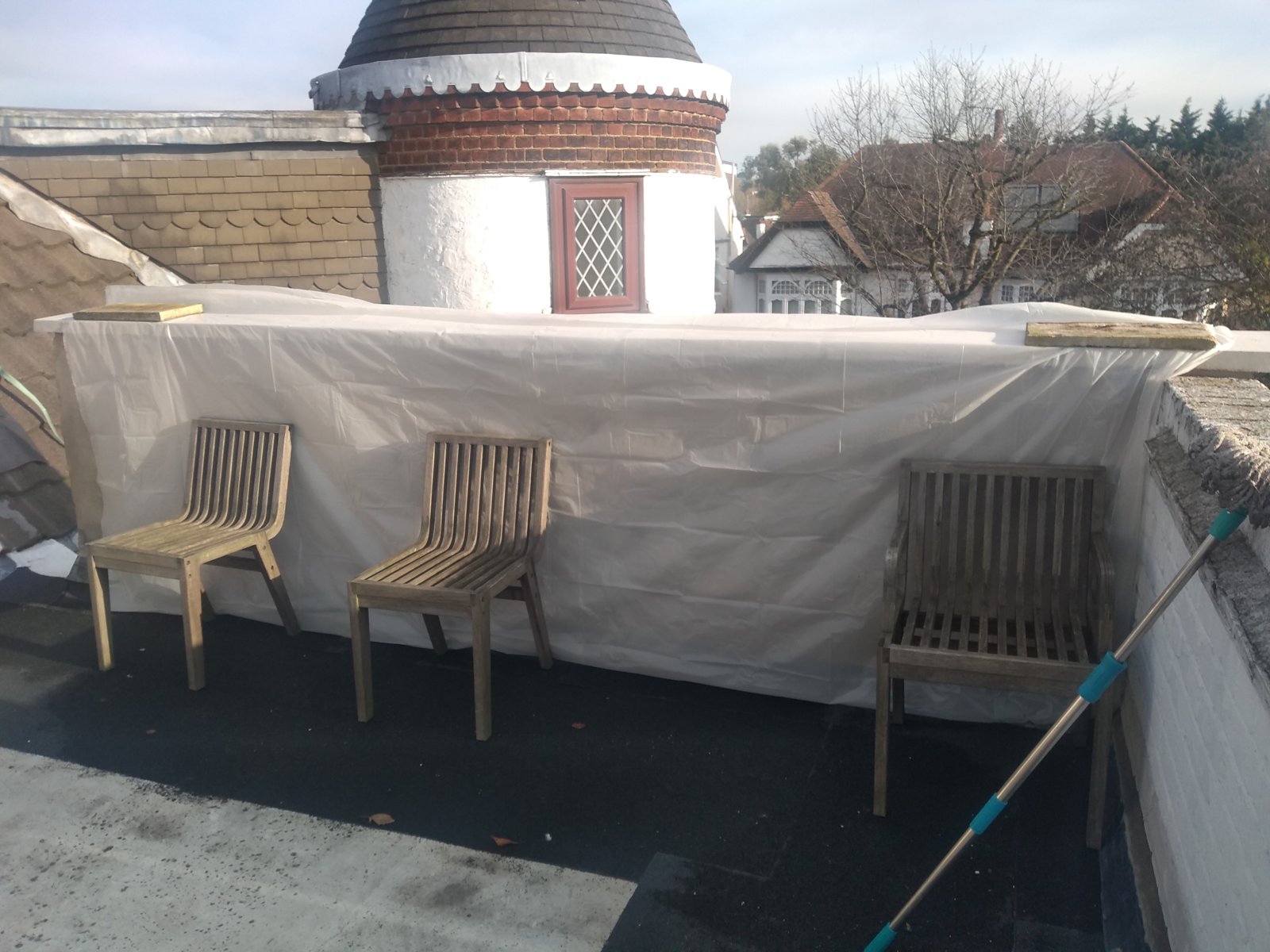

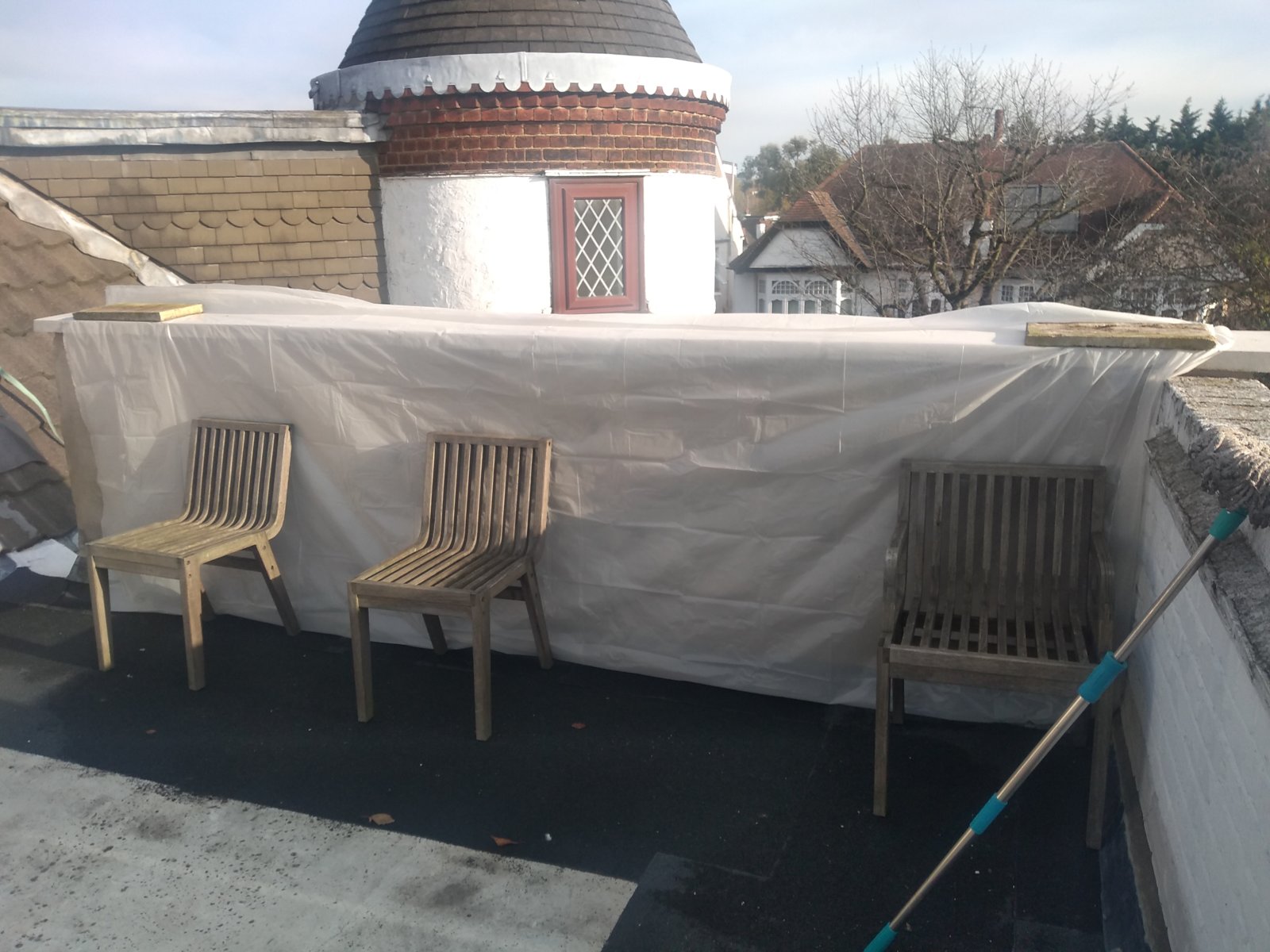

· A waterproof Upvc plastic sheet was placed over the internal side of the flat roof, covering the coping stones and the render. This was because it was suspected that no waterproof additive was added to the sand and cement render leaving it porous. Neither was a DPC applied under the new coping stones. However, the original slate DPC below the coping stones is still in place and likely to be working as the rest of the wall is unaffected. Moreover, te plastic sheet was inspected and is holding out the rain - the wall is dry. The damp however, continues.

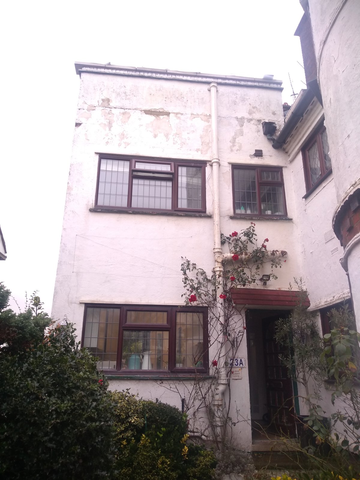

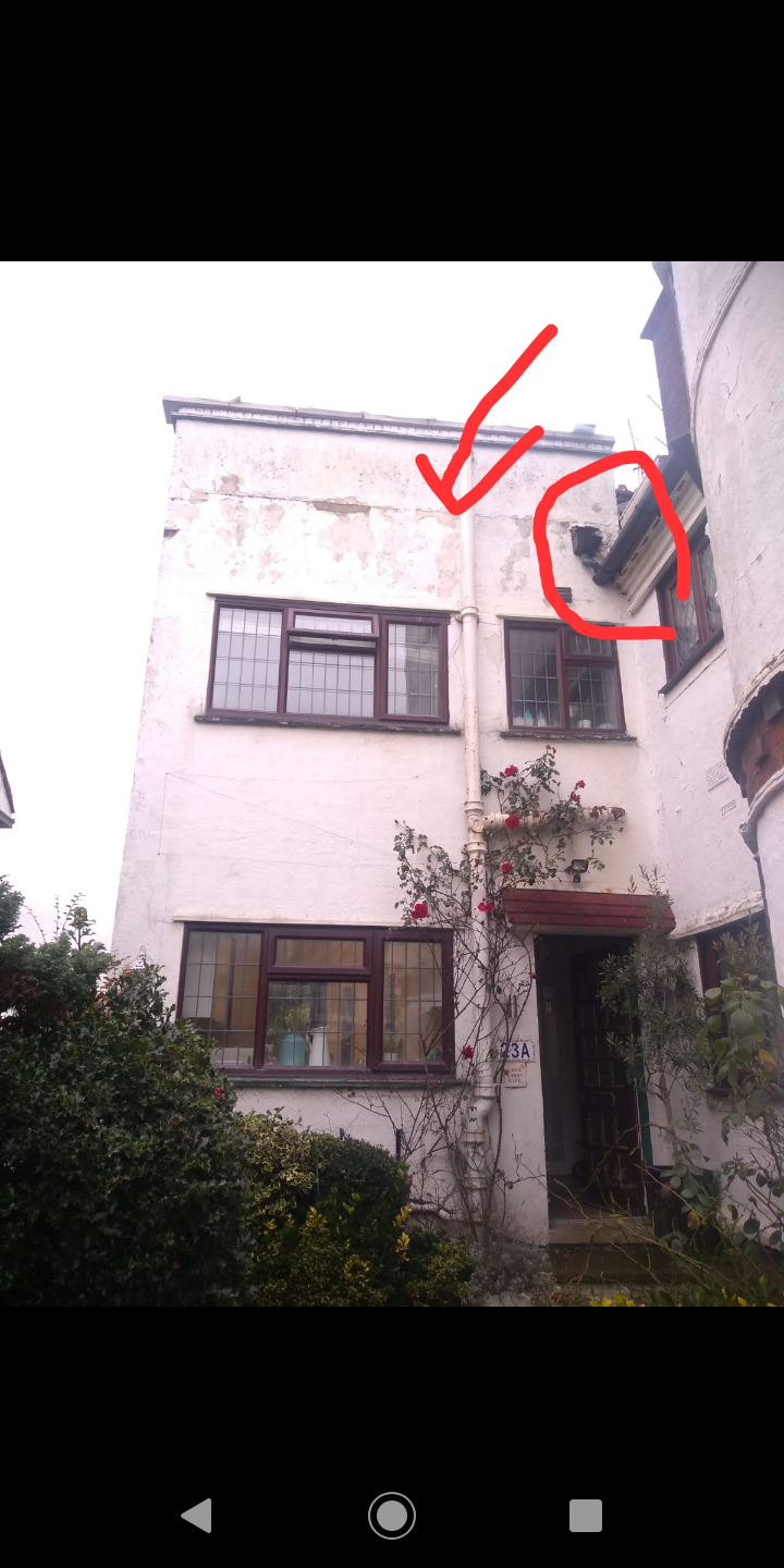

Front elevation - showing area where damp patch is in relation to hopper.

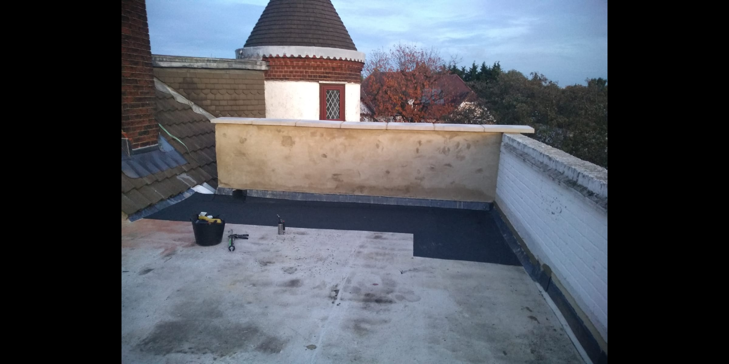

Above: - photo of wall which has been re-rendered with new coping. Still damp patches are occurring.
Dye test – and also showing Upvc waterproof sheet over wall and new torched on felt. No dye seen in bedroom.
Upvc sheeting which has kept water away from exterior internal face of wall. Damp still occurs.
Showing dry wall after Upvc sheeting placed on top.

Above – dye test.

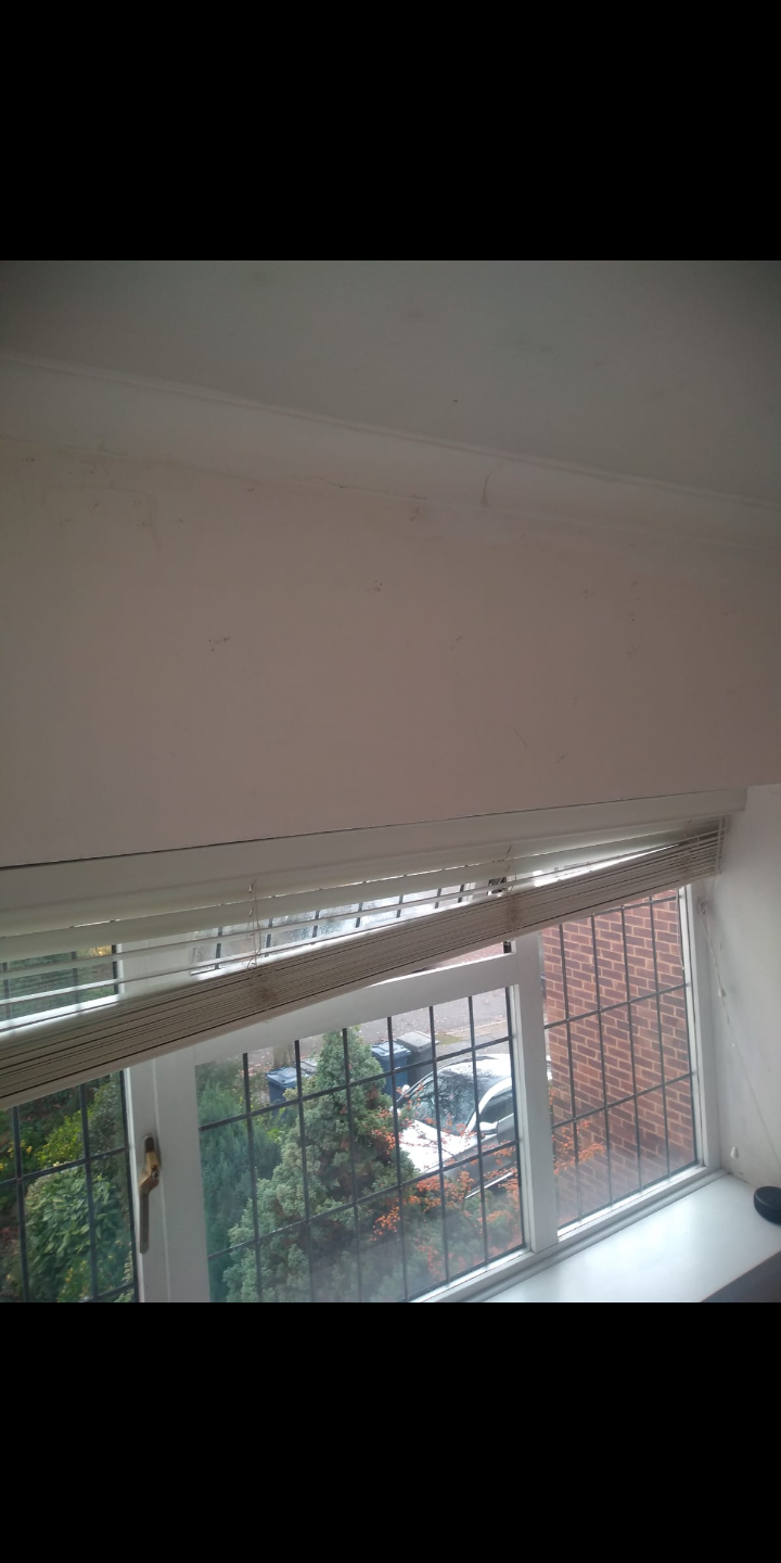

Damp area internal wall front elevation below parapet. Streches across other areas of wall. NB wall on oppsite side o parapet is unaffected. Fall of roof is towards this wall.

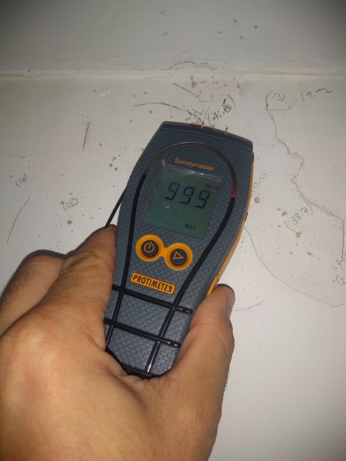

Protometer test shows moisture.
