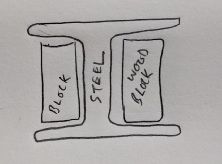

I can't picture what you mean about wood blocking? In any case, my advice is insulate as thoroughly as possible. One issue with eaves is that mineral insulation in the triangle area is necessarily thinner. A way around this is to place a sheet of PIR insulation into the triangle area and then continue with mineral as the space allows. Alternatively, get hold of a few ventilator trays, which will allow you to pack the mineral a bit tighter.
Apologies I can be bad at explaining! I mean this arrangement -
Ok, wood infill like that is normally there to support hangers or to give you something to fix to. Unless you need additional fixings I wouldn't think you'll need any additional wood infill.
That makes sense. I couldn't see the value in it as insulation!
