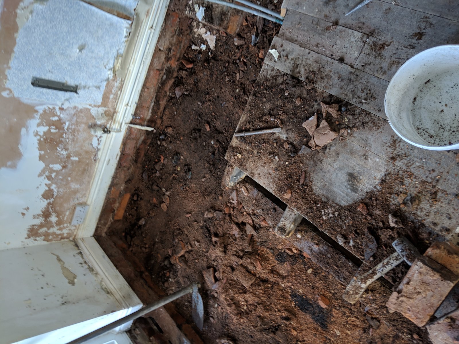

It has been a busy week or so, we took out all of the concrete (gone below the slate DPC) and then installed suspended floor. There is a step by the patio door which is half way up an air vent, so could explain one source of water. But still doesn't explain the area near the rad looking still wet?? Guess it is a waiting game now (waiting for plaster to dry).

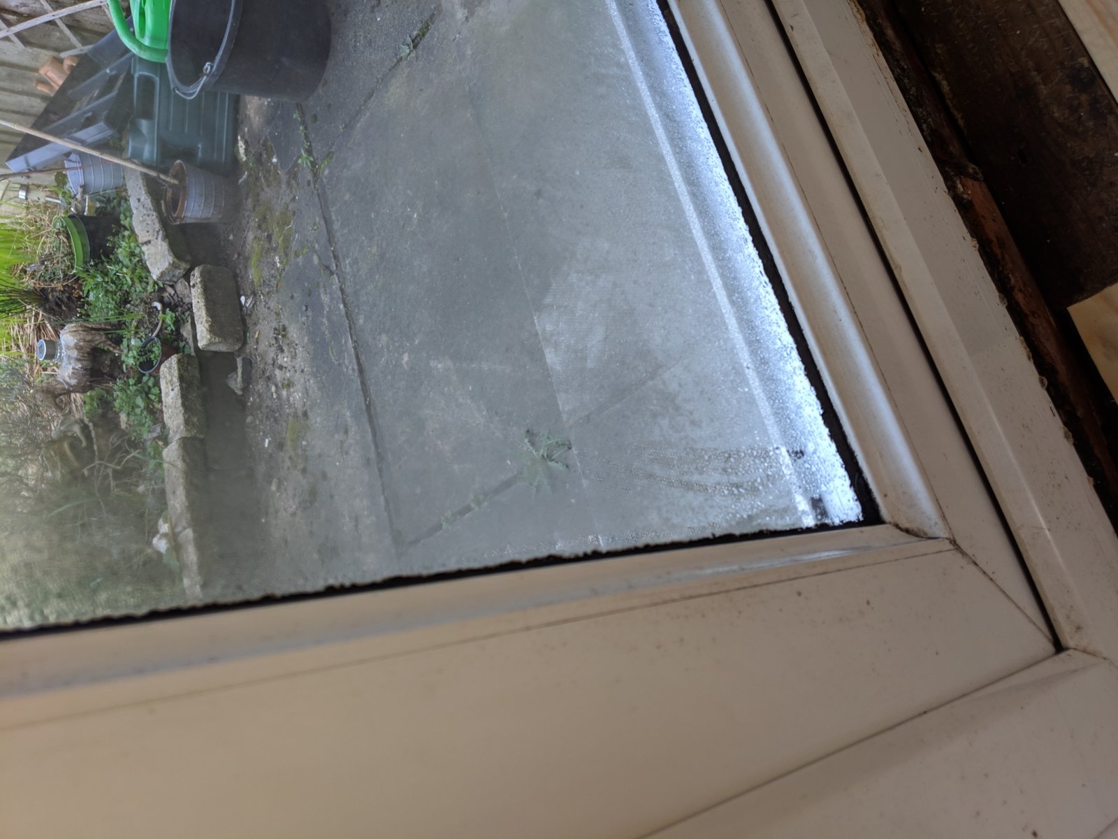

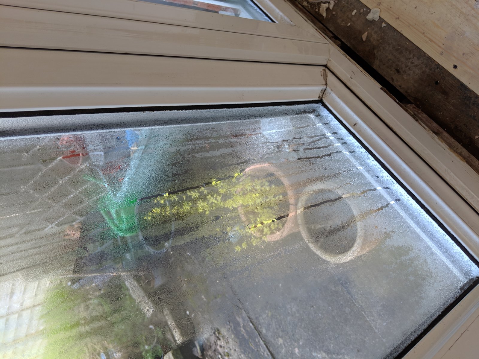

This is the patio door at around 12 pm, the bay window has similar amount of moisture on it. Does this seem excessive amount of moisture for the current weather and can explain plaster not drying out?

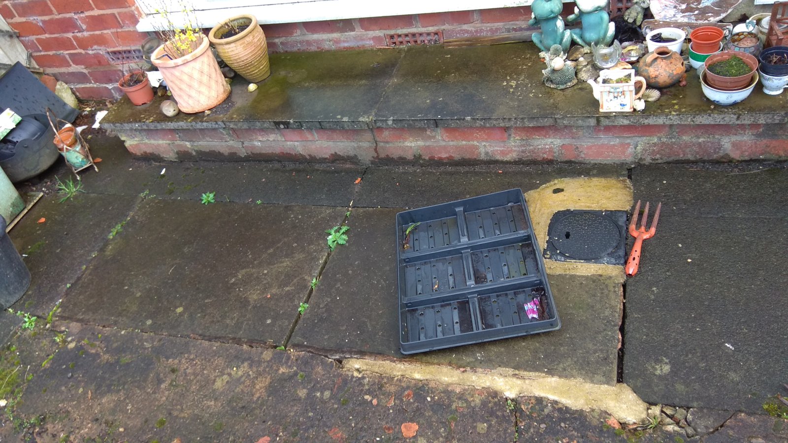

It hasn't rained for around a week now, but prior to that it has been fairly wet weather. I only have this picture of the outside at the moment
That vent under the slab could be the source of water to enter, as on the inside the cavity was bridged and concreted above slate DPC with no membrane. (But i'm not sure that much water could come and spread from there?)
This is the soil after removing the top level of concrete.

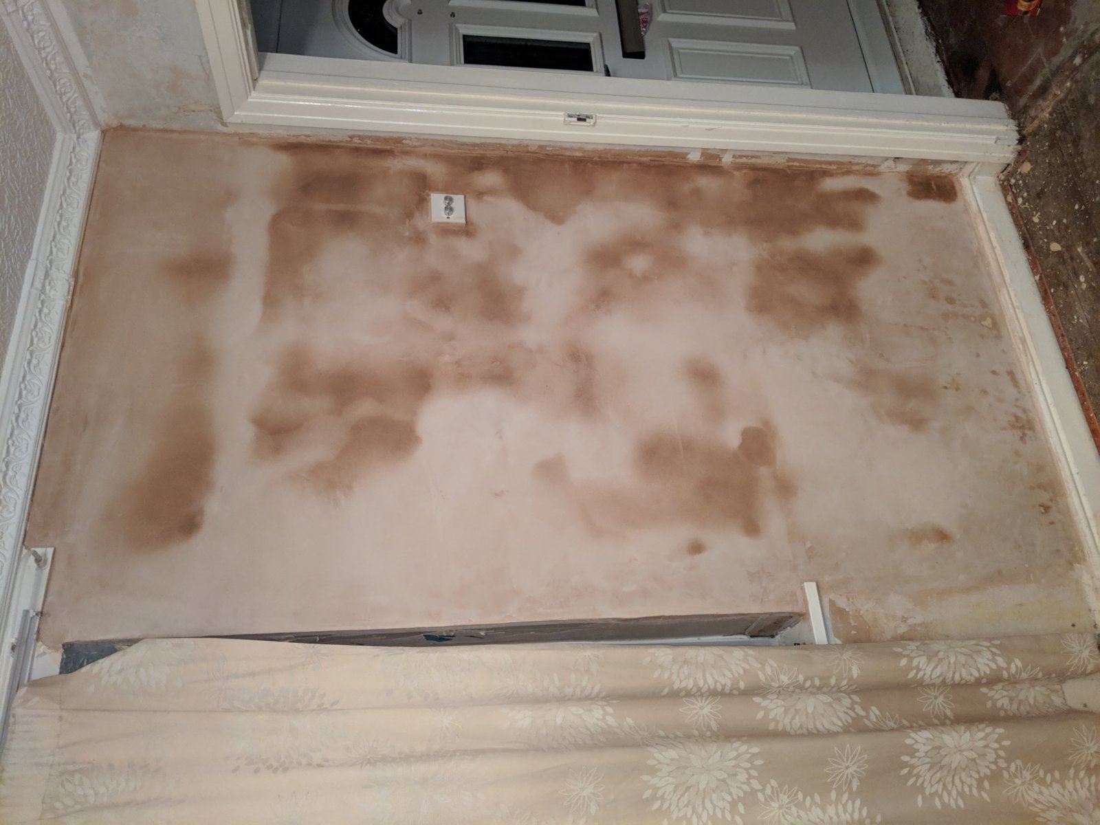

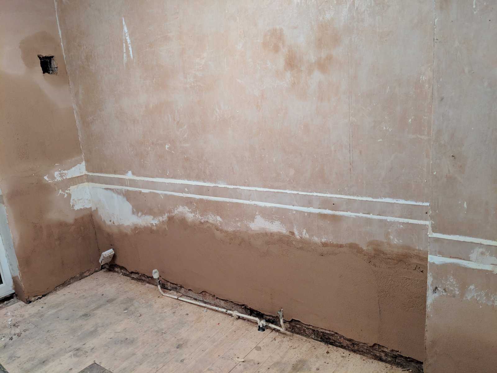

This is wall two days after being plastered.
I was there today and the bricks below the plaster look dry.
This is a skimmed wall on the other side of the room (was dry and no damp issues) was still very patchy after 2 days. It seems mostly dry today (3rd day) after I kept the windows and doors open for good few hours.

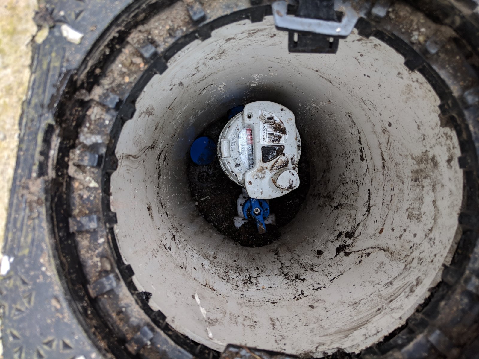

The paving slabs in your outdoor picture look very wet. Why?
There is a small trap in the paving, such as a stopcock or water meter would be underneath. What's down there?
It had been raining that day.
It's the water meter. When i opened the lid, there was water droplets on the meter and soil around it wet. not sure if that's normal?

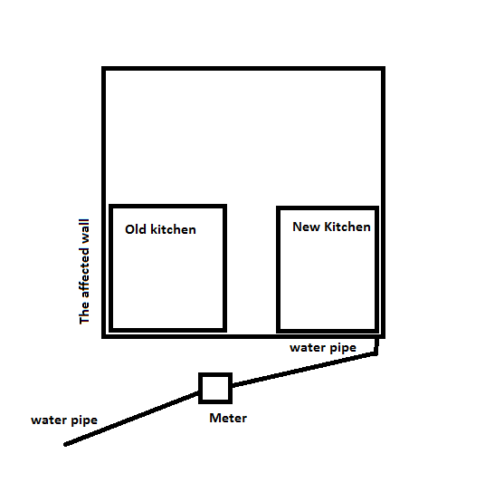

The direction the pipe seems to be coming from, doesn't seem that it runs under the house.
let's consider the possibility that the pipes connected to the meter are leaking. It is, after all, a water pipe of unknown age next to a wet patch.
Is the bubble turning?
Is there a stopcock in the pavement?
What route do you think the pipes take?
Are there pipes or tanks in the loft? Where do the pipes go? Where is the kitchen now, and where was it when the house was built?
Time to get your spade out and have a look.
An experienced plumber or waterman can listen to the pipes and hear if there is the hiss of a leak.
The meter was installed a year ago and the pipe (what i can see) look the new plastic pipes.
The didn't notice a bubble on the meter, i'll have another look.
No stopcock that i can see.

The pinnacle of my artistic skills.
The meter. Ok, just noticed there is a stopcock next to the meter.
looking at the diagram, I see the wet patch is along the wall of what used to be the kitchen.
It's possible that the cause of the water isn't an old leaking pipe.
But I wouldn't put money on it.
Spade time.
