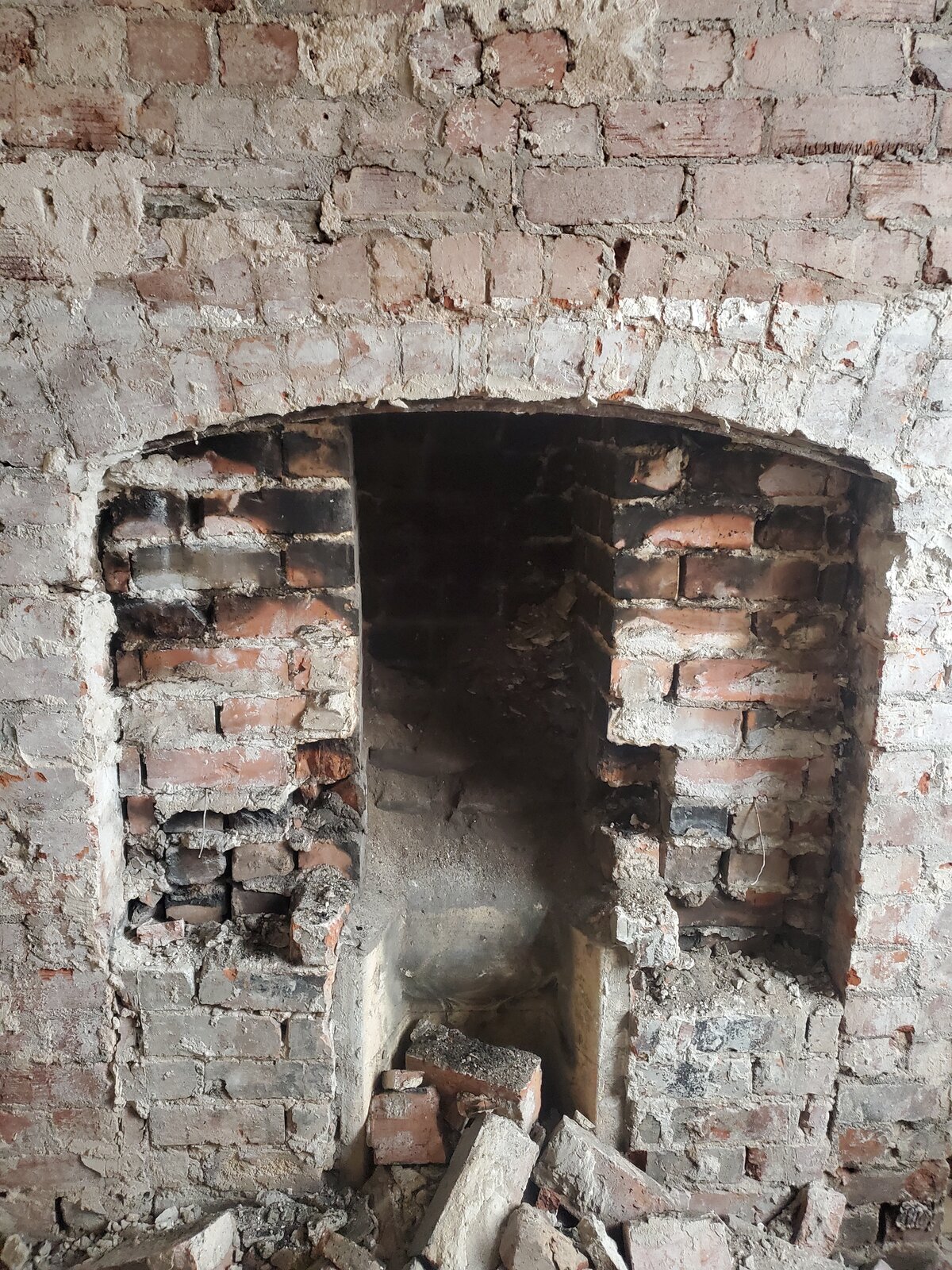

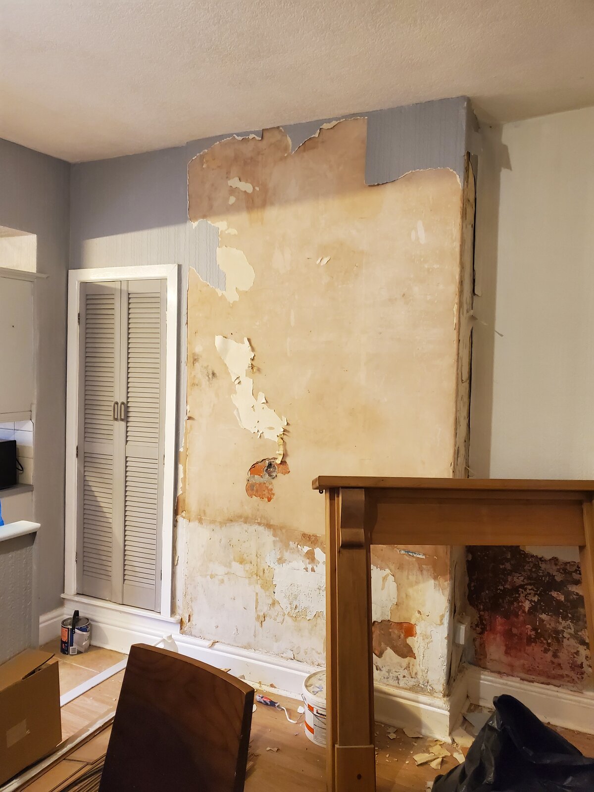

When you say you want to make the fireplace a decorative feature, do you mean to knock away the plaster and install a new mantelpiece?
The little roof at the back appears to be falling off.

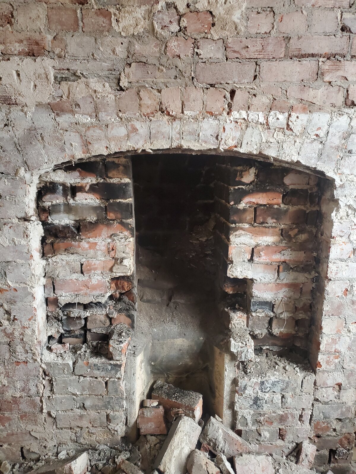

Re the fireplace. There will be a large original opening with an arch about where the damp patch is. You can see the original breast sides and the infill. All the infill can be removed.

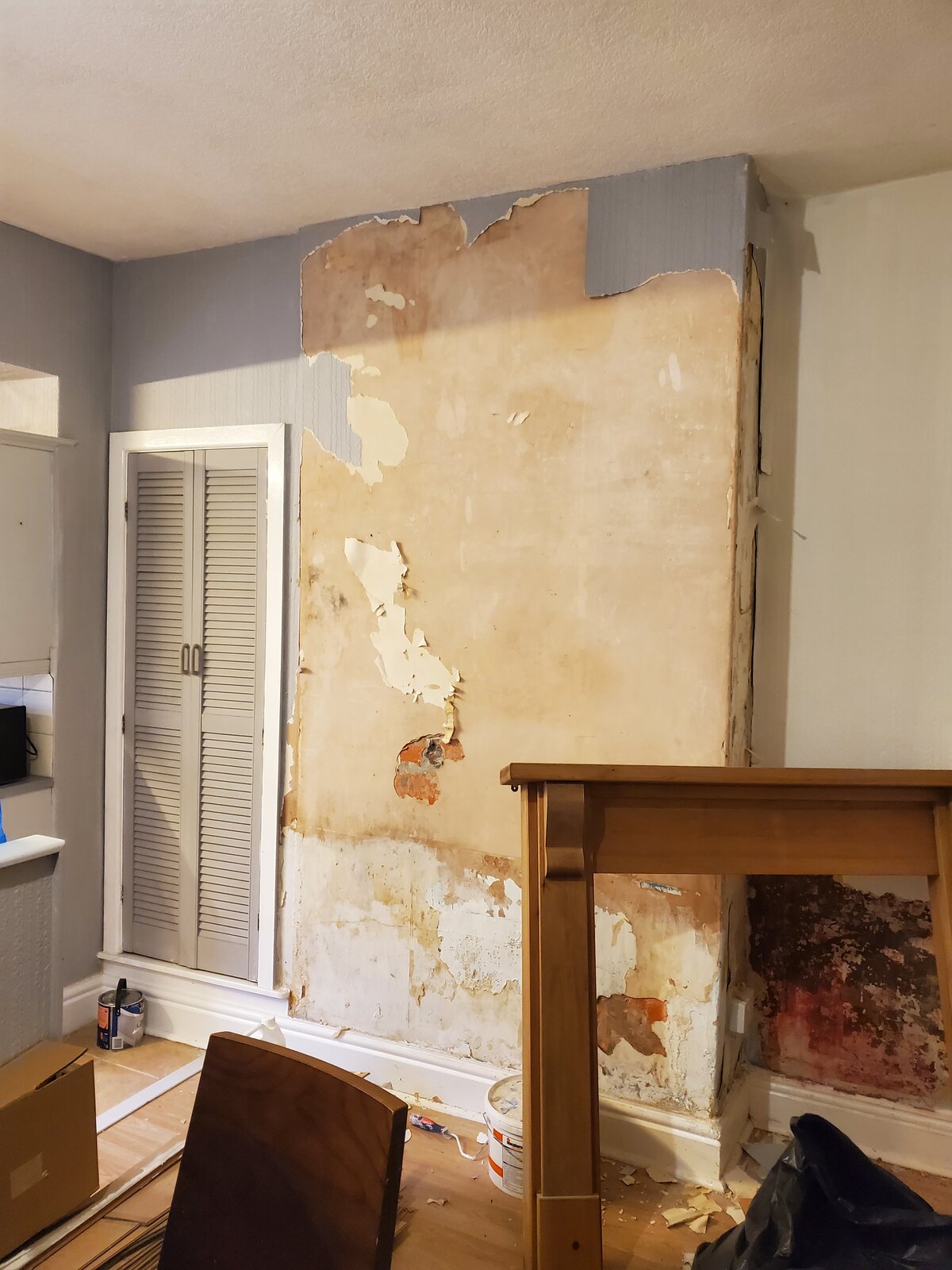

The damp patches are 99% damp caused by hygroscopic salts in the brick of the chimney and surround. You won't get rid of it, so plan to isolate it. The easiest way is to use plasterboard fixed with foam adhesive (not dabs with dab adhesive - the salt will pull through the wet dabs as they dry - first hand experience). Foam is fine for a non-operational fireplace. If you did intend to use it I suggest metal top-hat battens with PB fixed to those, again to isolate the contaminated brick from the room air.

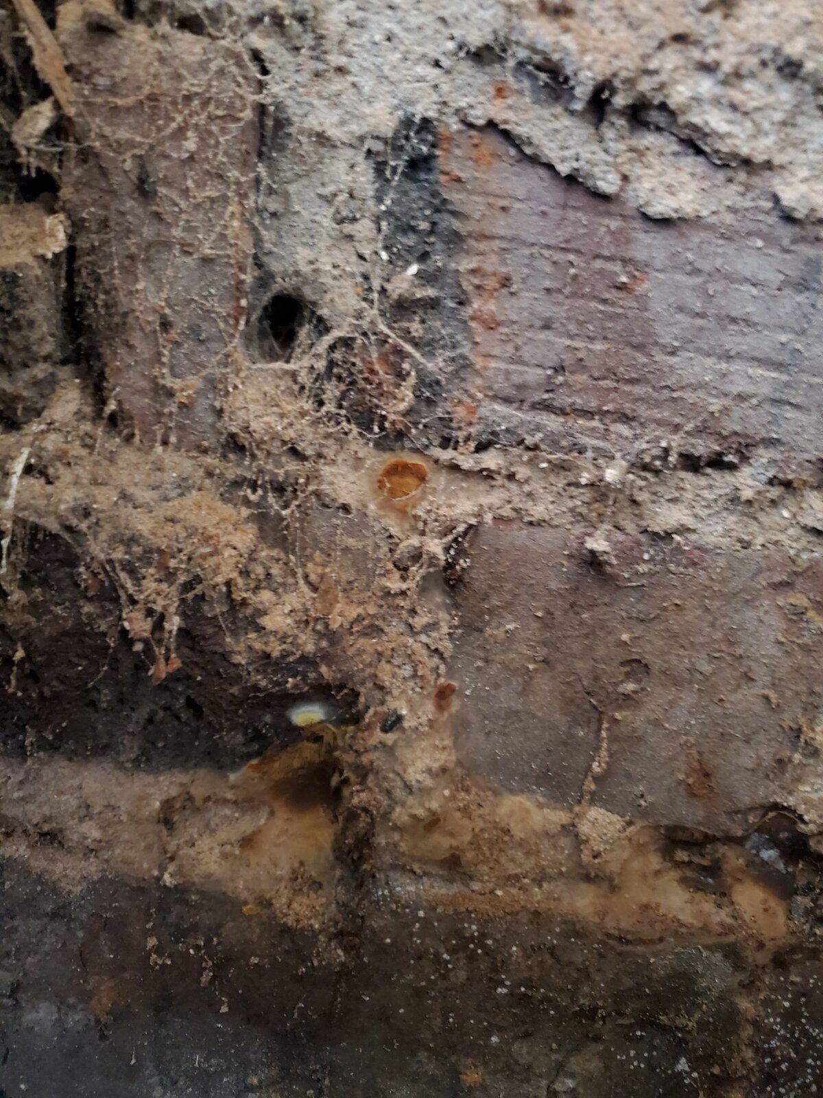

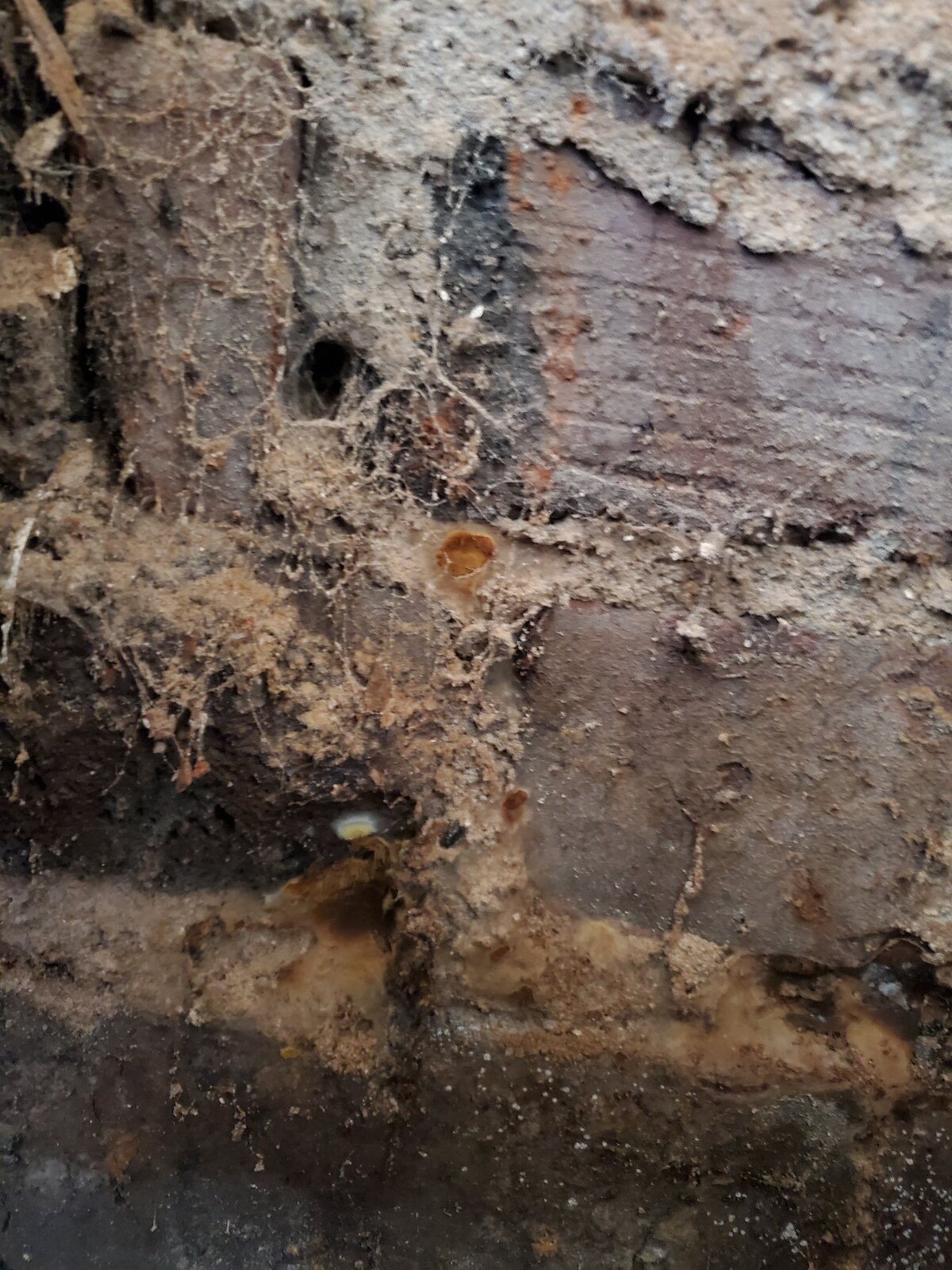

sjee6,have you finished with this thread or just stopped for a bit? The blurred pic of fungus shows what could be dry rot, a better pic is needed. Dry rot can move through wall cavities.

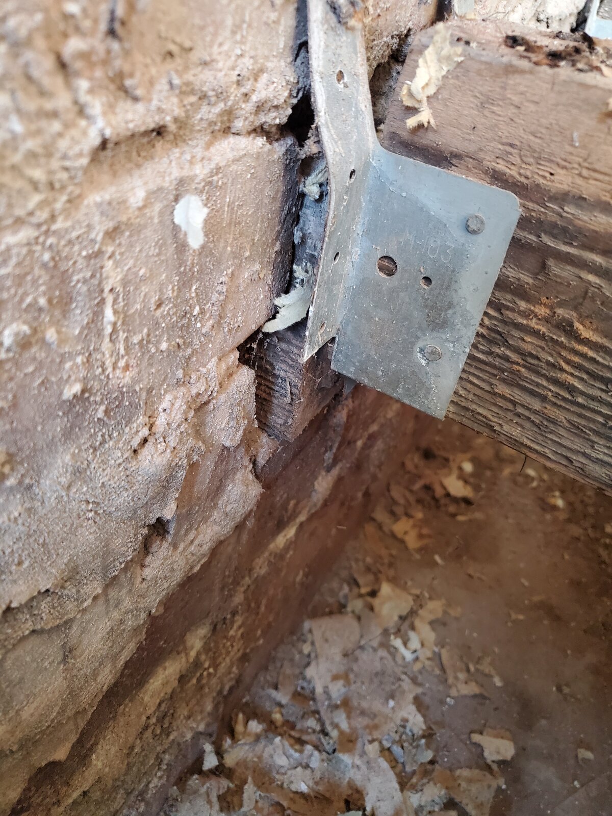

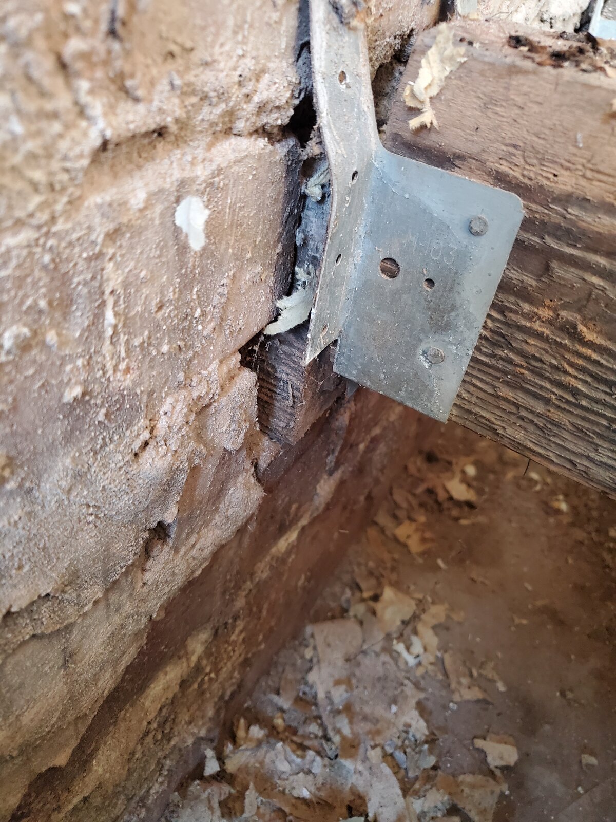

If you re-use the joists then you will have to do bolt-ons. Any joist with dry rot then it must go. Dig into all joists looking for live bugs. Installing a suspended floor is not a difficult job.

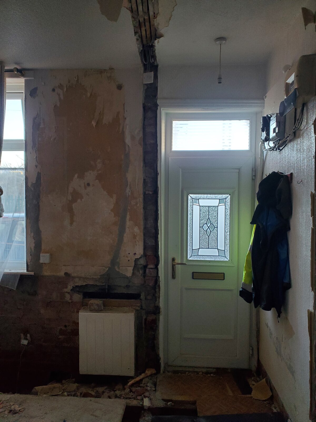

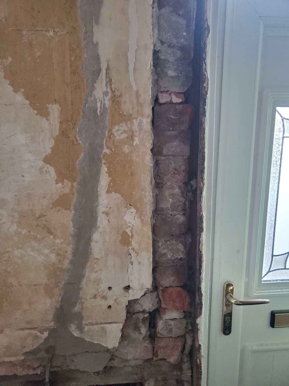

Remove the timber lintels above the meter box and use an angle iron or concrete lintel to brick up on top of. The gas pipe going up the wall should be in a corner safe zone with metal capping cover.

The arch over the fireplace begins 17 courses up, about 54".

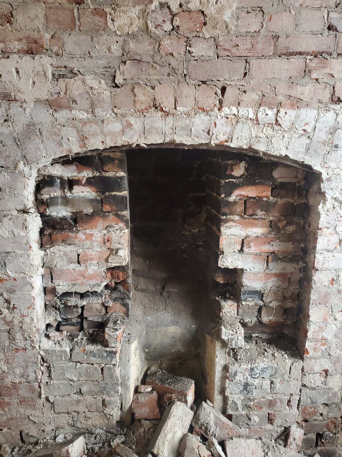

I've knocked out some of the fireplace this morning so can someone just confirm that it will be safe to knock out the rest of it. I'm worried about it collapsing on me. There's just an iron bar supporting that arch, but what's supporting the rest of it? And does anyone know how much it is to hire a skip?

The pic of the fungus is still burred but I'd say it is dry rot.
You can safely remove the in-fill in the fireplace. The arch will hold good.
The metal hanger pic shows all wrong.

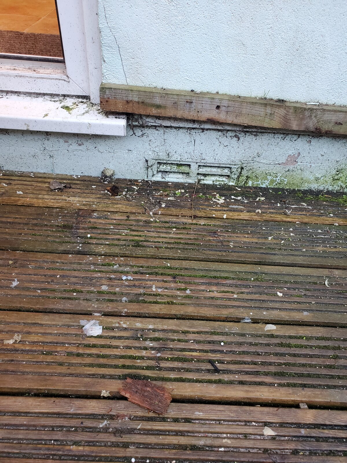

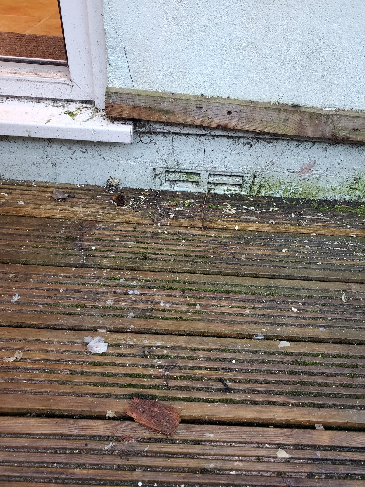

Could you show pics of the the chimney breast and the kitchen walls/floor? Can you show pics of the lean-to back wall, they would show air bricks if vent pipes were used?

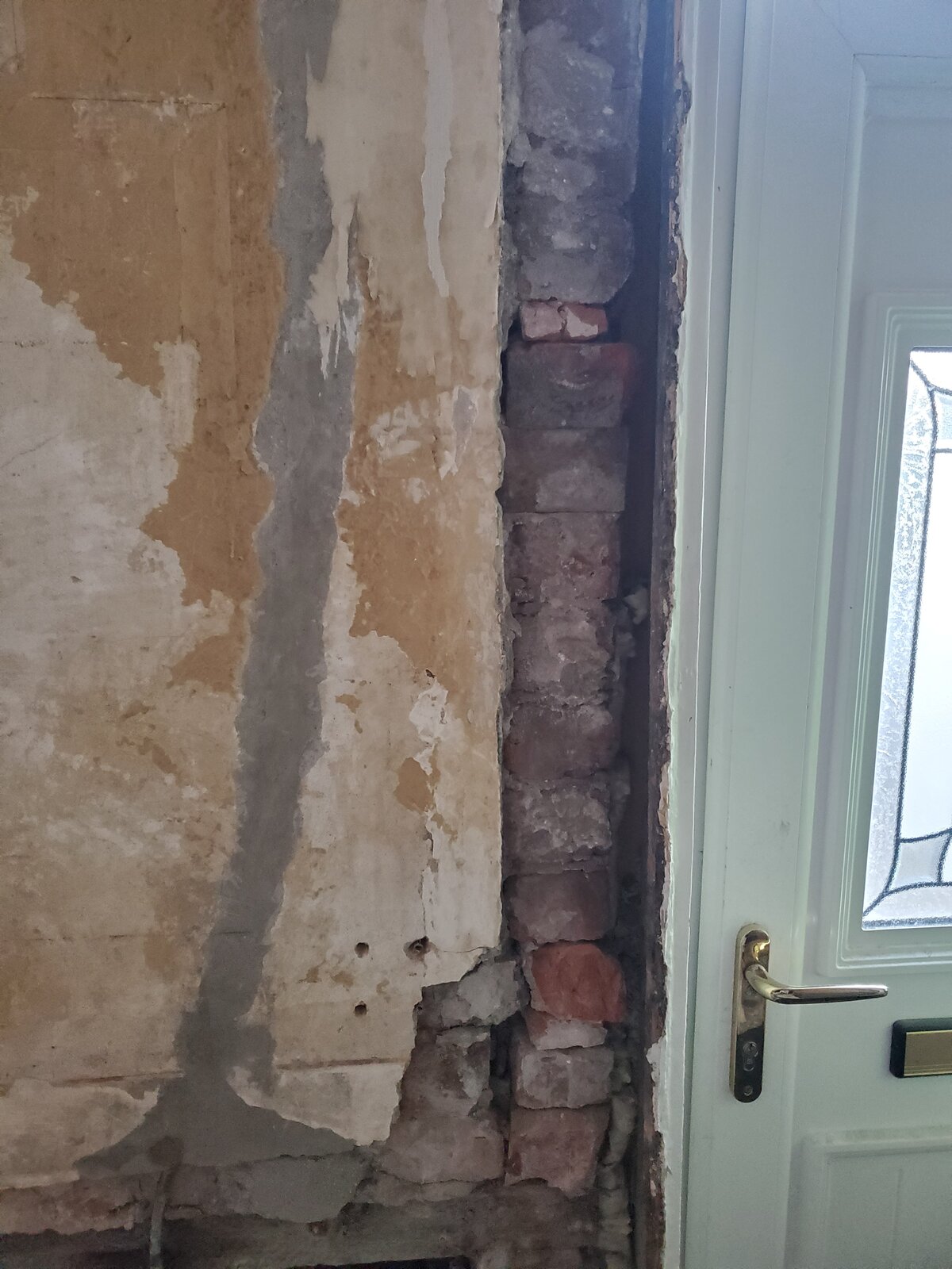

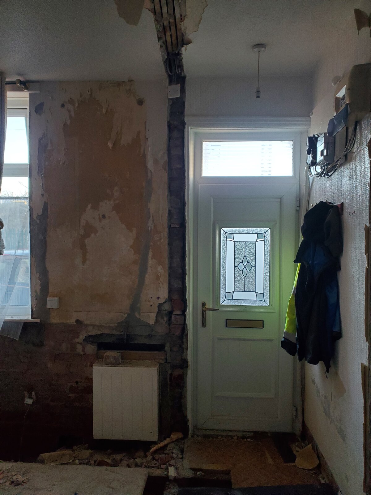

I knocked the vestibule down today, it looks like it was original, some of the bricks were going from the external wall into the vestibule wall. I've just lodged a few bricks in there for now until I mortar them up. Doesn't seem like It's load bearing. I don't know how I'm going to seal the doorway.

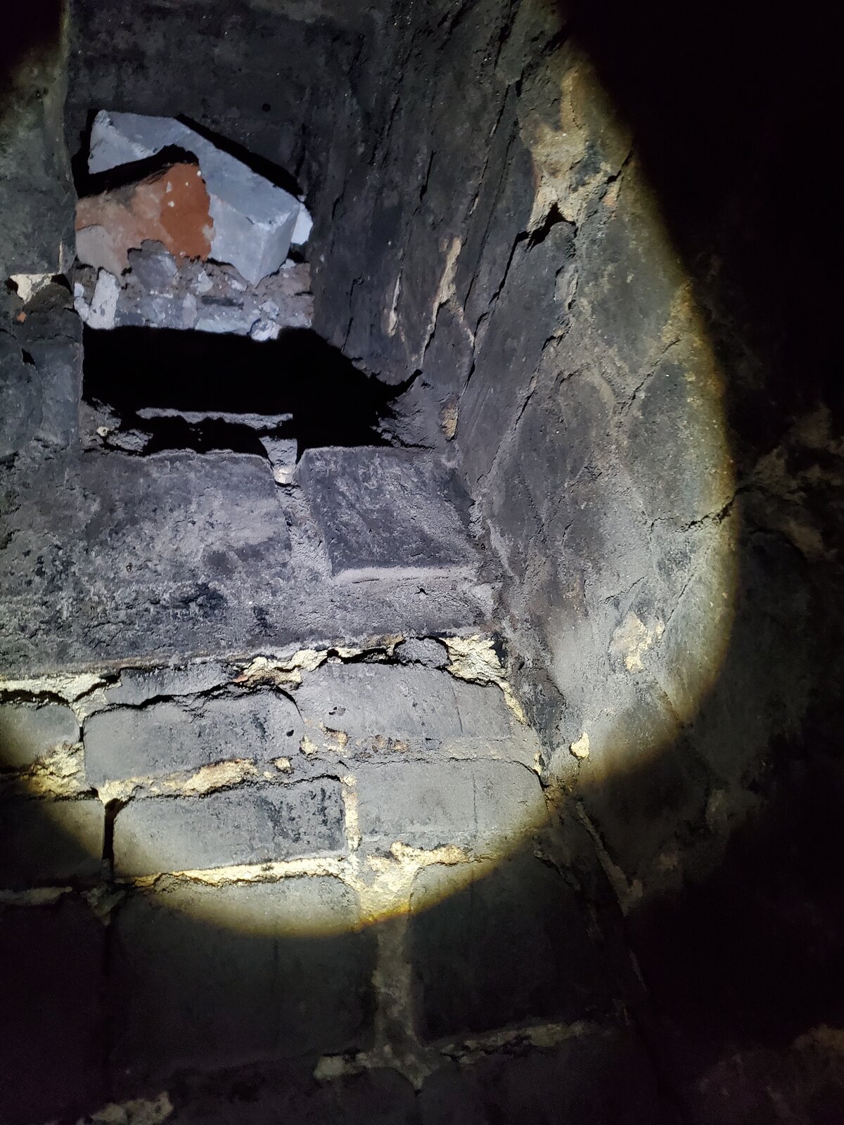

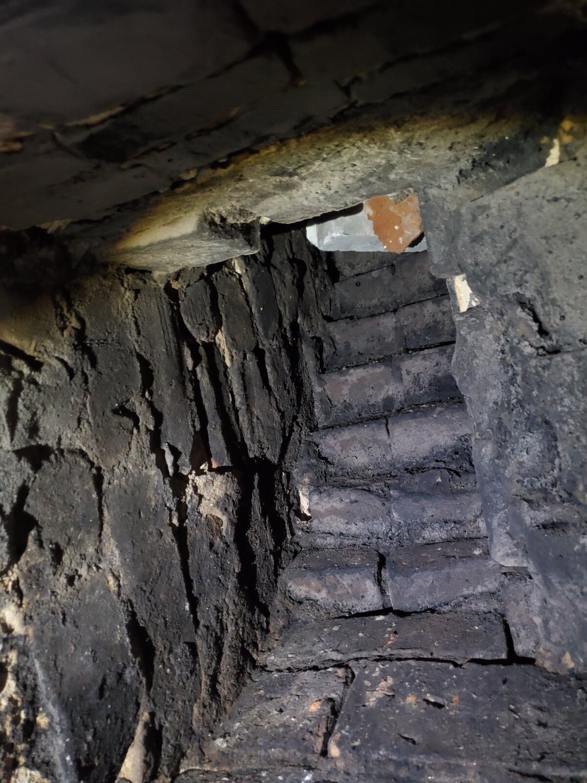

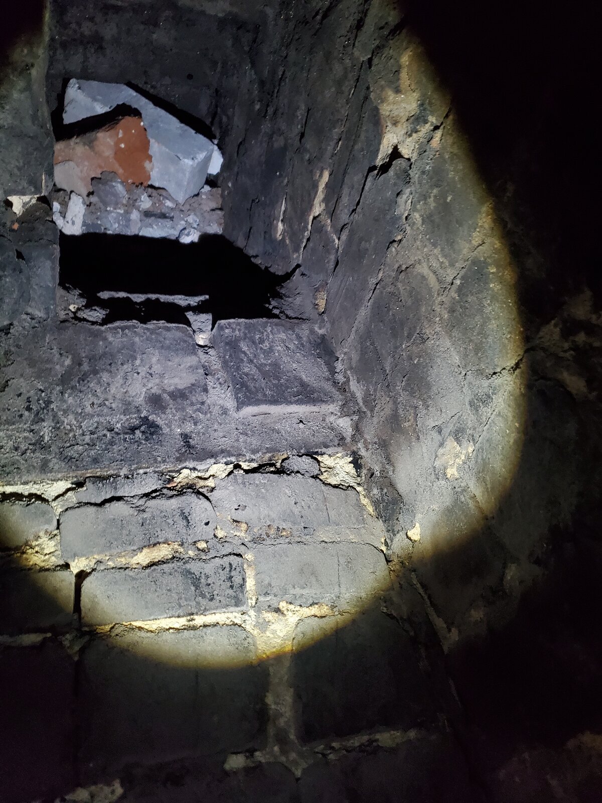

I've included some pics showing up the chimney; there are some loose bricks stuck up there. Might they not have threw them down when they dismantled the chimney stack from the roof? Might be the whole chimney stack stuck inside the chimney breast.
There's 3 airbricks on the extension outside just above the decking, but I thought they still might've just put them there for show.

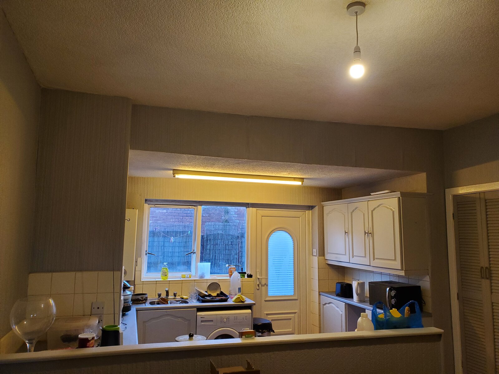

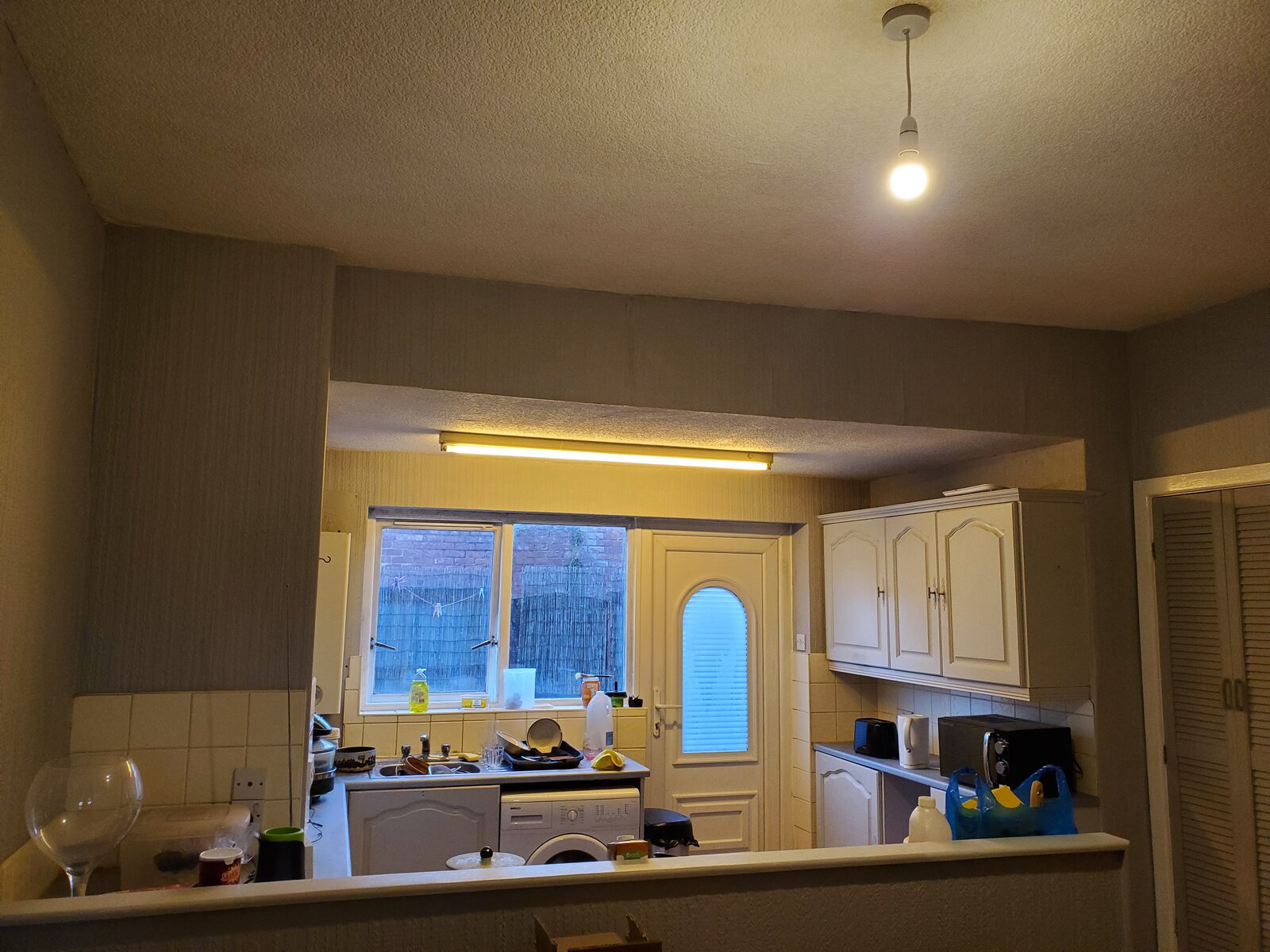

Still not exactly sure what you mean by wide opening but I've included this pic of the extension from inside. The chimney breast in my kitchen is connected to this utility closet, think they might've used plaster board or something, but It's damp in the utility closet as well.
Oh and I noticed before, the pipe just above the meter box that's been plastered into the wall is dead, It doesn't go anywhere.
If houses are always built on level foundations it must've subsided. The joist pic just shows how they've been cut and lifted and bolted into the wall on hangers. Upstairs is still not level, there's a spot I was planning to position a shelving unit but I know it'll just fall over.

You've got a wide span at the kitchen to the lean-to knock through and therefore a large lintel. If the lintel was badly installed it could have caused structural difficulties for the upper floor and the upper floor openings?

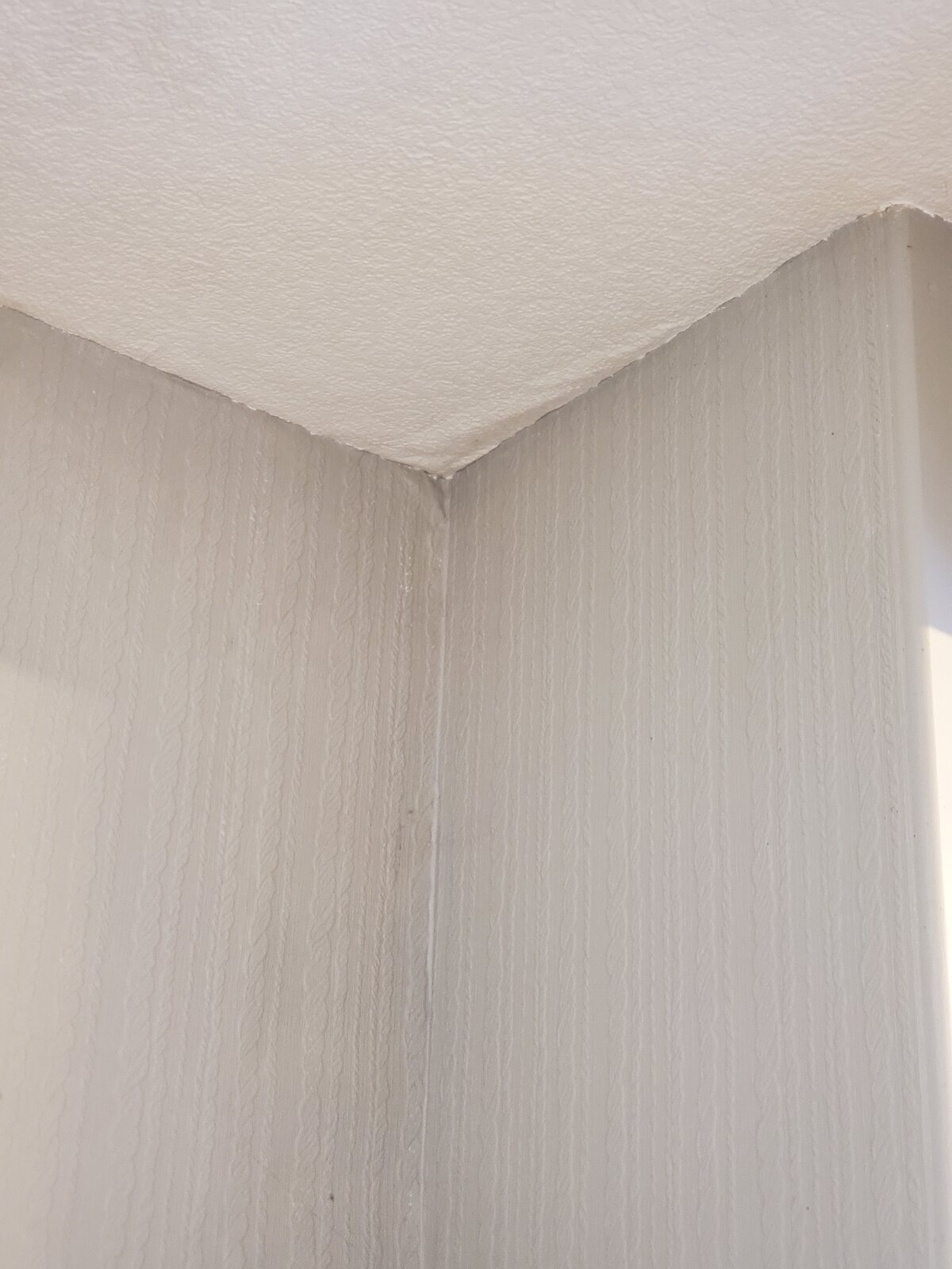

Any wall cracks upstairs?
What are you going to do with the kitchen chimney breast?
Is the kitchen floor solid or suspended?
The vestibule wall below the floor needs removing.
Remove the redundant pipe above the meter. Remove all redundant pipes and cables

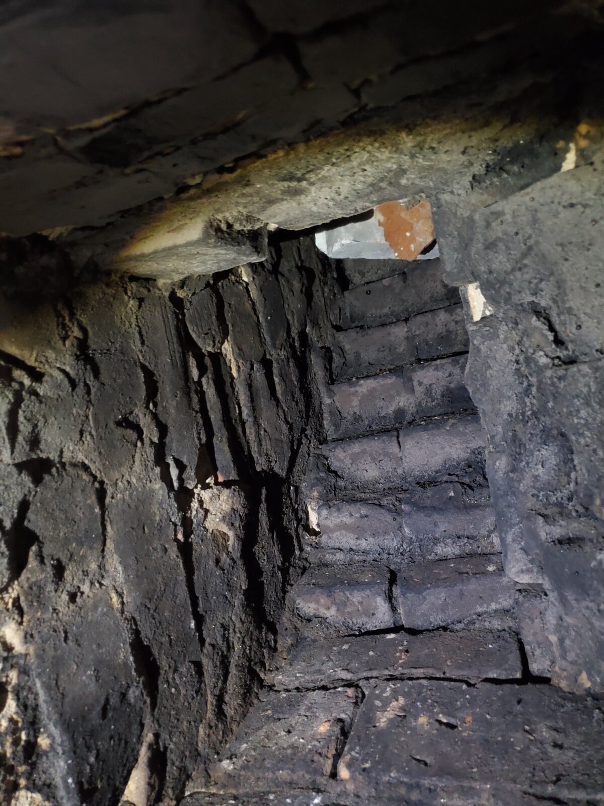

Remove all the infill its safe, you can see the party wall at the back of the fireplace opening. Drop all the loose bricks from up in the flue. The flue is thick with soot, it needs sweeping.

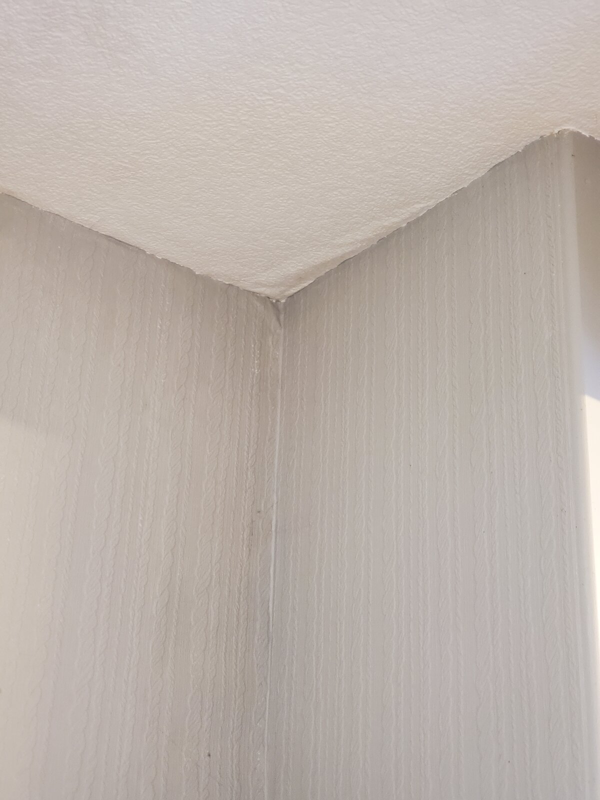

Not sure about wall cracks, the bathroom is cladded and the spare bedroom is papered.
No idea what to do with the kitchen yet. The floor of the extension is tiled with stone, the rest is laminate so I can't remove the utility closet without the floor looking weird.
Main kitchen is suspended but I'm assuming the extension would have to be concrete wouldn't it?

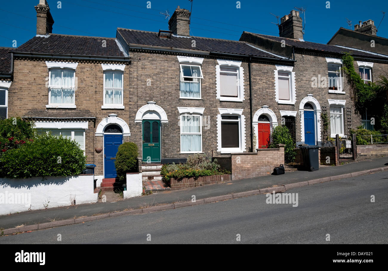

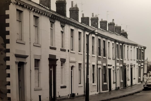

This is what I was trying to explain about all the houses on my street being on a slope but they're all aligned. Mine is like the first picture so how could they've been built with level foundations?
