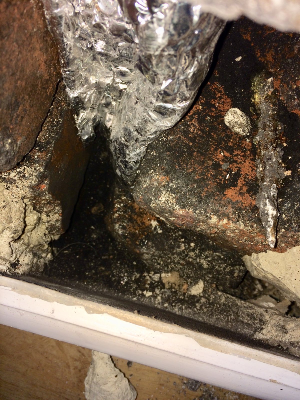

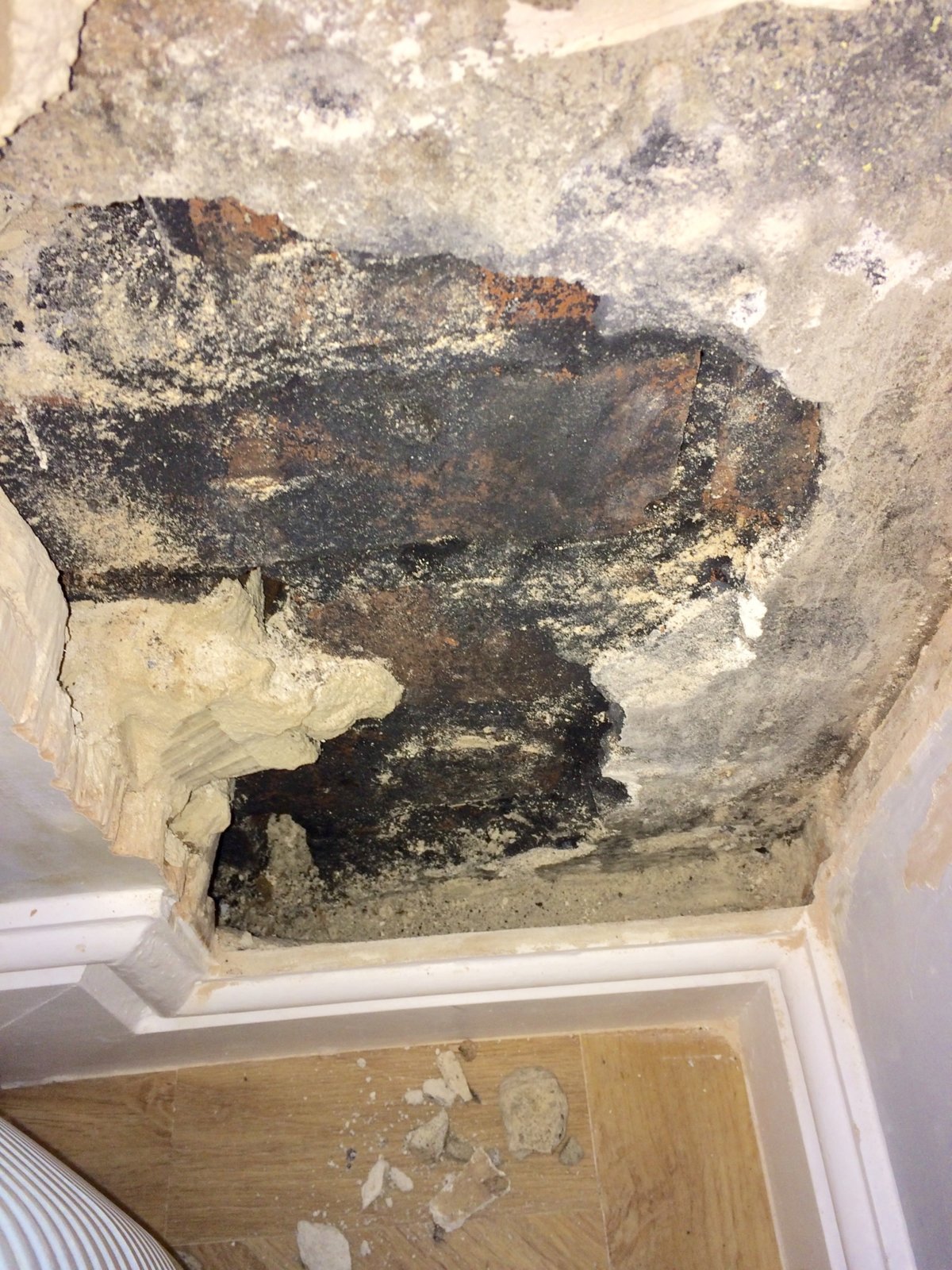

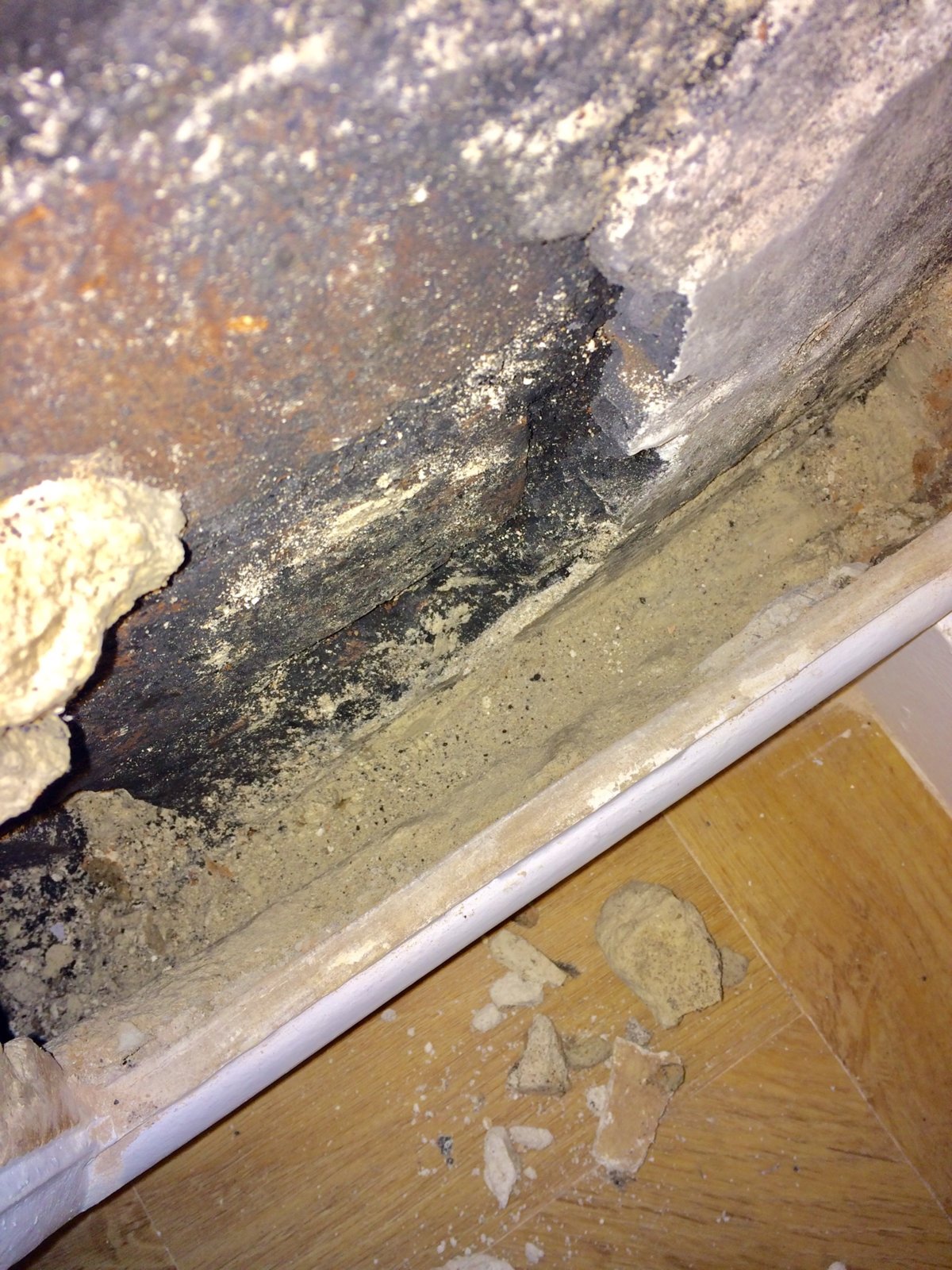

Don’t know if anyone could offer advice on this. We had exterior work done and cause was a badly fitted pipe running to drain. Exterior is now not letting in any water as have proper drainage/re-rendered .
Kitchen company Builders have been to replace damaged plaster internally and think there may be rising damp from floor as well as water externally. They are being funny and will only replaster and take no responsibility if it comes back and don’t appear to have a suggestion if damp Ian coming up from the floor.
Walls pictured are dry but plaster behind skirting lower is feeling a bit damp but could have not dried out?
What would the fix be here?
