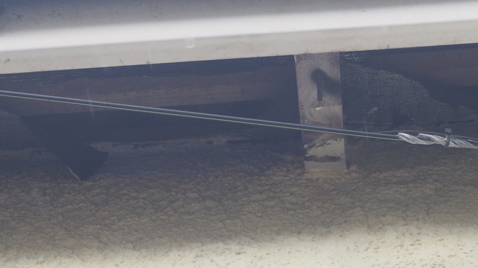

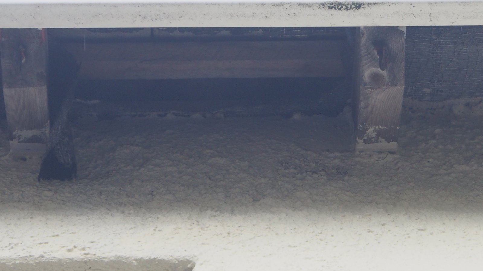

There is damp on my ceiling,I've had a quick look outside and noticed that roughly where damp is the felt torn and is now hanging down. That has happened in several places. What are my opinions? If. Needed I'll get photos in daylight.

please post pics of damp signs - the outside of the roof - the underside of the roof in the loft?
I'll post pics when I get in of the outside and inside. I'll have to wait for someone else to go in to loft for me as I can't get up there myself.
Image 1 is where damp is
Image 2 just cracked felt
Image 3 is how half is
Image 4 and 5 is how some are but no signs of damp.
My partner in her wisdom just decided to paint the bedroom a year ago in her hope of making it look good. I don't think there was damp then but she never took the peeling paint off either
thanks for the pics.
but they dont get me much further.
pics of the roof surface would help?
the felt appears to be a modern type?
such tears in the felt at the eaves bays should have been well visual to any surveyor?
maybe, some roofer will ladder up, and remove tiles/slates from the bottom course of tiles above the bedroom damp signs.
this would enable them to examine the conditions near the eaves/gutter area.
ask for photos of their findings, and ask them to go in the loft.
