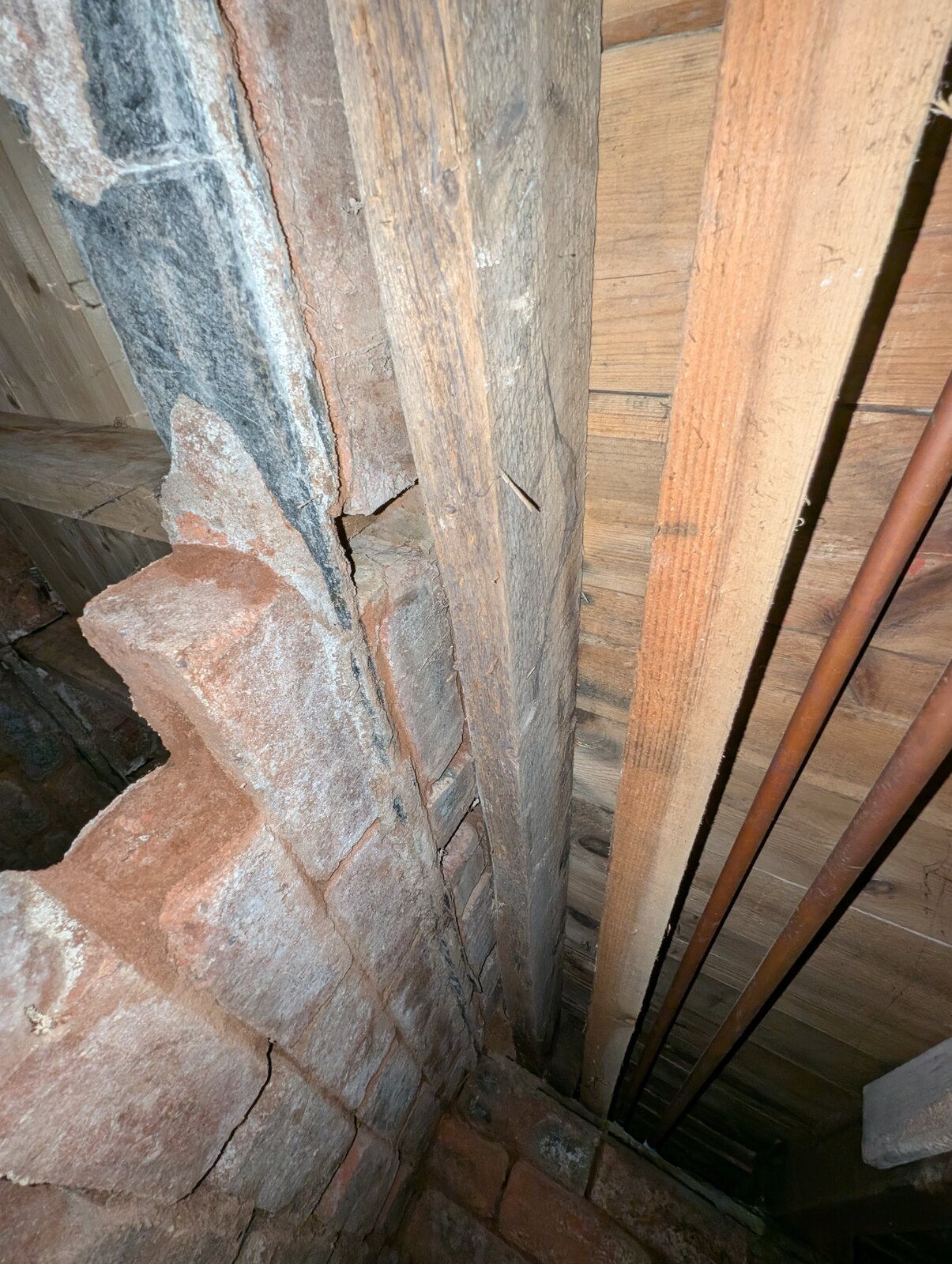

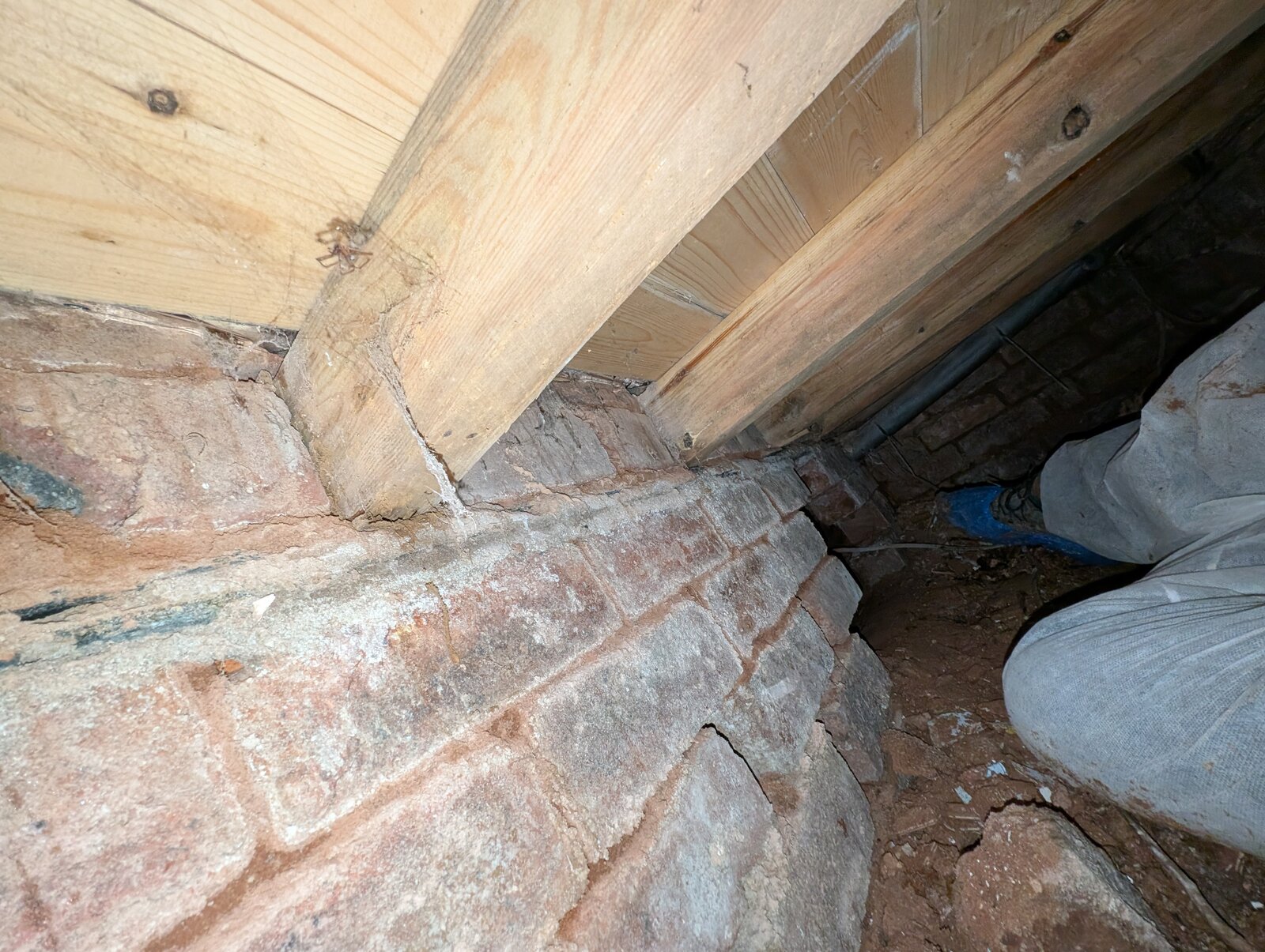

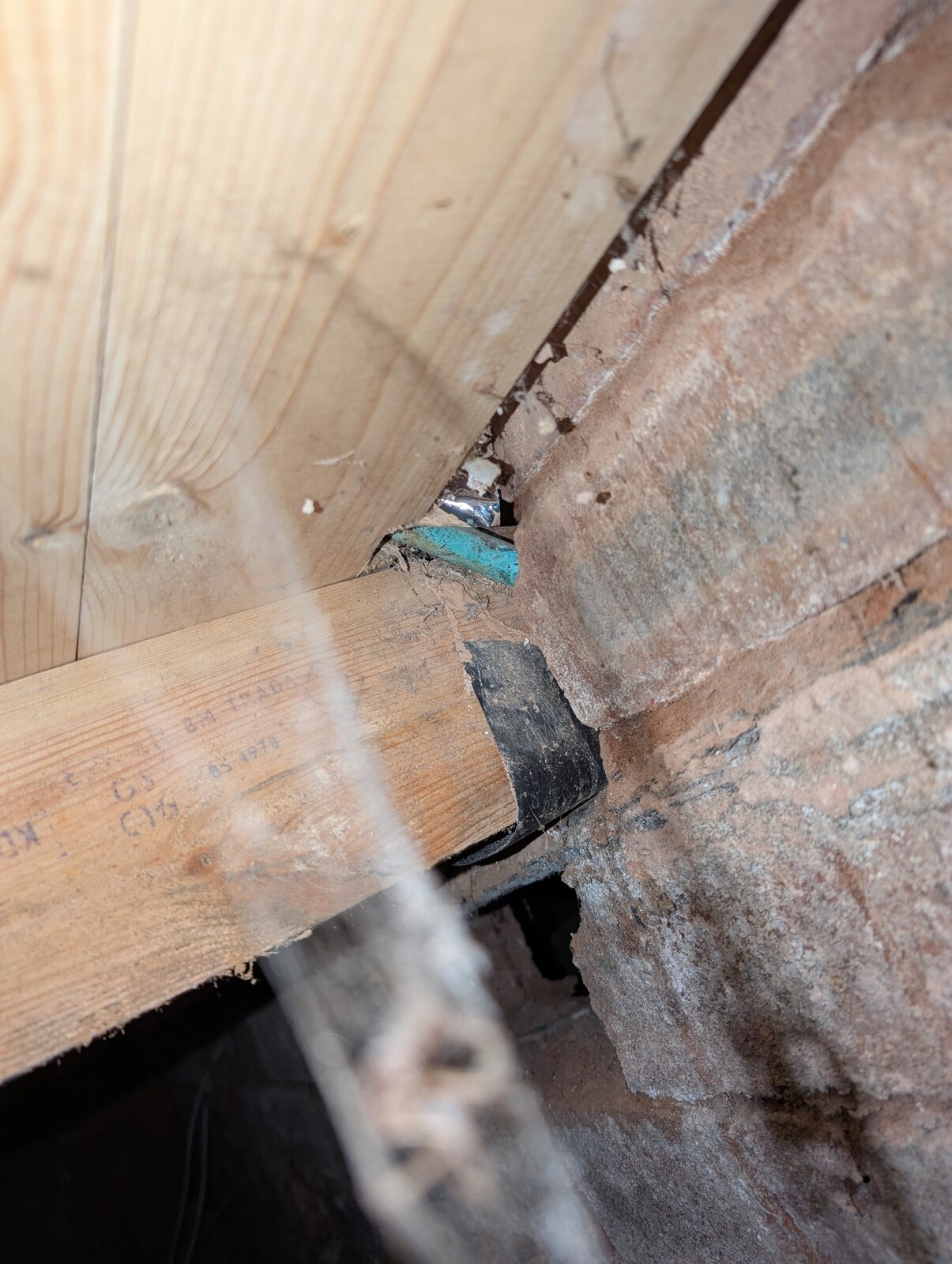

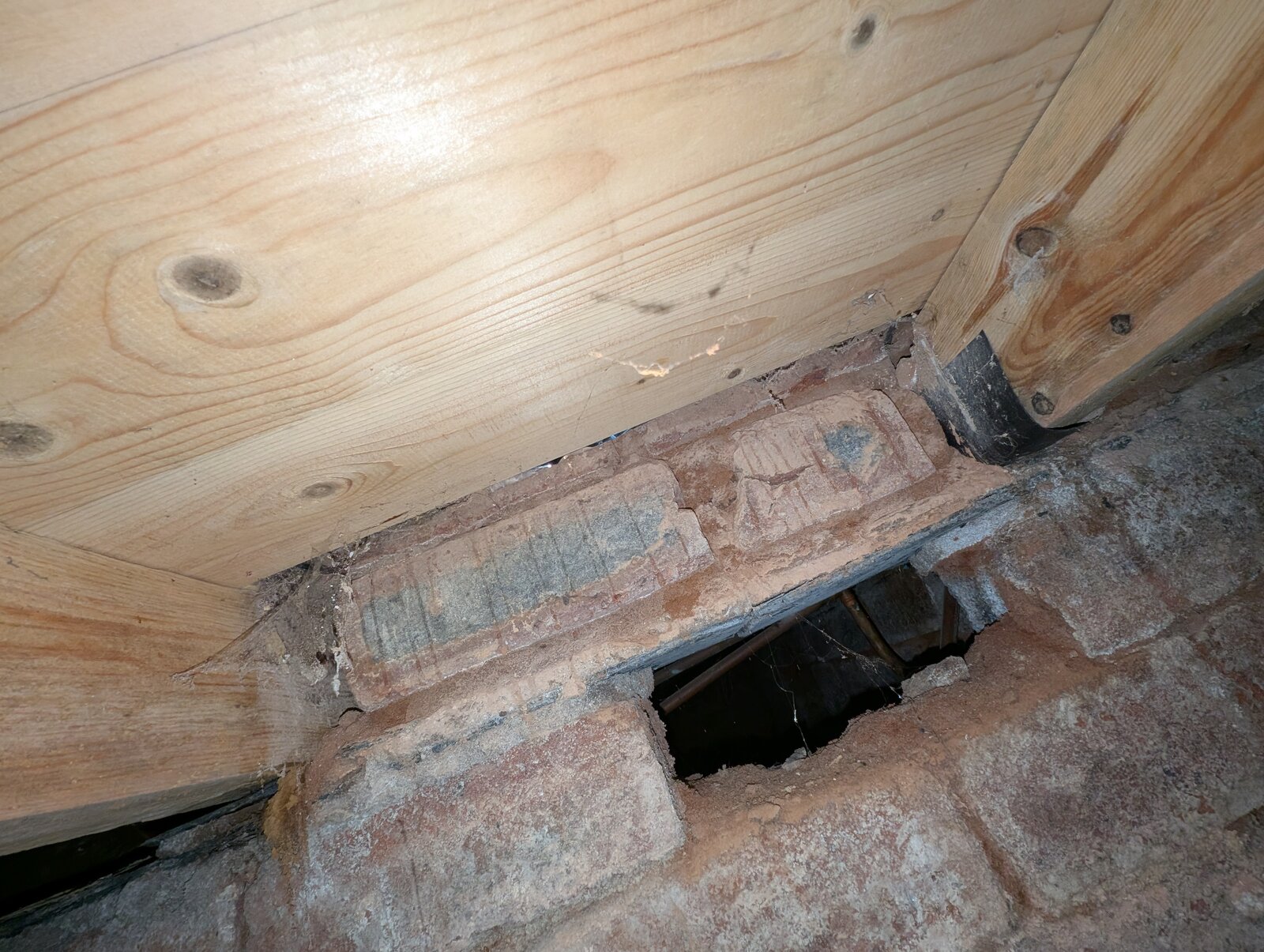

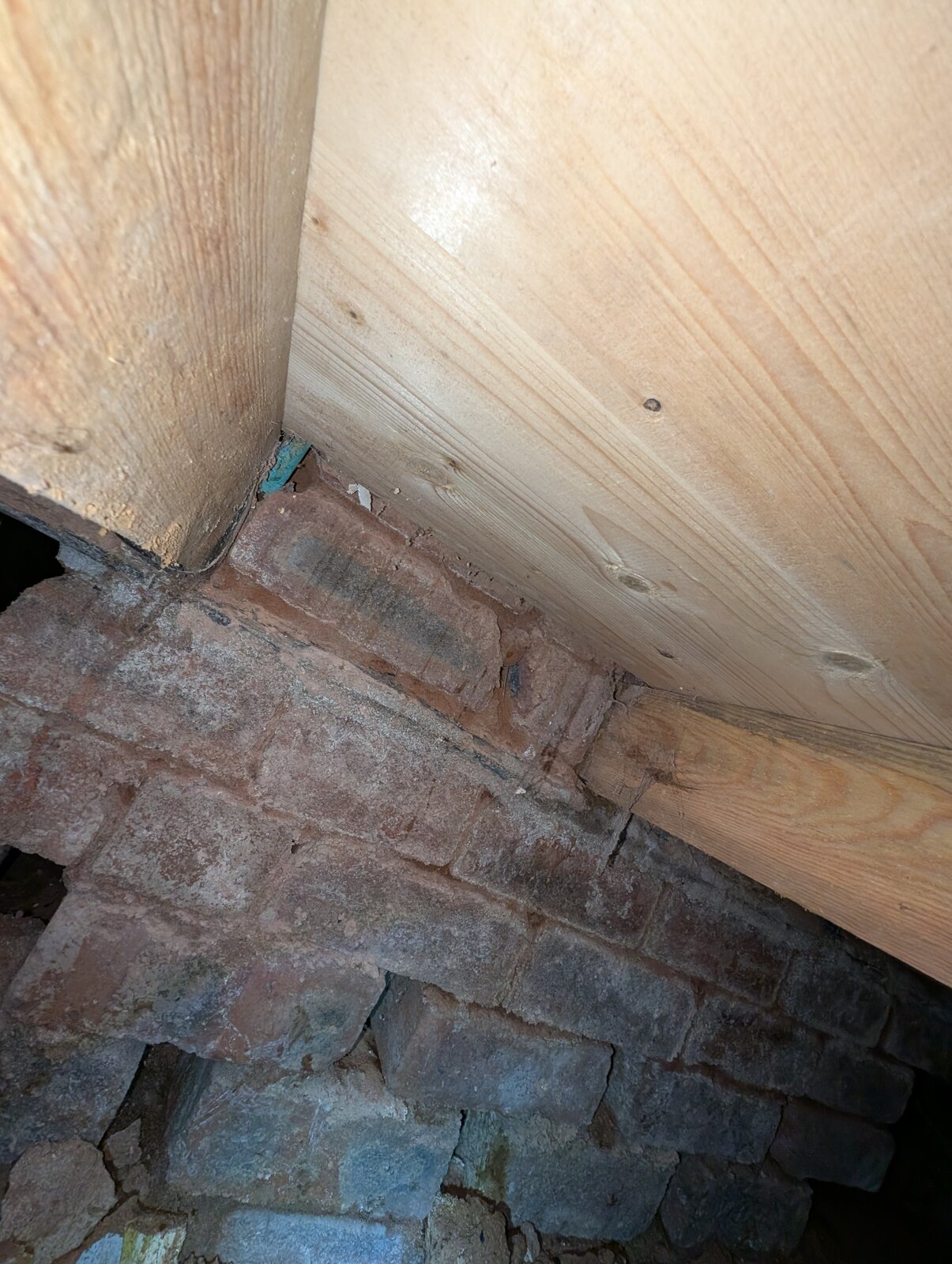

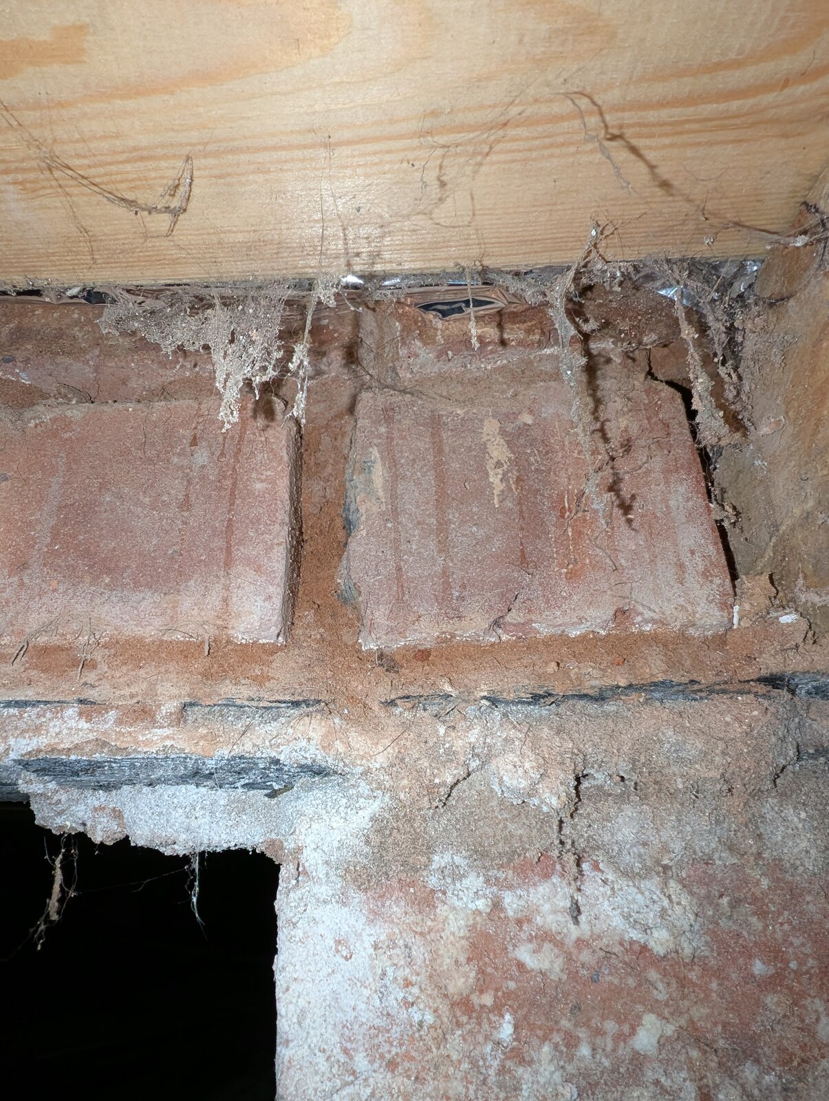

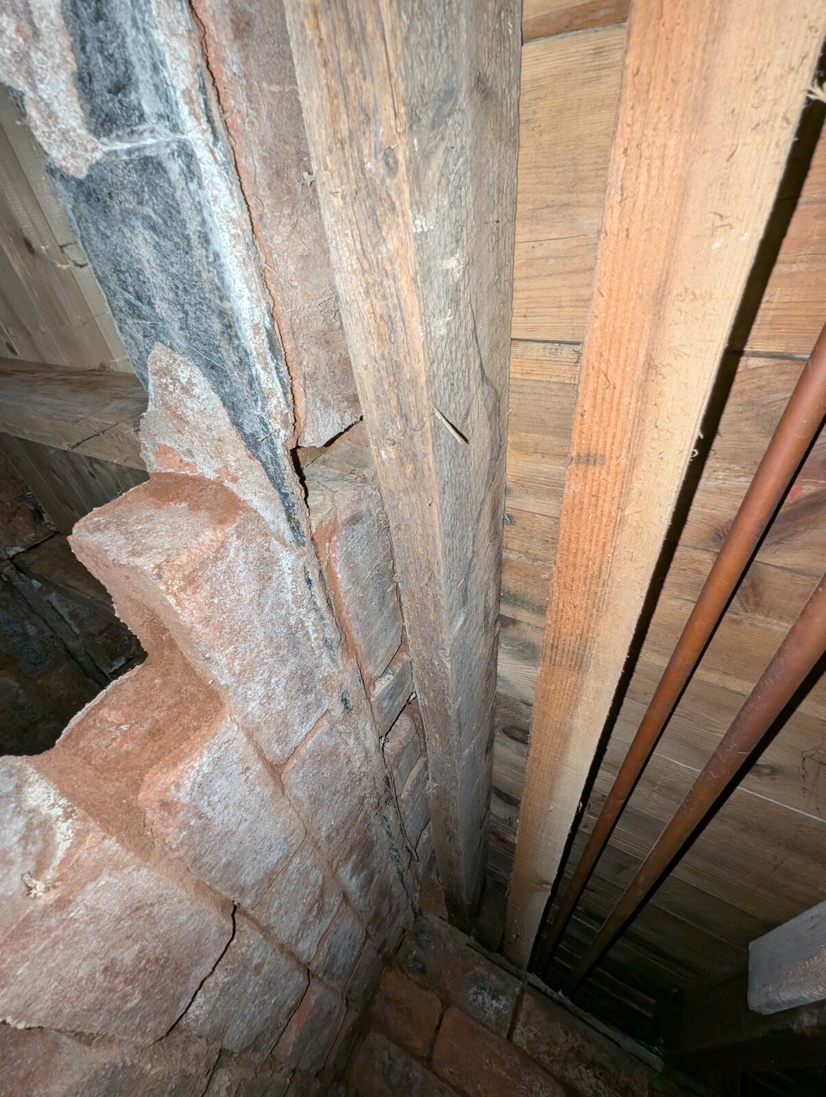

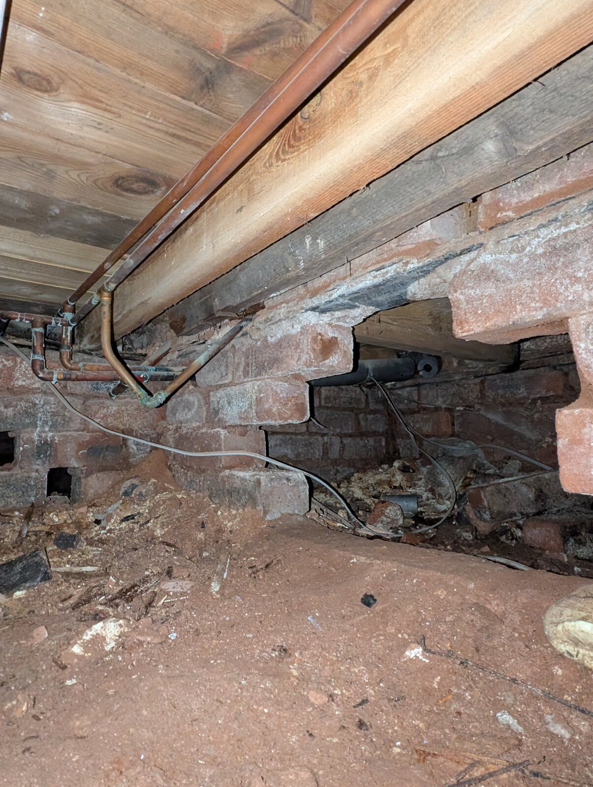

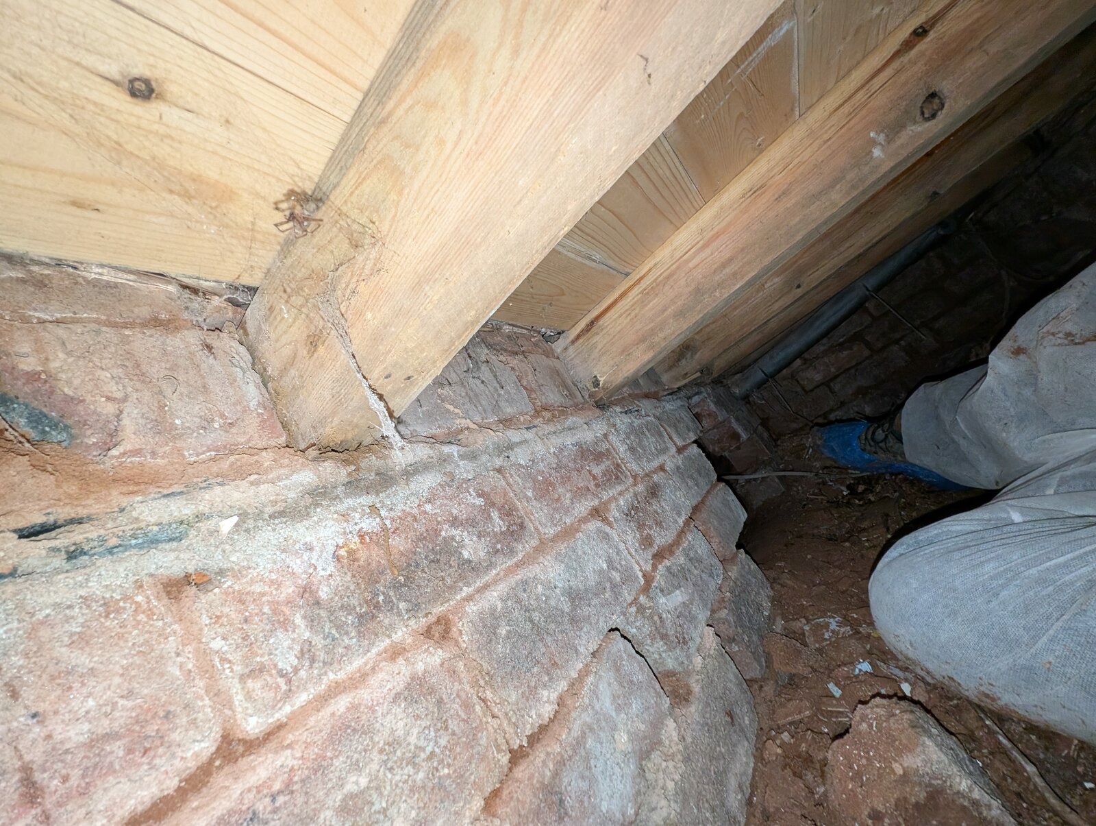

I'm a little averse currently to pulling up all floorboards. I went under the floor from the hole by the front of the house and looked around. The floor is damp but not particularly wet under most of it. The wall underneath the wet wall is pretty dry, although the wall above is also drying out.
Pipes show corrosion but couldn't see a leak although not sure how long water would stick around for on central heating pipes.

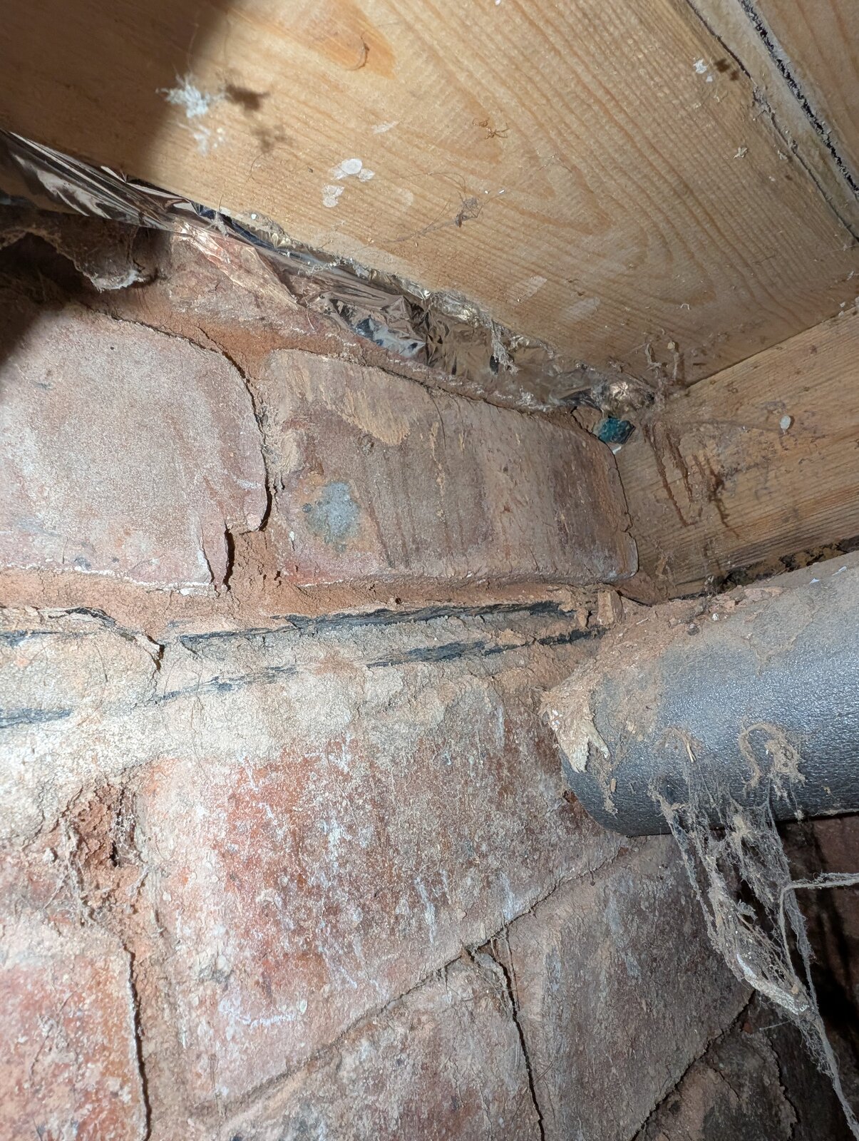

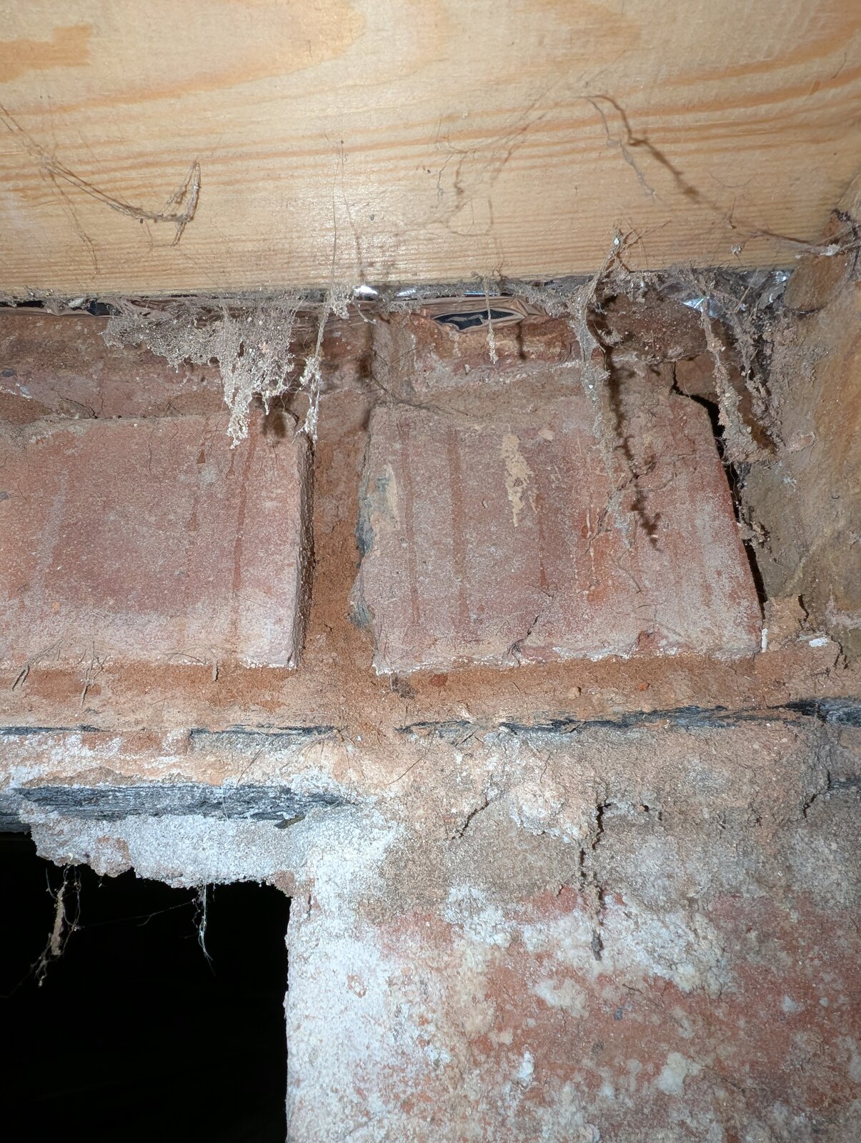

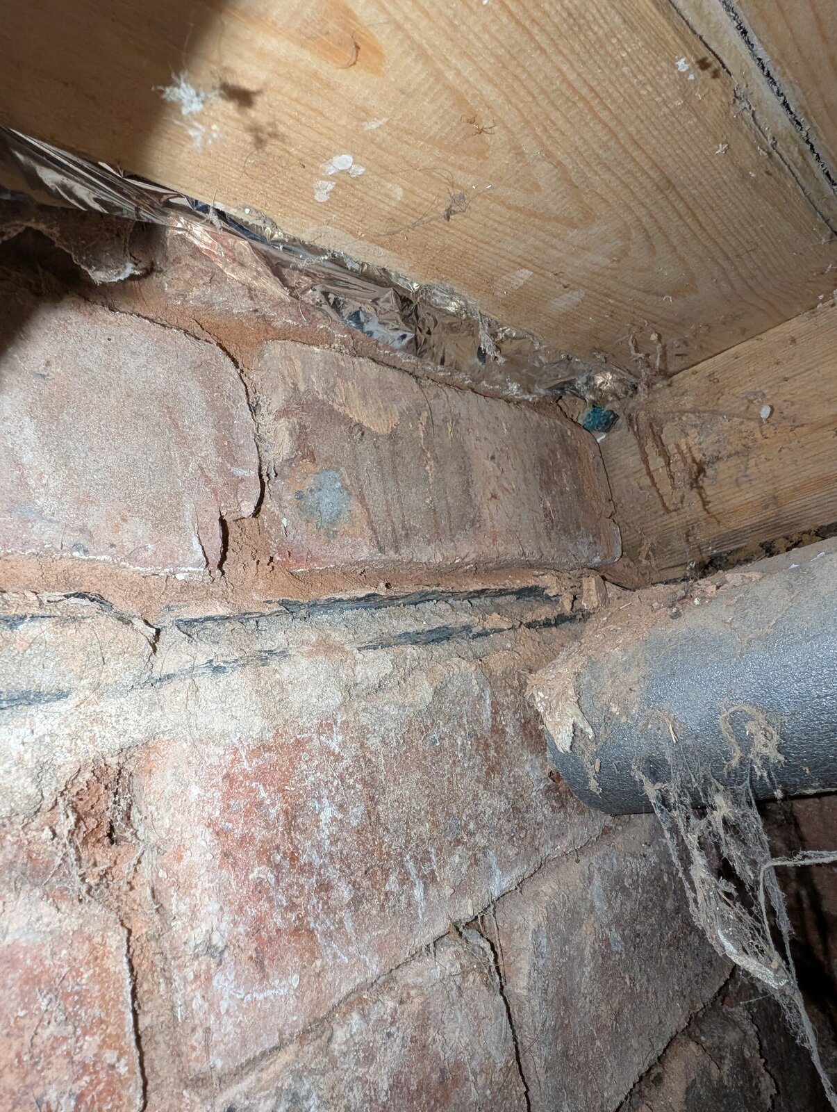

I noticed some drip marks on bricks. I wonder if it could condensation onto foil insulation which is in contact with plaster - not sure if far fetched.

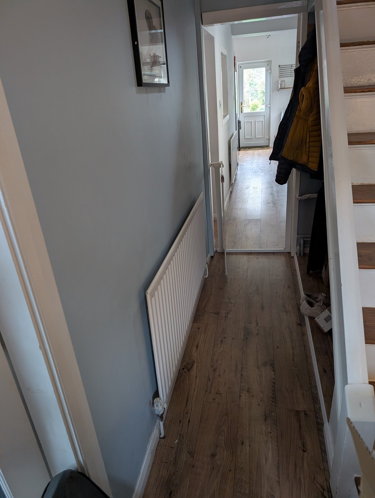

Attached some pics from either side of wet wall in case you can see anything I can't.
Edit: looking at it again the mortar seems quite wet also. Maybe it's poor drainage, flooded subfloor, high humidity, condensation against presumably cold foil, wet mortar above dpc, capillary action.

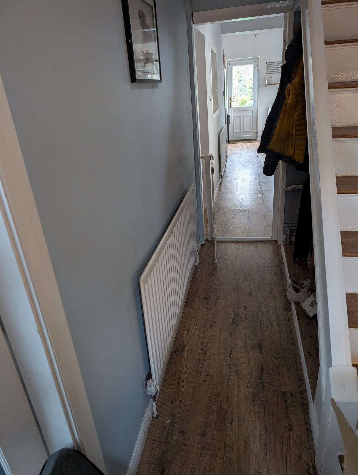

The wall on the other side of the wet wall has a radiator and a kitchen paint, which could explain the differential staining. Most of the drips appear on the radiator side which has foil underlay. The room on the other side of the wall has some sort of polystyrene style underlay.
Your damp course, is directly below those joists, your joists are actually resting on it. All the timber, in those photos, looks to be in absolutely great condition. In your first photo, the soil up to the wall looks fairly dry, but beyond that appear damp/moist.
You need to check, and ensure - all the soil outside, is well below that damp course level, and make sure no drains around that are leak free, and clear.
Looks unlikely to be from below from here.

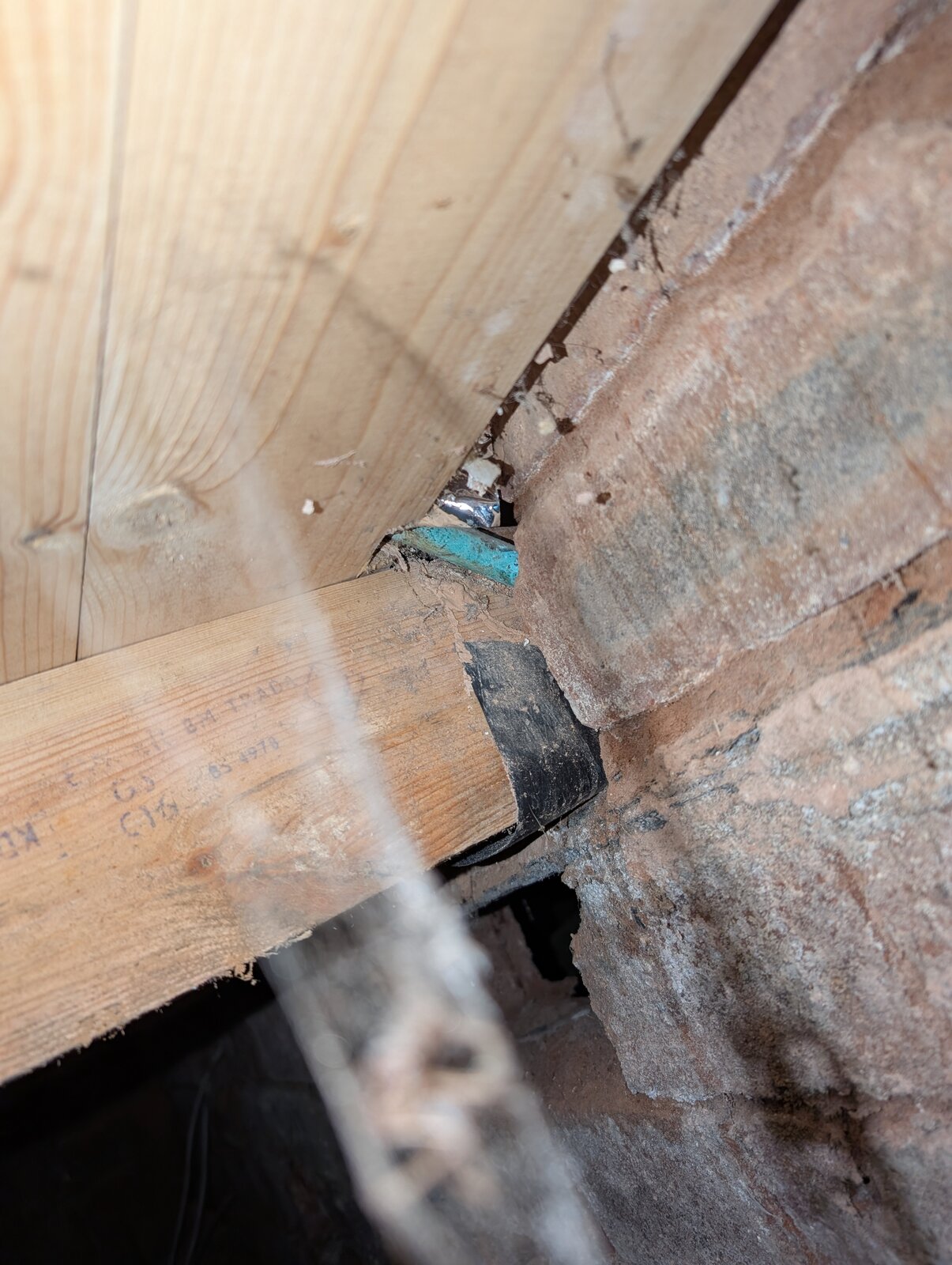

Could we have a look at the plumbing you mentioned on the other side of the wall?
I can see from below there's a couple of pipes vanishing mysteriously into the brickwork.
For clarification photos 1 and 8 are on wet patch side of wall, the remaining are from radiator side of wall.
I don't know if you mean plumbing side above ground but I have attached that.
The boiler is under the stairs. I think the ones going into the brick work are going to/from the boiler, with the blsck insulation in one of the pics. Just beyond the radiator there are pipes going upstairs in some sort of casing.
