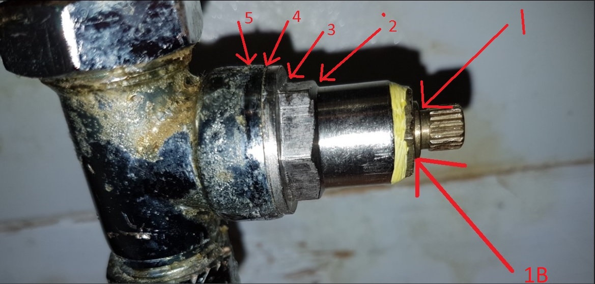

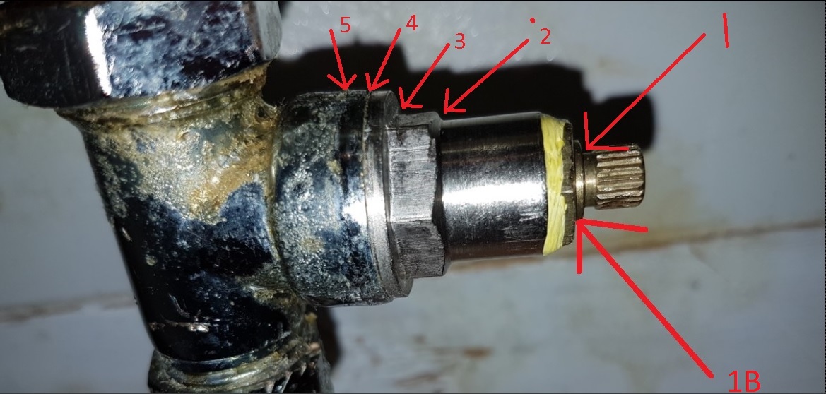

OK I am getting there. Please can youyou tell me which by the numbers on the pic, the areas where I need to add the tape? thanks.

Where you need the tape is not visible from the outside of the valve,it's inside the chrome body .when you take out the nut completely you will see down inside the chrome body ,and where the spindle disappears into the gland. That's where the PTFE tape needs to be .
OK thanks, yes when I take nut out totally, I can see inside the chrome body, just a empty area where and the area where the nut screws into. I can put my finger inside, which I did and it was a bit wet in there. Ill try and find a area where I can put the tape inside, but obviously can not wrap the tape around anything as its an inside area, but can poke the tape down inside where the nut goes into as far as the tape will go and then screw nut back in. Thanks.

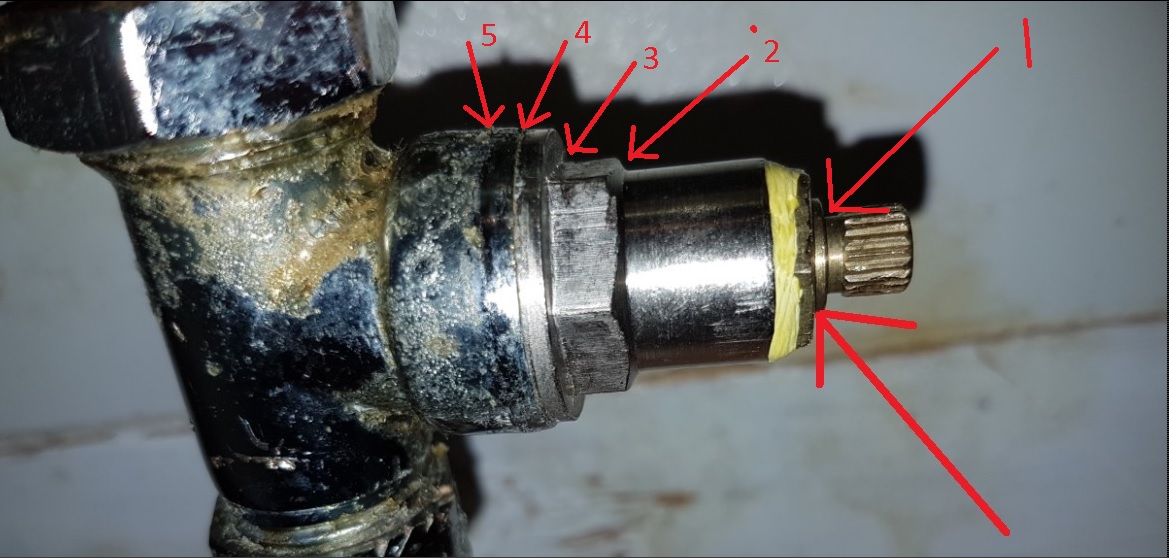

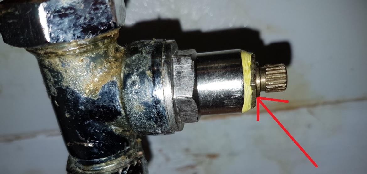

Well thought you were right, just about to get to bed and noticed it was leaking AGAIN. The leak is coming from point 1 and/or 1b on the pic. Wish there was a way to turn the thing off as never use that rad. But guess nothing I can do about it, have to fix the leak.
So do you think in my case the leak is from either
a)
Leaking from the Radiator Gland
b.
Leaking from the Radiator Spindle

I just had a tradesman out and he said that it needed a new valve fitted. He said the system will need to be drained via a radiator. Does he need to do something with all the radiators or check all the radiators in order to drain the system?
