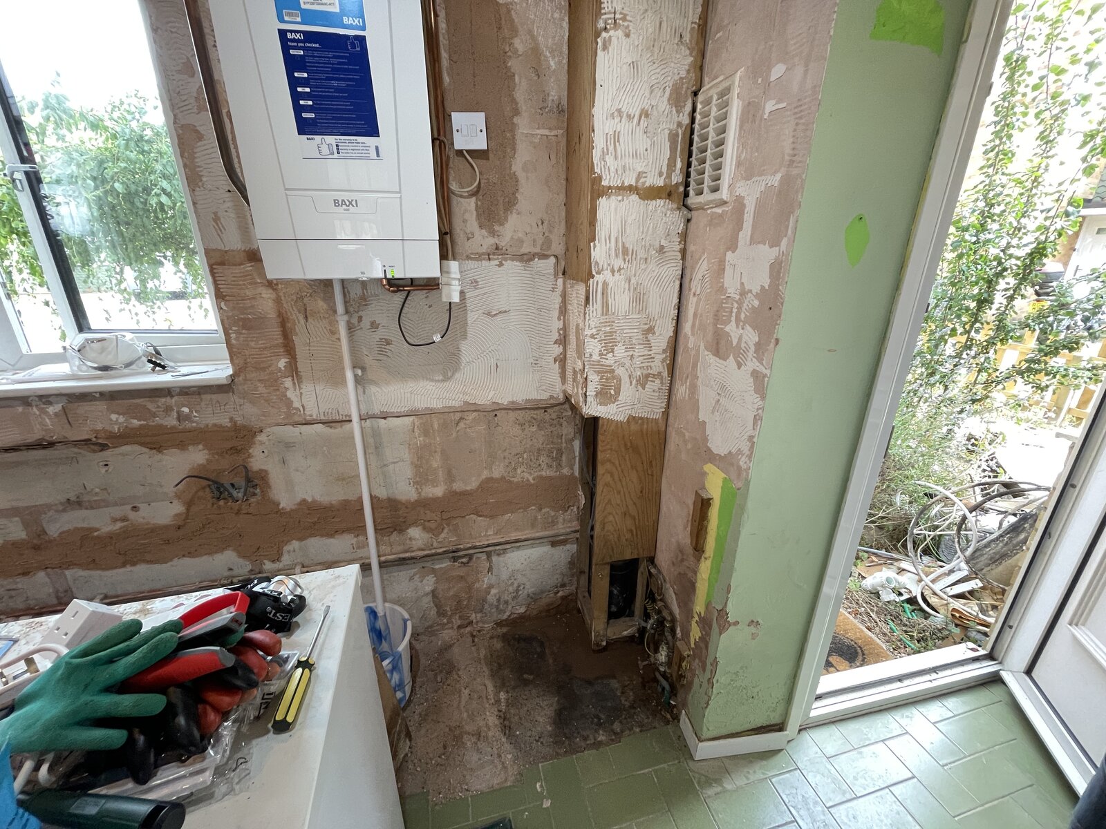

2 weekends ago we ripped out the old kitchen to prepare for a new one being fitted end of Aug, incl preparing a new floor, sorting out the electrics and re-skimming the walls. Upon pulling out a base unit I noticed a slightly damp patch on the floor beneath, but it dried up literally overnight so assumed it was due to something being trapped under the base unit and not allowing airflow.
Fast forward to yesterday, we were just working on getting some of the old tile adhesive off the walls and we noticed the damp patch was back in the same spot. Bare in mind this has been uncovered for the last 2 weeks, we’ve not noticed it before and is in plain sight as right by the front door.

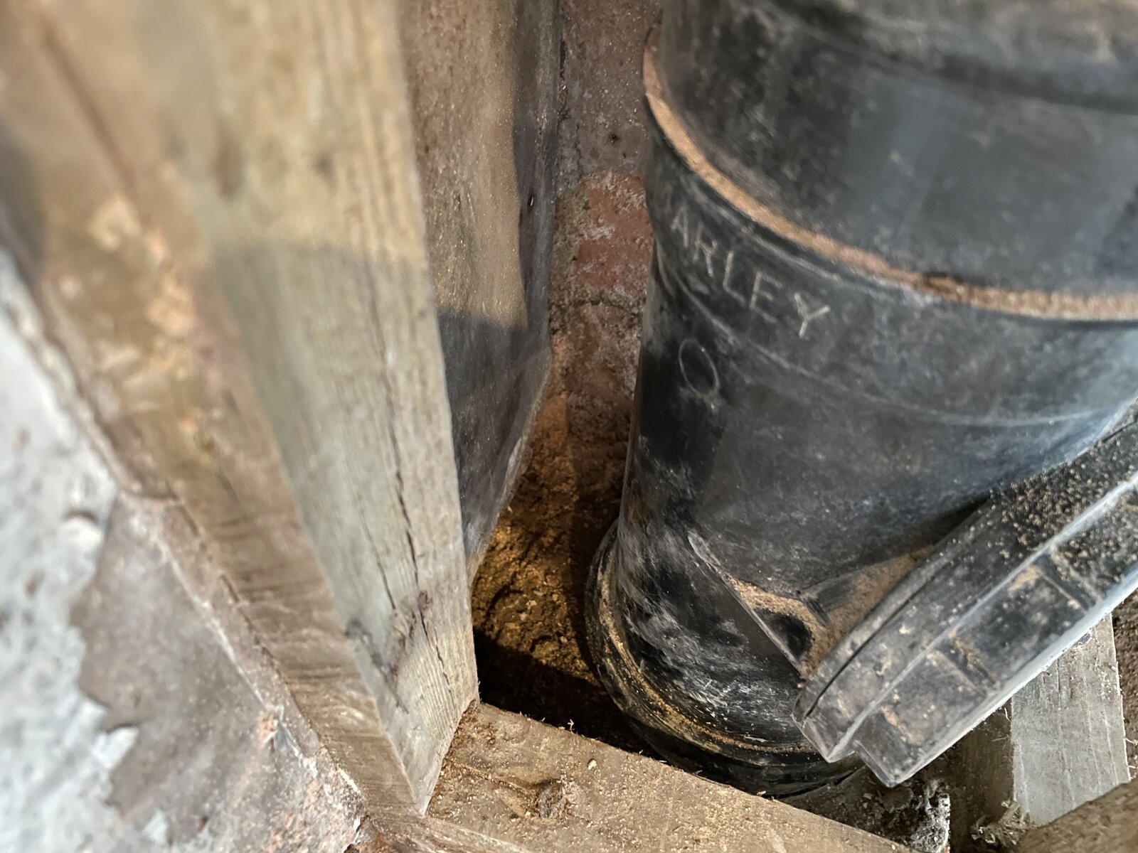

The waste pipe runs down this corner and is boxed in (typical of all houses on this street) so we removed the bottom panels to get a better look. The boxed in section was packed with old sponge and stuffing similar to what you’d get in a stuffed toy, and full of debris like newspaper strips/bits of wood/an old lipstick(?!) and just lots of dirt and build-up from goodness knows how many years. We cleared it all out and checked for a leak in the pipe by running the shower and sink taps, nothing showed up. It didn’t get any wetter.

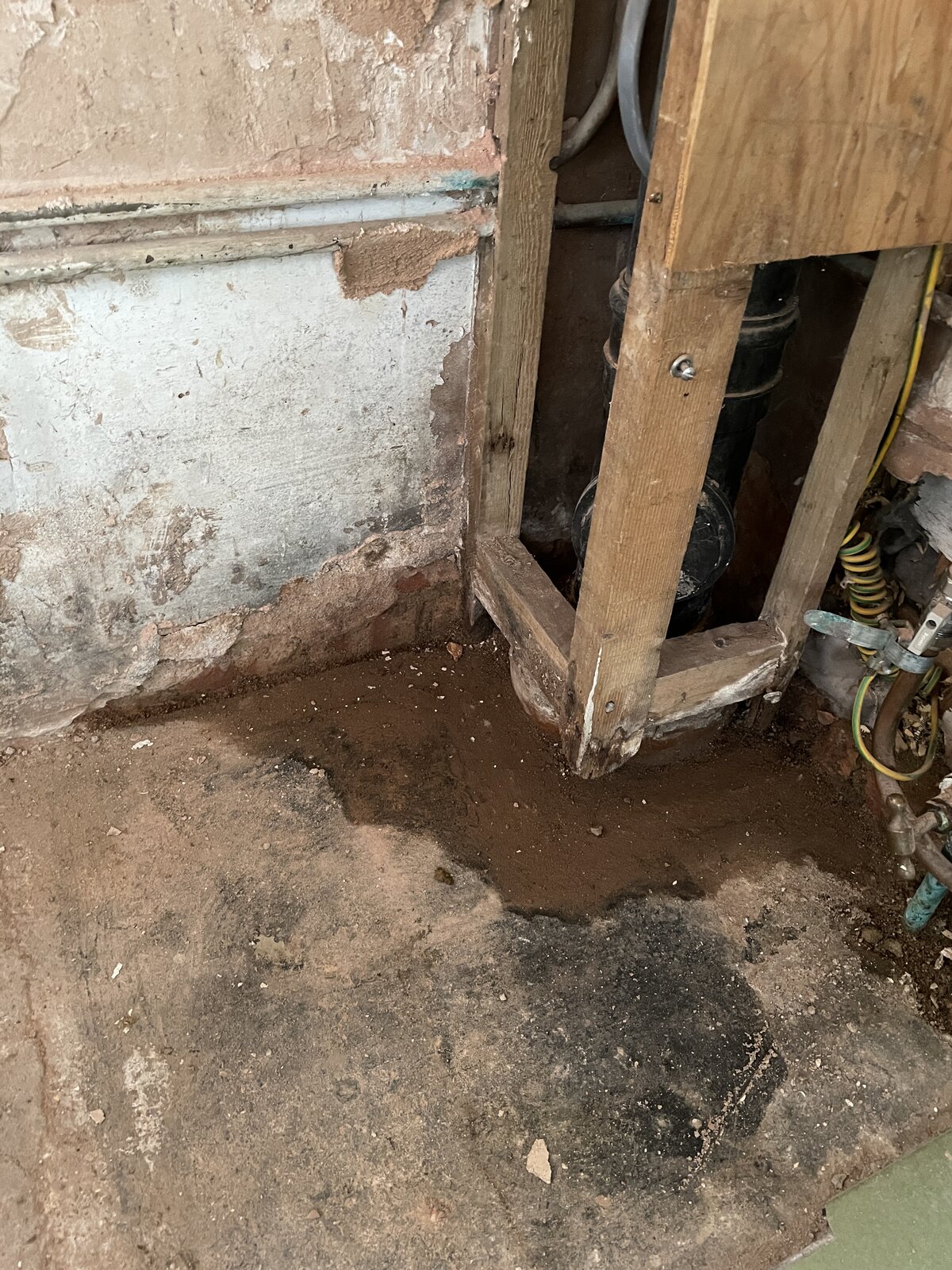

Taken yesterday after clearing out the debris:

This morning:

I can't see a cement collar. can you show me?
soil pipe comes in lengths, and each fits into a socket of the one below. Unless the pipe is blocked at the bottom, and full of water, I wouldn't expect a leak out of a socket.
Is the socket at the bottom brown fired clay, like an old brown teapot?
the pointing may have been eroded by long-term leakage, though I only remember seeing that on old houses with lime mortar.

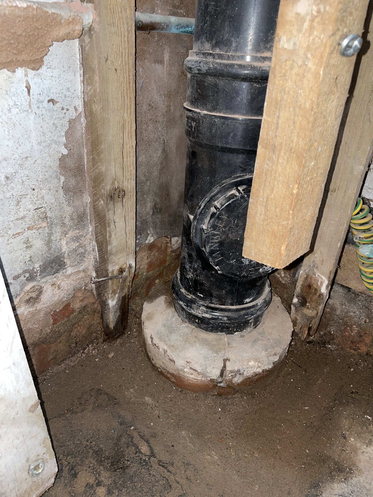

Here it is - think it was obscured by the wooden frame in the original pics. I can’t get a clear photo but there is a crack at the back in the cement (?) where that darker damp patch is showing. Currently airing it out by keeping the window and door wide open so it has dried off considerably already.
ah yes, that is the socket of a salt-glazed clay pipe
mind you don't crack it. I think it may already have a crack, facing the camera, which may continue under the floor. I suppose you could put your hand throught the access point and have a feel or squirt a hosepipe and see if it leaks out.
it has evidently been leaking for a long time.
you may be able to scrape the mortar out.
the joint is fundamentally inflexible and has no give in it to accomodate movement due to expansion or settlement. It would be quite difficult to repair, being in an internal corner and set in concrete. I am a DIYer and have done several outdoor ones, and a couple set in a floor with enough working room to excavate. The outdoor ones are much easier. If it is only the socket you can get a plastic repair piece that slides down into the old pipe, and the plastic pipe above fits into it

I think the water is on the wall behind the pipe, and is soaking into the socket where it touches.
This would be a leak above.
See how the damp level is much higher on the plaster behind the pipe.
Strip off more of the duct box for a better look.
