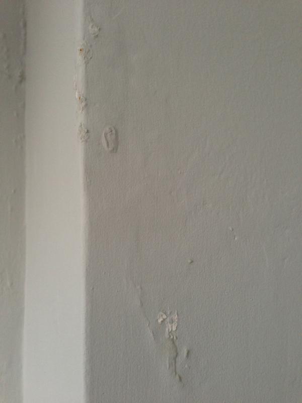

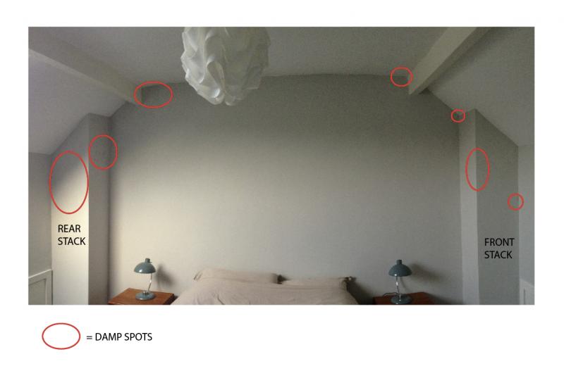

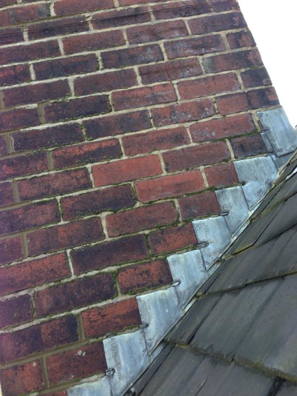

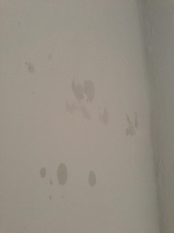

We bought our first house last year and after living in it for a few months (since September) I have noticed some strange damp spots on and around the chimney breast in the top bedroom. The house is 1902 terrace and the bedroom with damp patched is on the top/3rd floor. There are various patches which I think are down to various reasons. We had the roof patched up with broken slates replaced and the chimney stack re-pointed so i'm as confident as I can be that the roof is sound. I have uploaded a few pictures so you can see where the damp patches are forming and what they look like close up. As you can see they are fairly spread out. I am not so concerned about the ones next the ceiling as I think these are down to a bit of re-pointing that needs doing on the outside wall above the neighbours roof.
The patches which i'm not sure about are the ones on the chimney breast. As you can see from the pictures, some look quite different to others, and have only become a problem since around christmas time just after I re-painted the walls.
Neither of the chimneys are currently used . The one at the front of the house (on the right) has had the fireplace removed and blocked off. The one at the back of the house has been temporarily blocked up as we had an old gas fire removed but couldn't afford to put another one in.

It's possible the patches are caused by hygroscopic salts deposited in the brickwork. These are the byproducts of combustion. They frequently cause water vapour in the atmosphere to condense and can be confused with penetrating dampness

Thanks for the reply. It could be possible, I'm just not sure why it didn't show up before... Maybe the light grey paint highlights the problem more???
Is there any way to get rid of it or at least cover it up?

4. Suggest that you post pics of the exterior brickwork and flashing - and the two c/stacks.

Thanks for the response. I've done as you suggested and updated the album with pictures of each exterior stack, and every room that has a chimney breast in it.

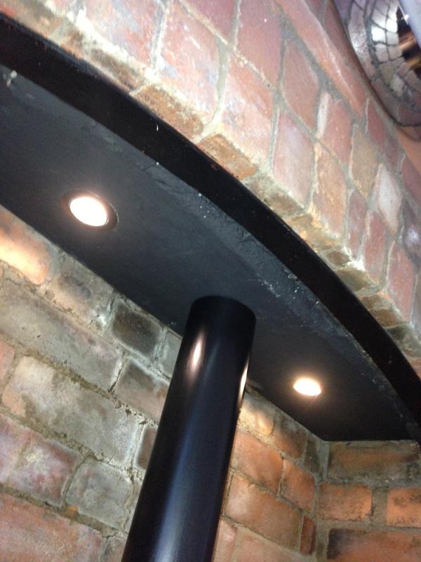

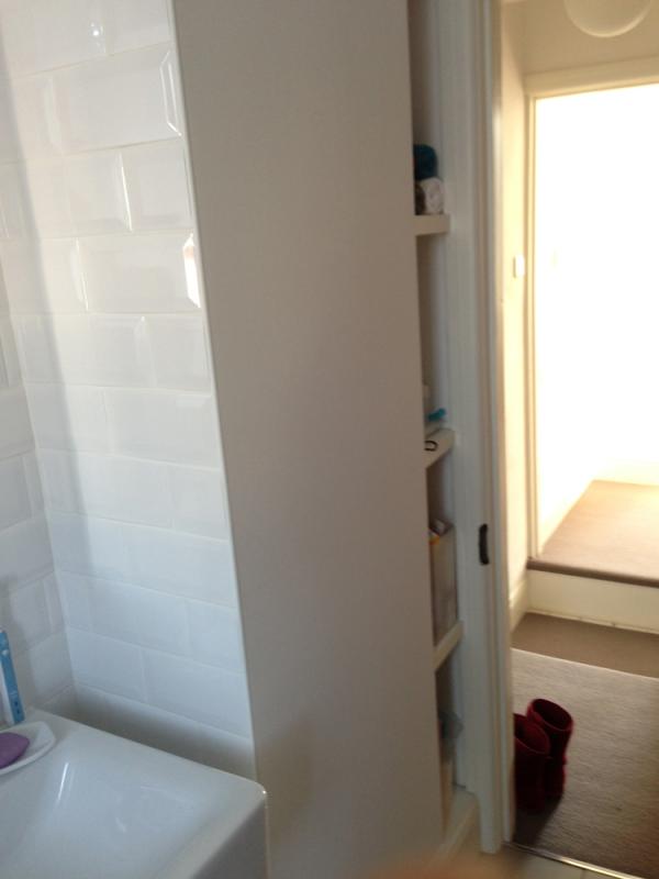

1. half of the rear chimney breast has been removed in the bathroom as the room is very small. It was done before we moved in and has a gas flu liner in it.

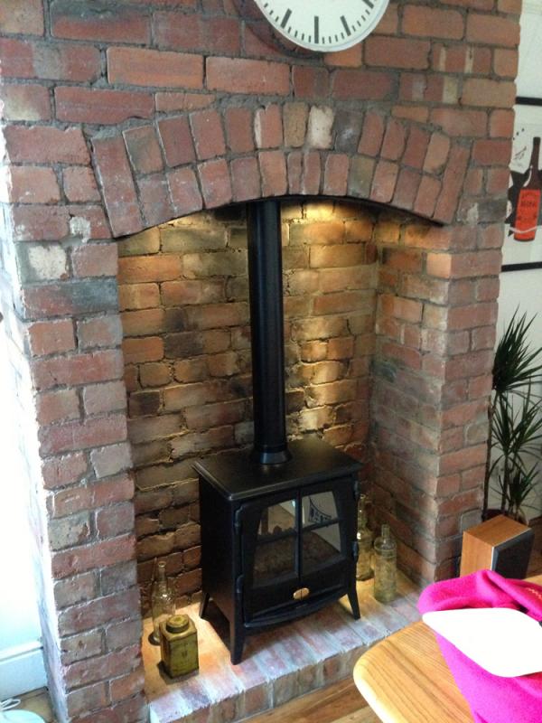

2. There is a free standing electric fire currently in the fireplace as we couldn't afford to install a real one so the chimney has been blocked up to stop dirt falling down it. I made a dummy flu out of a soil pipe (un-used!) which literally stands on the fire to make it look more realistic!

1. I'd suggest that you have sulpherisation in the chimney breast flues - ie. chemical reactions of old soot and fresh moisture "eating" it's way thro the brickwork and plaster to the surface where it attracts moisture from the air. This is not condensation.

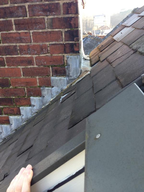

2. I'd also suggest, that you have minor leaks at the back gutters and slightly up the slating - slipping, replacement and split slates. This leaking is showing near to the purlins. Can you get a view in the "loft" space, look for leaks, stains and underslate felt.
Is the lower roof your neighbour's? There's some step flashings missing.
3. The flaunching appears to be loose and it's probably allowing moisture into the flues to feed the sulpherisation. Plus the pointing is failing.
4. Do you know how the chopped off c/breasts are supported?
5. Is the black stove pipe in pics 8 and 9 false?
6. Pic 4 requires a vent in the c/breast.

9. Suggest that the roof at the stacks and flaunching and flashings be inspected from a roof ladder.

10. Knock off all plaster to the bedroom c/breasts and render in a lime and sand mix, with a board or remedial finish. No tanking req'd.

13. Redundant flues require venting - top and bottom.
14. All your flues are redundant then?
