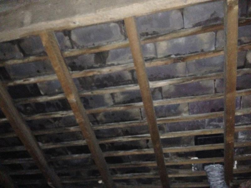

I can access the loft space either side of the bedroom through traps, but there is no trap to access the flat roof above. This is something I plan to do. The mould occurs on the wooden joists in the loft space I can access. I am planning to have some air vents fitted to the roof this year to help the black mould problem.
Because of the age of the roof, there is no insulation/kingspan or felt directly below the slates in the roof joists. All the insulation runs along the 'floor/ceiling' joists. The insulation has been topped up to the recommended depth. I've attached a pic so you can see what I mean.

Your loft is going mouldy due to warm moist air from the house getting into it. There is ventilation between the slates so you must be pumping mega water vapour into your house. Another vent or two won't help.
That same water vapour is getting into your chimney and condensing in there too - and finding its way back into the house through the mortar joints of the chimney.
Only you know what you are doing wrong. Probably drying clothes on the radiator.

1. Things become much clearer. You do indeed have condensation below the slates, but this has nothing to do with what is occurring on your c/breasts.
2. I take it that the flex ducting for the bathroom extractor is the flex in the pic? Is that daylight around the ext terminal flashing?
3. As advised above, no roof void air vents are necessary. For the time being, you want to seal the roof void off from any air escaping from below, make it drum tight.
4. Ignore the mouldy rafters and laths for now.
