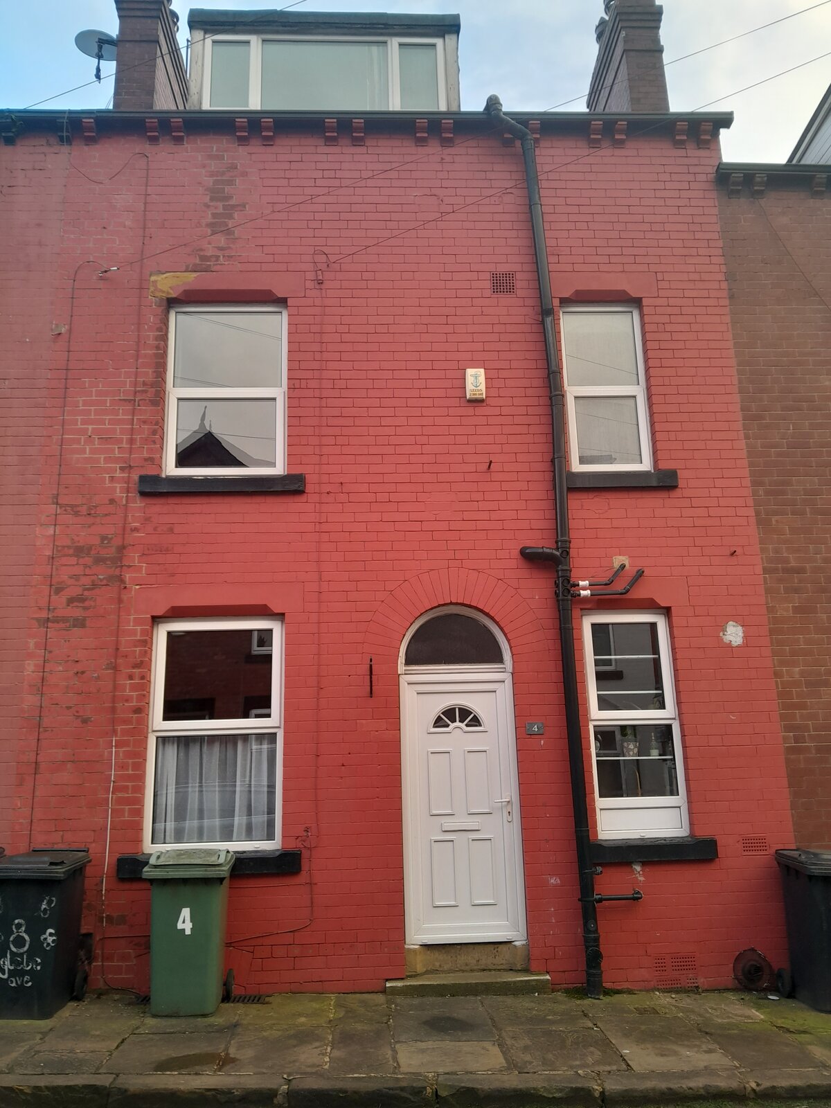

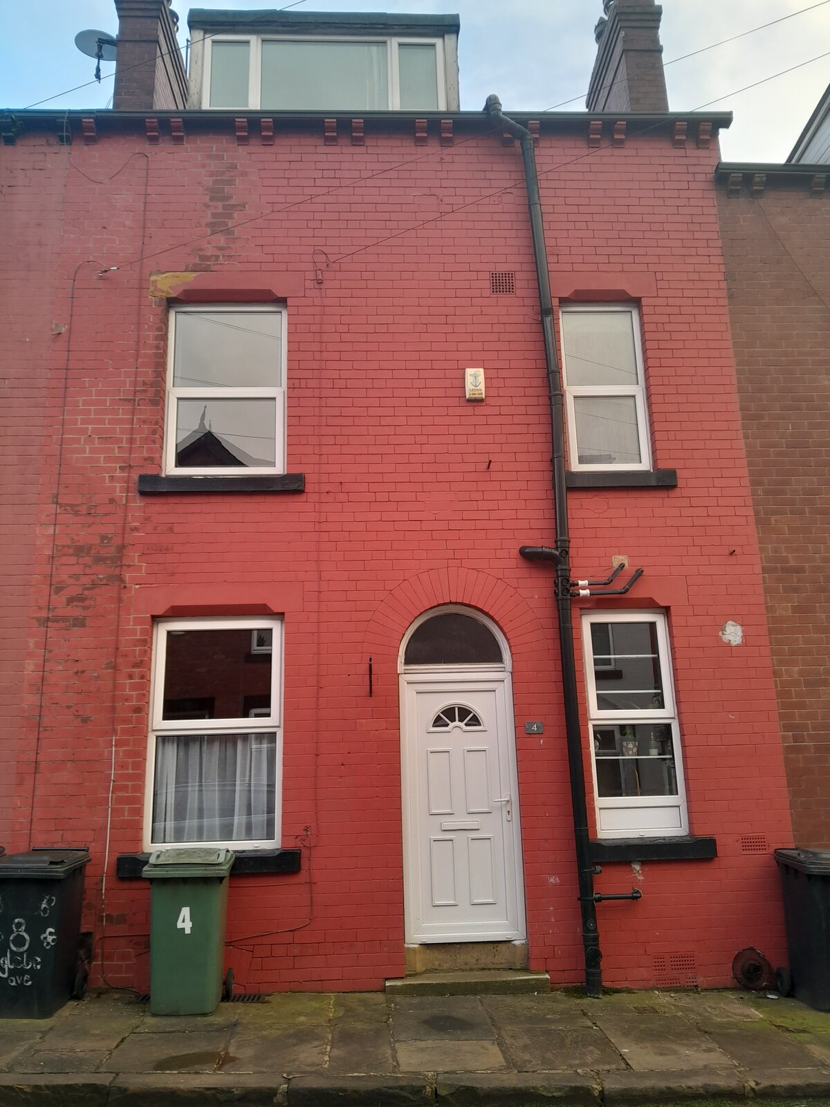

Identify the source of damp and cause of its its retention, and remedy that before removing and reapplying paint and pointing. Can you post pics of the outside wall generally, and any specific areas of damp outside and in.

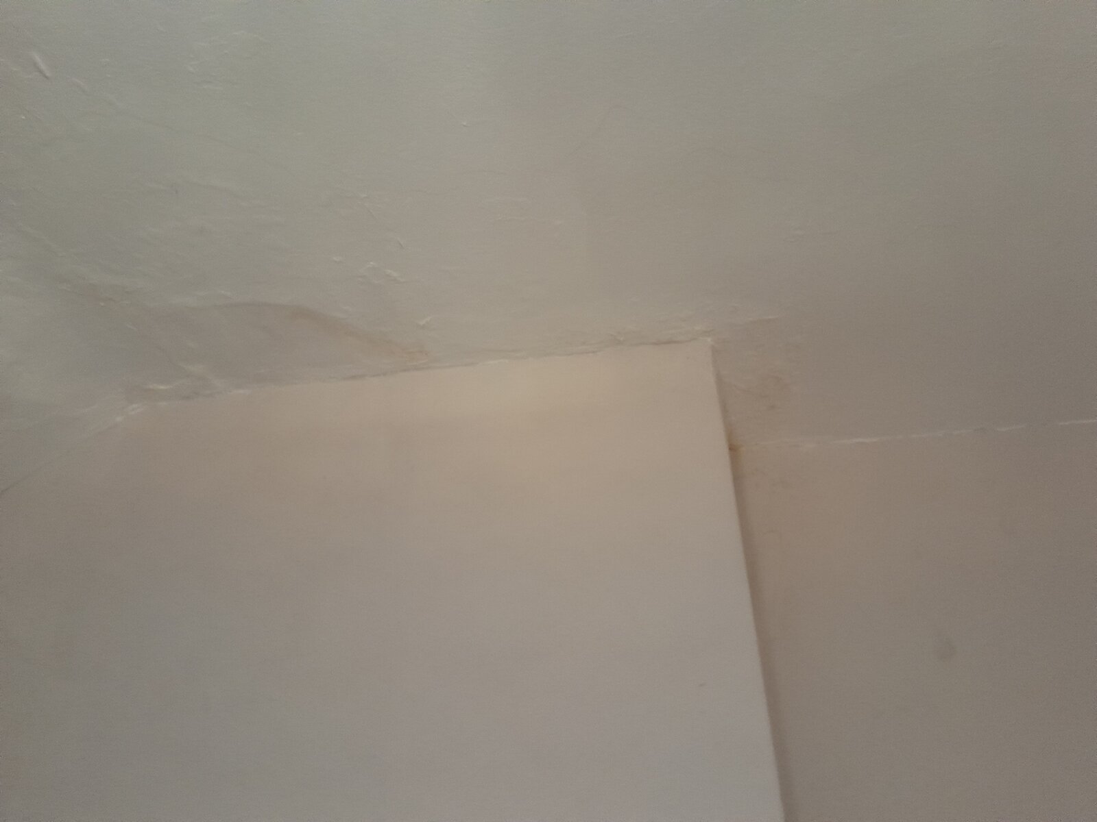

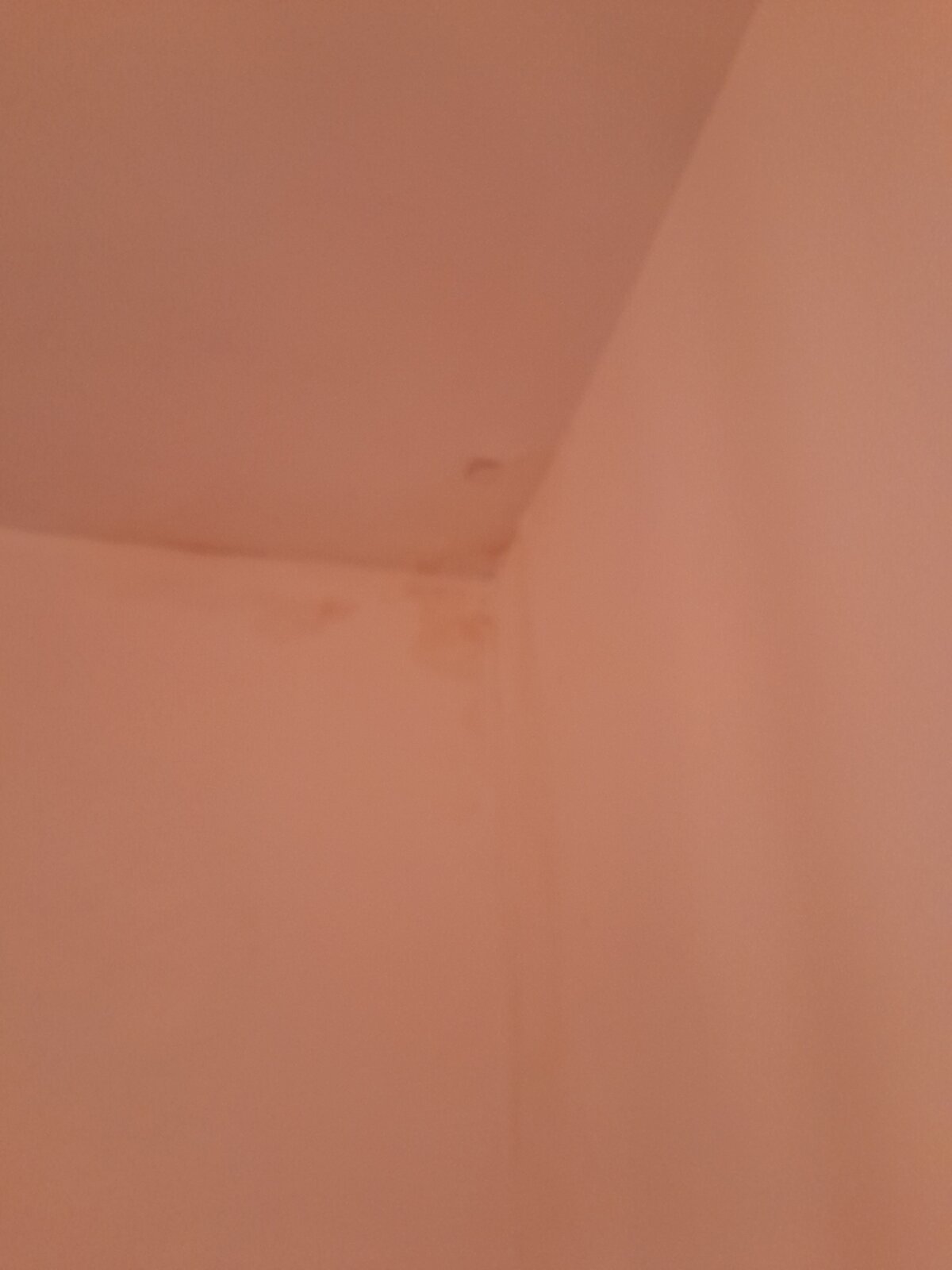

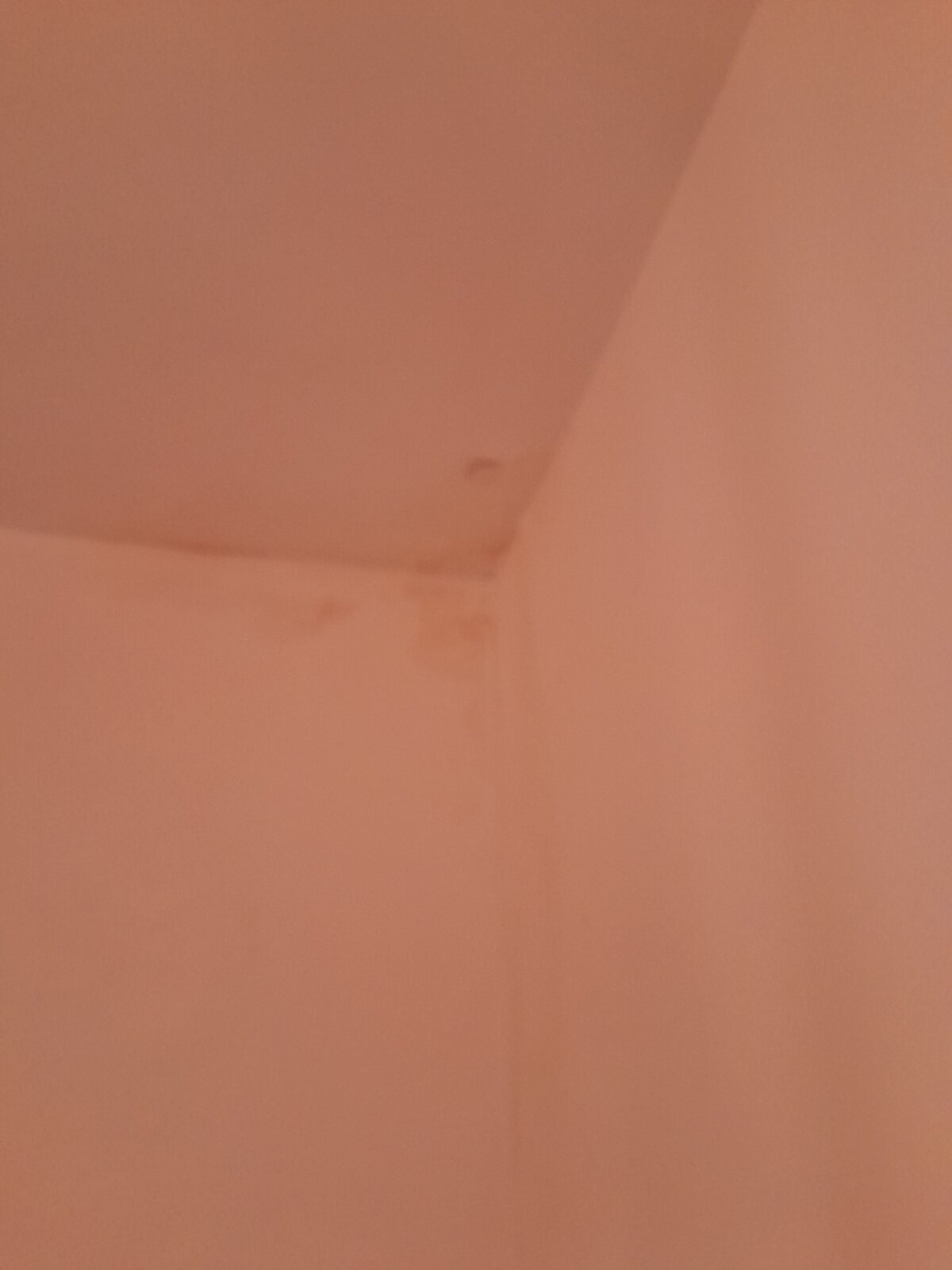

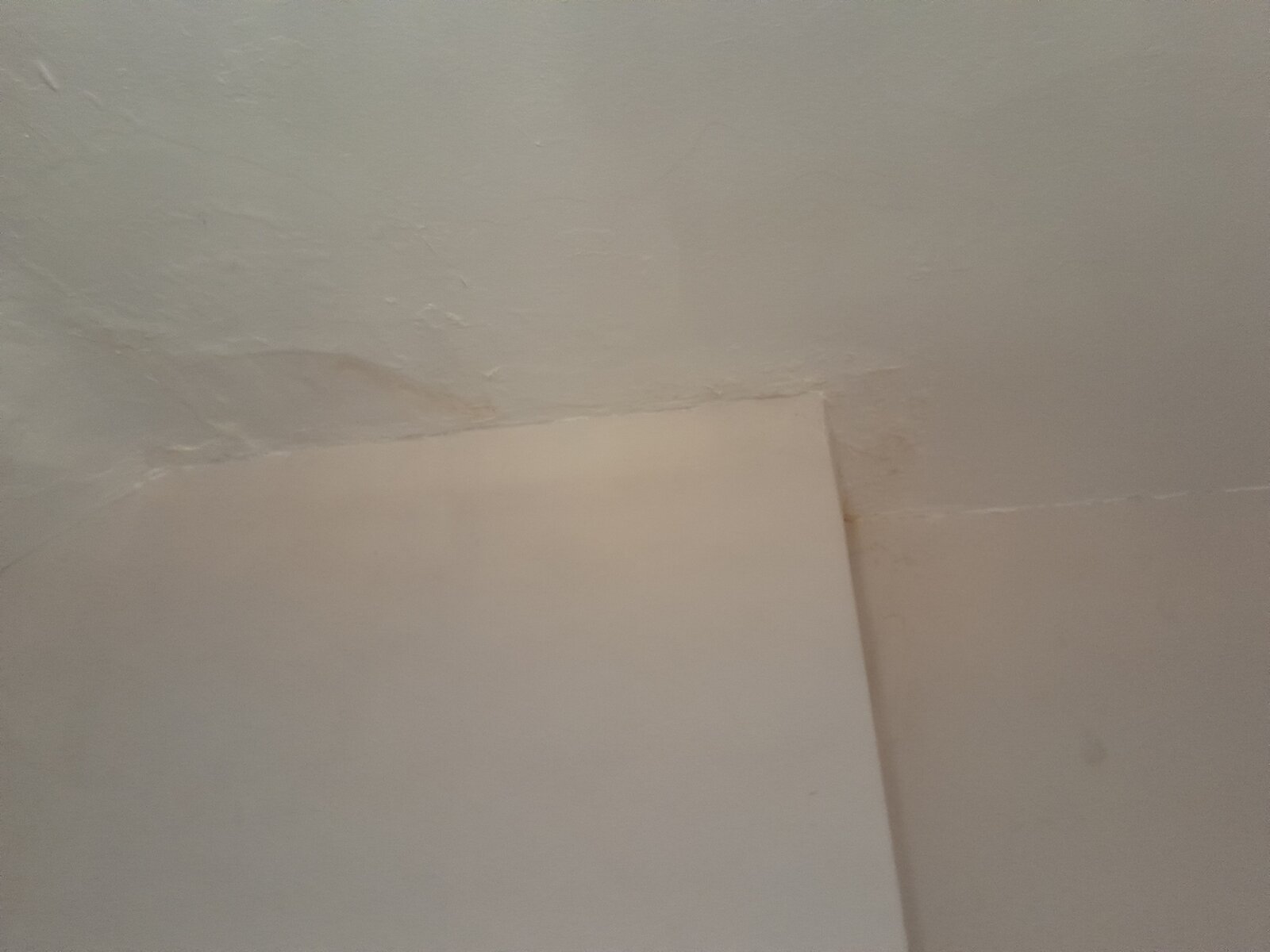

Thanks for the responses. The problem in the walls is probably related to the faded brick in the picture, the insides don't show up so well in pictures. The other two pictures are the ceiling around the flashing, it's yellowing but not that visible.
It sounds like neither of you think stripping the pain will be an issue. Wouldn't chemicals used to strip the paint be an issue for passers-by?
