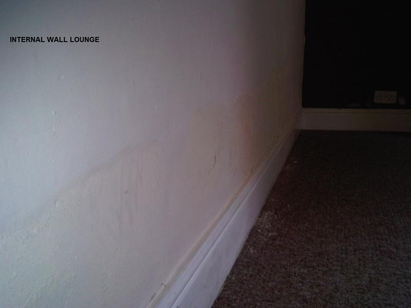

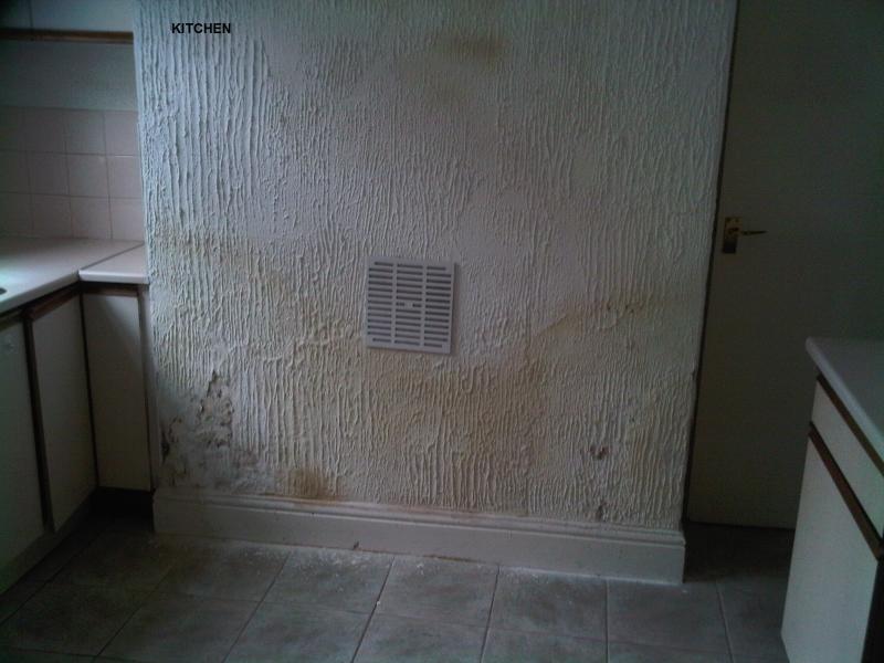

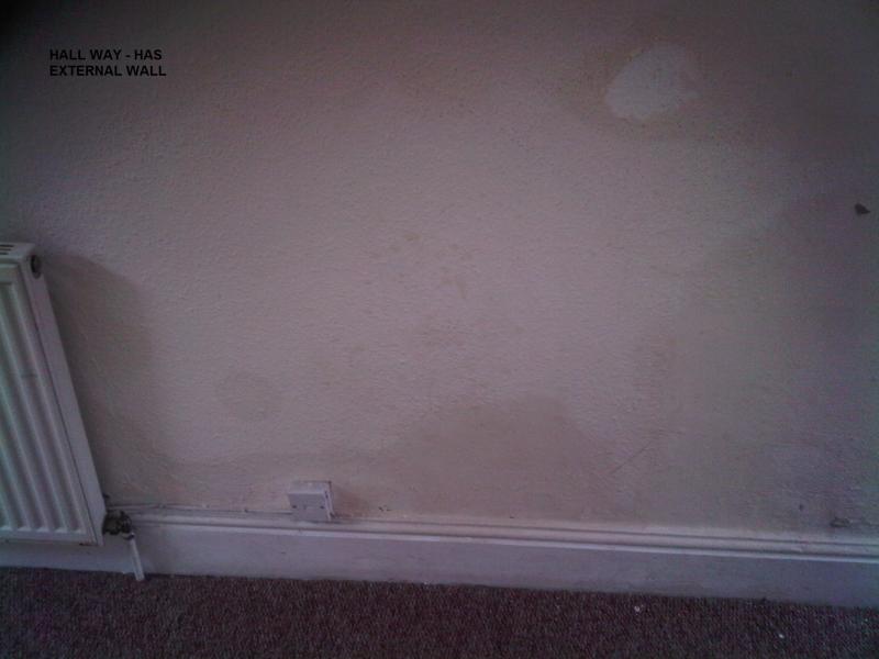

Guys, whats happing with the walls on this house,
some are external others are internal.
They all look like damp patches.
is it rising damp ?
rising damp normally only goes up to 1.2M high (above ground level) by capilary action... anything higher than that and it's most likely another cause i.e. breach of the cavity, leaking downcomer, defective pointing etc...
It's difficult to tell from the pics as there is no scale...

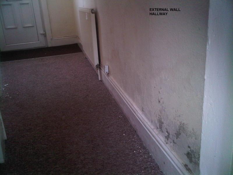

The damp patches are around 0.6 meters in height.
The internal wall has a storage cellar underneath.
The wall looks dry to me.
I cant see any crystal or salt like deposits.
The external hallway damp is happeing because a garage is next door with a gap, I am sure the water is running down the side and hanging around at the bottom.
What do you mean, breach of cavity?

The only way you can accurately determine the moisture content of a wall is by using a meter. If you are going to pay for the work to be done any reputable company will normally come out and test all of the woodwork and walls in the effected area.
I'd suggest tackling this first.
As you didn't say what type of walls you have I've made the assumption that it is a property with cavity walls. If something crosses the cavity it can transfer water from the outer wall to the inner wall
Actually- rising damp is a myth. Controlled tests over the years have proven it.
There is ALWAYS another reason for damp on walls . Usually lack of adequate ventilation.
I notice the ex chimney breast is affected. I see a little vent -which is useless.
Vent should be on outside wall -not inside. Check the chimney is capped correctly and flashing is good.
Also- have you had cavity wall ties installed recently ?. The cowboys who do this do not know how to correctly drill through the outer skin and into the internal wall to accomodate the ties . (very few know the correct proceedure). They blast through with their cheapo black and deckers on full hammer-- and this causes the back of the outside brick to be spelched off- thus falling down the cavity and forming a cold bridge between the outside saturated brickwork and the internal wall.
Do not trust people who pop round with a damp meter- one lick of the finger and finger onto the probe will produce a result that will scare people.
It really is all about ventilation ventilation ventilation.. If you notice- most or all of the damp paths are near radiators .
Warm air hitting a cold surface causes condensation- which in turn causes mould-- hence- ventilation needed.
Lots of info on line regarding damp on walls.
Check cavities are clear- that is first step.
Ventilate the house on a regular basis.
Crack open your windows especially in winter when you have the heating on .
Most importanly- dont get taken in by the people who want to inject lots of stuff into your walls and offer a 25 year guarantee --unless you can find such a company who has been trading in DPC treatment for 25 years .
Here today -gone tommorow usually applies to DPC installers.
I forgot to add- take a look outside at the level of your paths and driveway. Has it had tarmac laid ? Paviours ? etc.
Any downpipes blocked and/ or water stains on the outside walls ?
Lots and lots of causes --but- take it from me- NOT rising damp.

The garage is going to be knocked down due to the fact its crumbling.
Once thats gone - and the air circulates around, (may even add some airbricks for more venltation)
