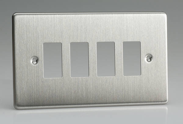

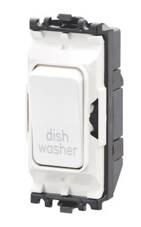

You can get what we call grid switches marked with what they supply 1684747829314.pngthis one for dish washer for example and fit them above counter 1684747922308.png all together which can include fuses, but it is personal taste, some people don't want the wall covered with switches, the only switch you may want in a hurry is the washing machine, if the weights get loose, and the machine does not auto switch off, it can do a lot of damage before you can get to the isolator, although today most have sensors so auto switch off, as for rest, it may require fuses, as no plug and socket, but as to switches, if like my kitchen, one would never get to them in a hurry under the sink as full of stuff which would need clearing first, so a bit pointless.
