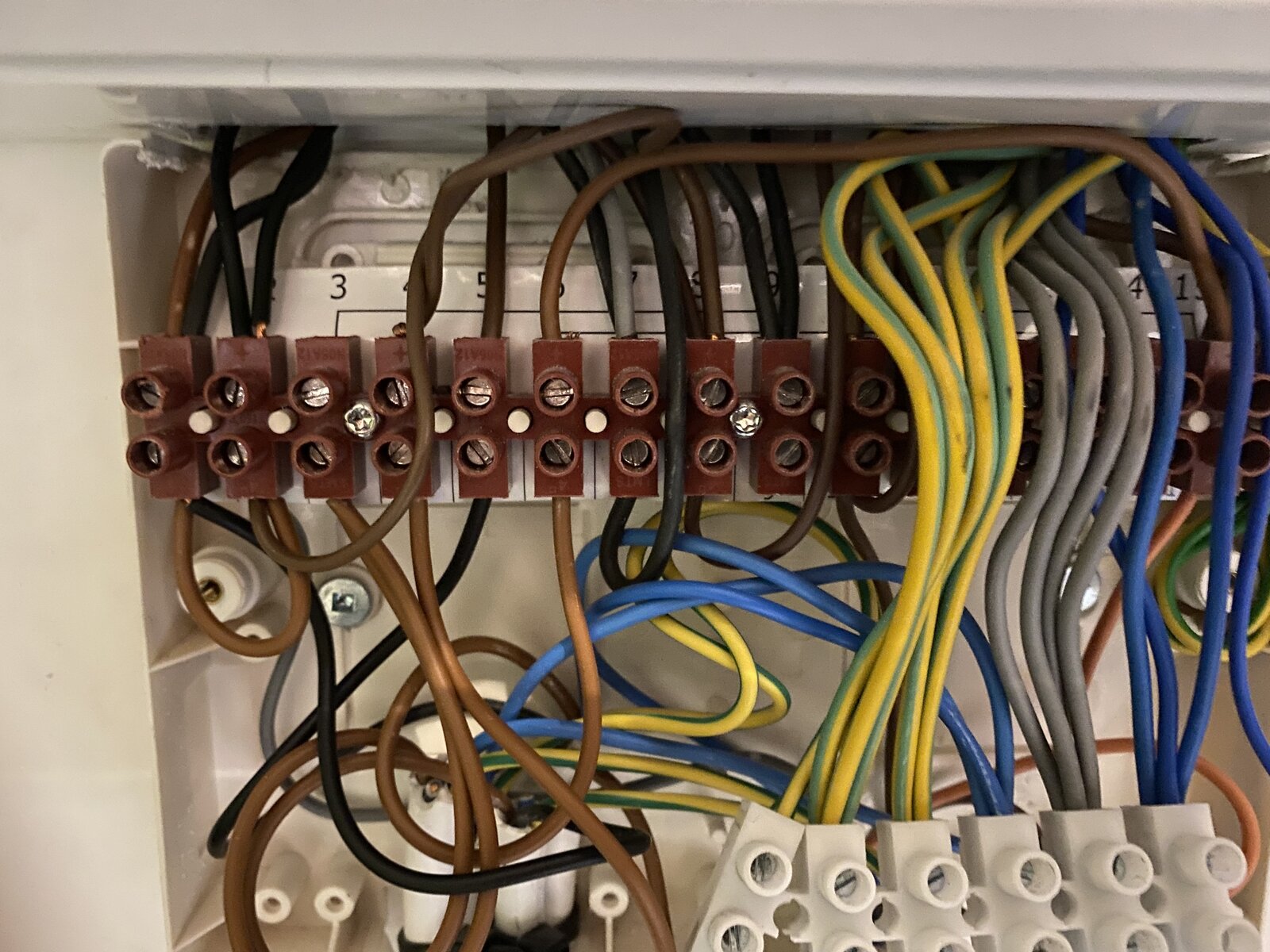

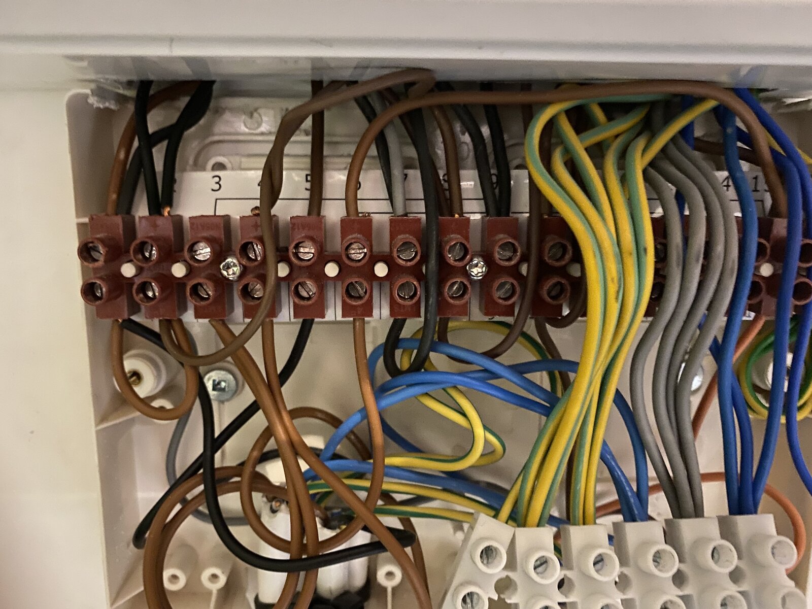

Hi all i have a danfoss heating controller if that’s the correct term. It controls my oil heating and thermostats for each zone, it also should engage the pump for my back boiler when it’s thermostat gets to temp but it doesn’t seem to be getting any power. I’ve disconnected central heating pump power and connected to back boiler pump and the pump fires when u turn the heating on so I know the pump works. As I said doesn’t seem to be getting power on its own. I’ve attached photos of the danfoss controller to see if anyone has any quick fix for it! The back boiler and stat lives are into the bottom of number 3.Thanks in advance

I have two zone valves and two pumps, and it needs relays to make it work correctly, under floor heating controllers often have relays built in upload_2021-11-20_9-5-17.png but with set up you have likely bespoke, where some we hope cleaver heating engineer who installed it has designed a system.
So first question, has it ever worked?
So in my case the zone valve has a micro switch, so as it opens it can switch some thing else on, for example boiler and pump, or boiler, or pump, but if boiler and pump, then that means both boiler and pump are connected together, as only one micro switch.
So in my case the micro switch turns on a relay, this relay has three sets of contracts, however only need two sets, so it switches on both pump and boiler, but when not activated boiler and pump not connected, so another relay can turn on same boiler but a different pump.
I can't see any device which would allow the two boilers to work without some sort of relay.
I am lazy, and if I had to do that job likely I would use a PLC to control it, as I know how to program PLC's so for me easy, but how a plumber or heating engineer would do it not sure.
I would start with a truth table, I would guess.

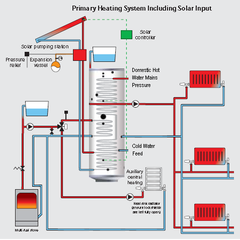

My brother-in-laws old house had similar system, he had twin storage tanks something like this Torrent pipe example.PNG and a very complex control system to ensure always spare capacity for hot water from solid fuel water heater.

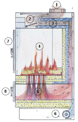

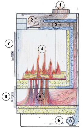

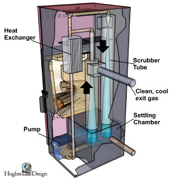

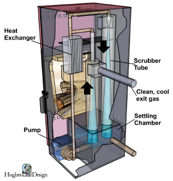

The main point is it should fail safe, be it sink radiators to get rid of heat, 12 volt battery backed pumps, thermo syphon, or other method, we see adverts for very cleaver stoves wallnoefer.PNG Hughes Condensing Stove 2 small.jpg but very little on how one ensures the pumps don't fail or methods to put fire out should pumps fail.

Hi no it has never worked the thermostat on the pipe coming from the back boiler will click on and off but the pump never fires, even if u turn it all the way off and then on (I’m told
It should fire on and off) it does nothing when I lit the fire last week the hot water tank was getting hotter so I presume the flow of water is there, there are two circuit breakers in the conduit above the danfoss controller

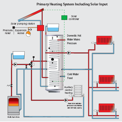

Since it seems you have thermo syphon to heat DHW the safety aspect is not such a problem, but how to design an automatic system not so sure.
Looking at that system, it uses a heat store to combine, but some one at some point designed yours, and it may be very different. You want DHW hot enough, so it would make sense to have the pump only activated once the DHW is hot enough, but what I am doing is trying the read the mind of the designer.
The whole idea of multi-fuel is relativity new for domestic, and often also can be very costly, so we see loads of compromises, so there is no C, S, W, or Y plan, it is what the installed has decided.
