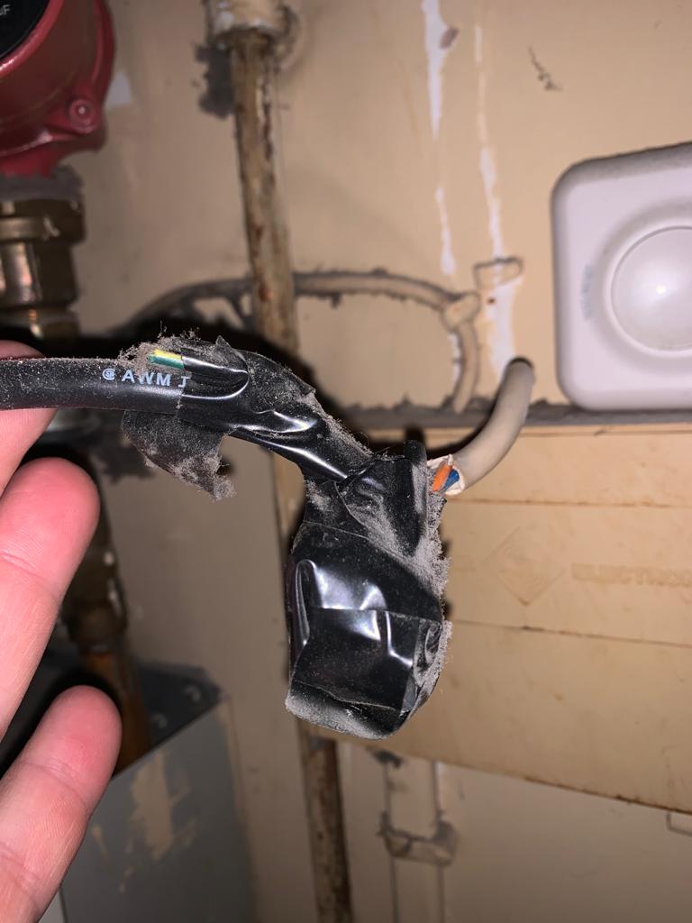

Hive to Danfoss model 102

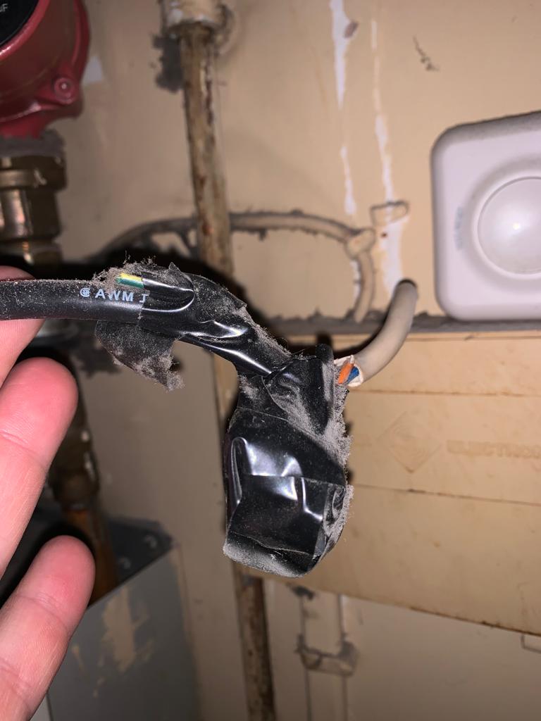

It go's into a block and then changes to white?? looks like a right mess. look at the bottom of the photo
This is the block
remove the tape and post a pic so we can see what has been done, you are correct a total mess

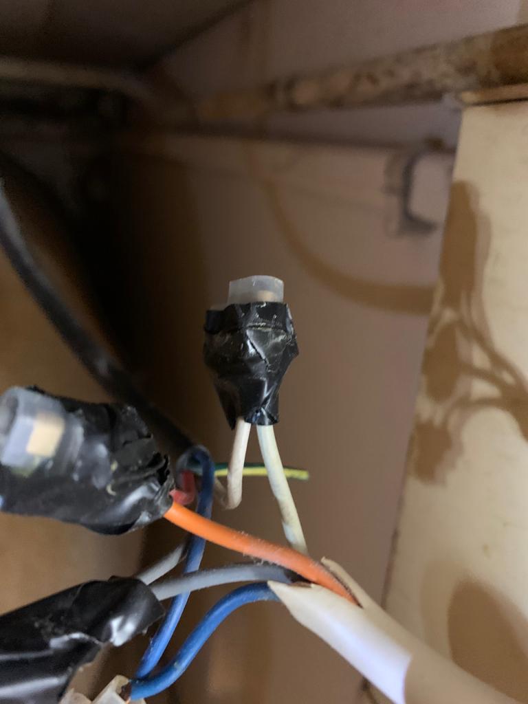

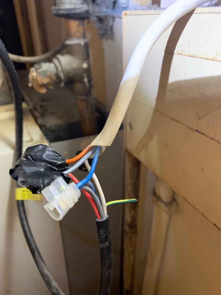

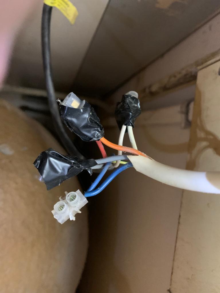

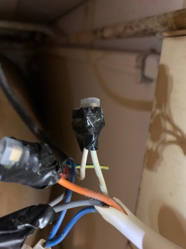

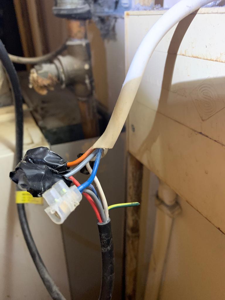

Sorry for late reply hope this is right?
OK no reply about the wiring block so I assumed it doesn't matter so I have installed the hive it works of sorts and I haven't blown anything up.
Apologies for the non reply, as @ianmcd asked for the photos, I assumed he would reply.
Hopefully you will now have made the electrical connections safely, so that they are in an enclosed junction box to insulate them properly, and the cables are securely fixed / clamped, so that the electrical connections are just electrical connections, and are not responsible for the mechanical support of the cables. What is shown in your photos is potentially dangerous.
it works of sorts.

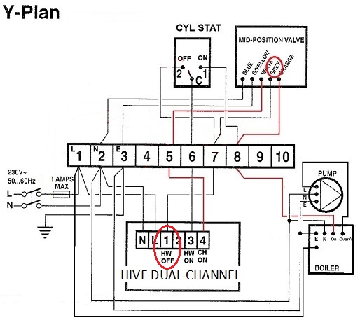

You should have a wire in Hive Terminal 1 (Hot water off) that goes to the motorised valve's grey wire. If that is missing, it won't work properly. Alternatively you can set the Hive to 'gravity mode' as mentioned previously. This will automatically switch the hot water 'on' at the same times that the heating is set to be 'on', and the system will wok as it did with the Danfoss 102.
Thanks for the reply so all I need to do is run a new wire from Hive T1 OFF to the grey wire in the terminal block.
If by "the grey wire in the terminal block" you are referring to the point where the grey wire from the motorised valve is connected, then yes, as per the diagram I posted earlier. You will see that the MV's grey wire is shown connected to Hive 1 via the terminal marked 7 in the example below.
