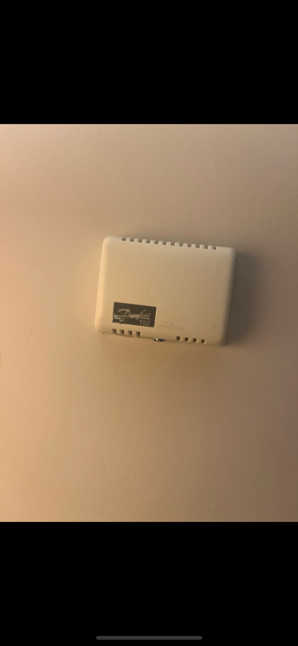

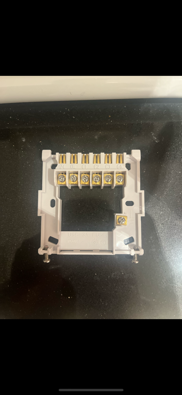

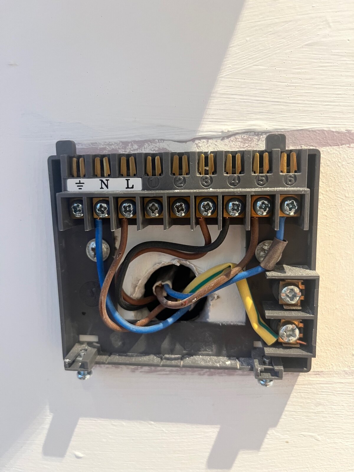

Hi everyone,
I've had a look through previous threads but couldn't find what I was looking for but apologies if this has already been asked.

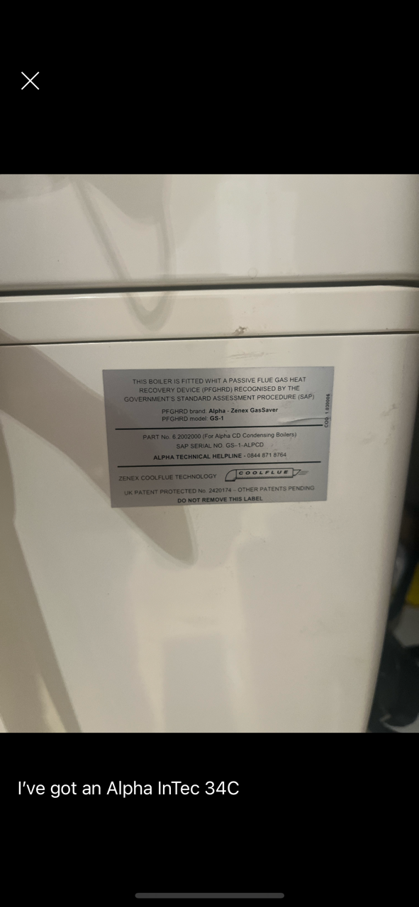

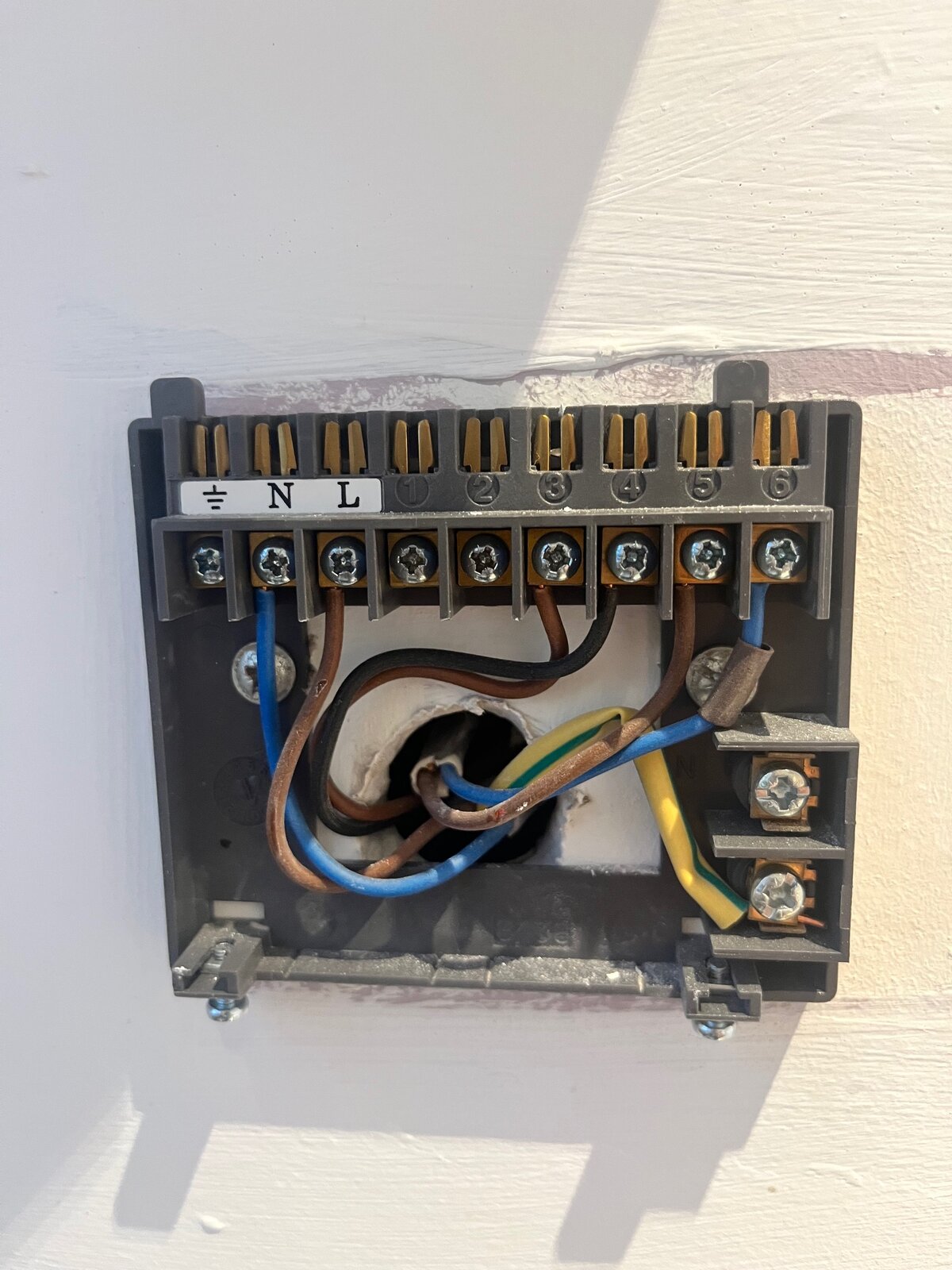

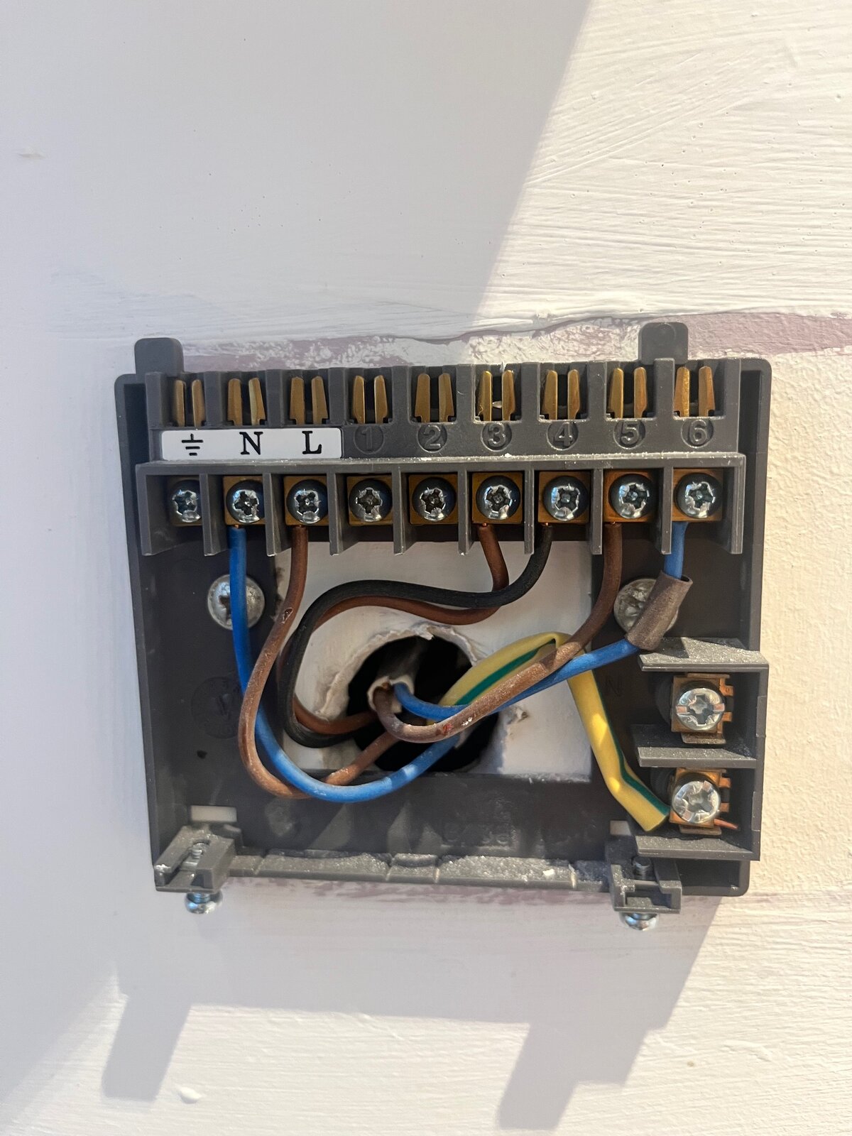

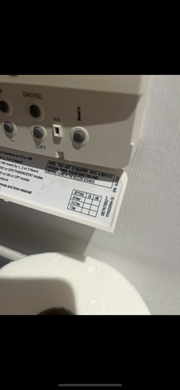

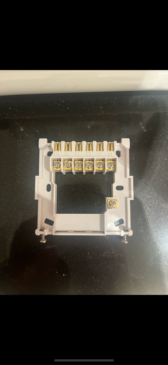

I currently have a Danfoss TP9000MA thermostat running with an Alpha InTec 34C boiler and Danfoss TS2 Temperature Sensor. I've attached a photo of the current wiring. I've tried moving the wires from 3 (TP9000) into 1 (Hive) and 4 (TP9000) into 3 (Hive) with Wires 5 and 6 (TP9000) not required as I think they are for the sensor but this didn't work. I'm really struggling to get a professional to fit it so any help at all would be really appreciated!
I've attached some photos for reference too.
Thanks,
Chris

It shouldn't be too difficult. You are basically replacing a controller with another that is pretty much identical. [From a wiring point of view]
A Hive Dual Channel should replace the Danfoss TP9000. As you can see below, the connection terminals are identical. So, all of the wires you have in Danfoss terminals N, L, 3, & 4, are simply moved to the same terminals of the Dual Channel Hive.

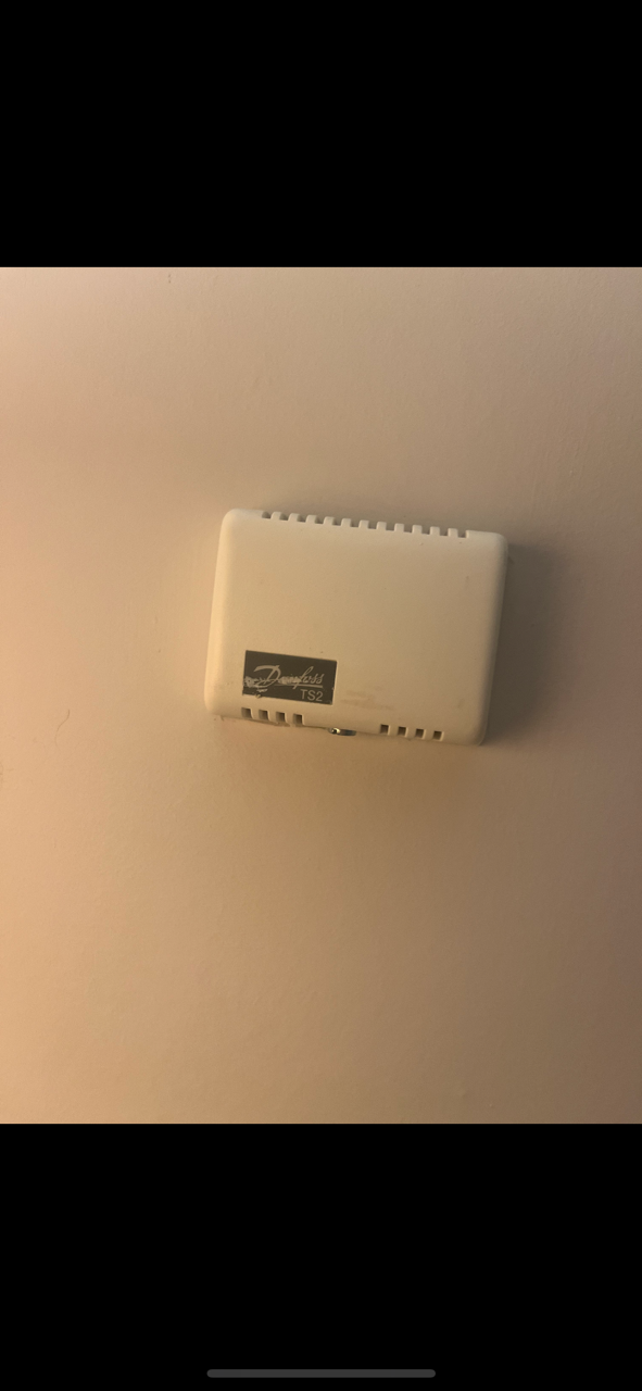

The Danfoss TP9000 terminals 5 and 6 are for the remote sensor so this is simply removed as it's no longer required.

According to an internet search, your boiler is a Combi, so single channel would normally be appropriate, but you do appear to have a hot water and heating control.
Interesting, so it is. :unsure: The Danfoss TP9000 is a dual channel device, so maybe it used to be a dual channel system that has been converted to a combi and the old controls left in place.

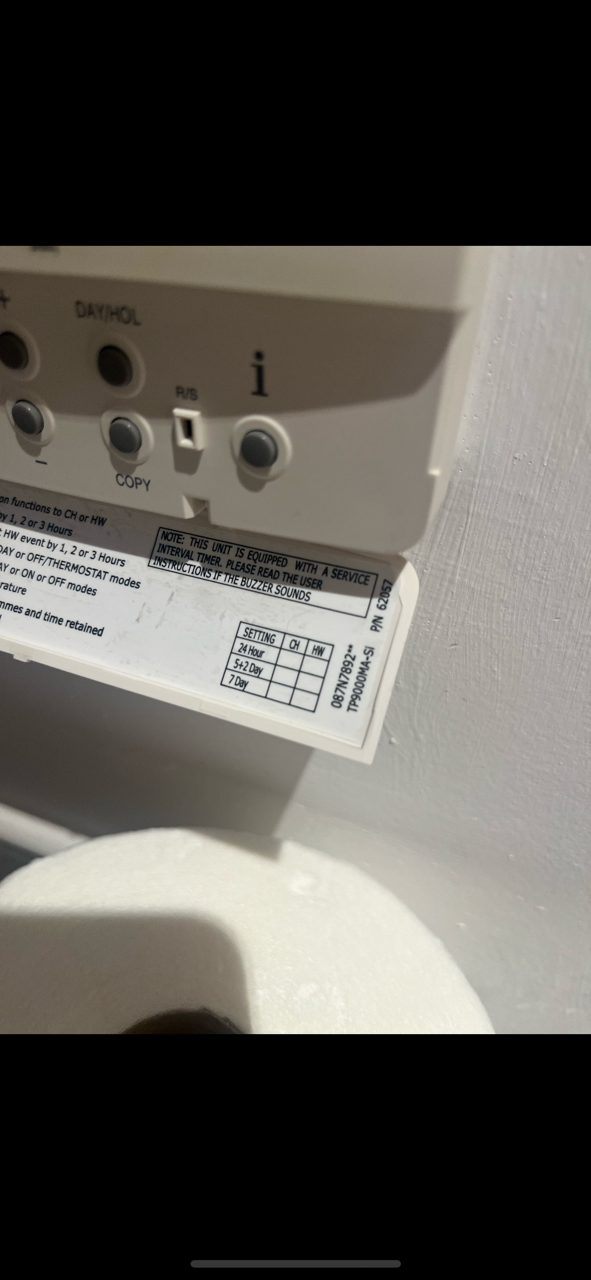

I'm assuming below is what you currently have. As you can see the 'tap' symbol I've highlighted shows that it includes hot water control.
If this is what you have, what do you use this part of the controls for?

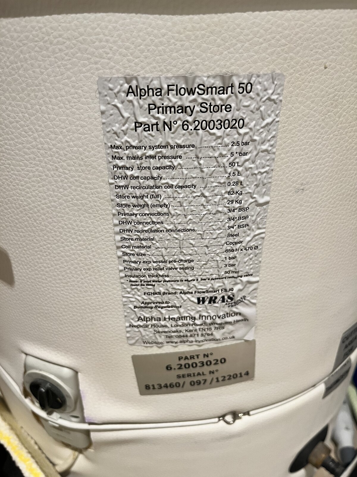

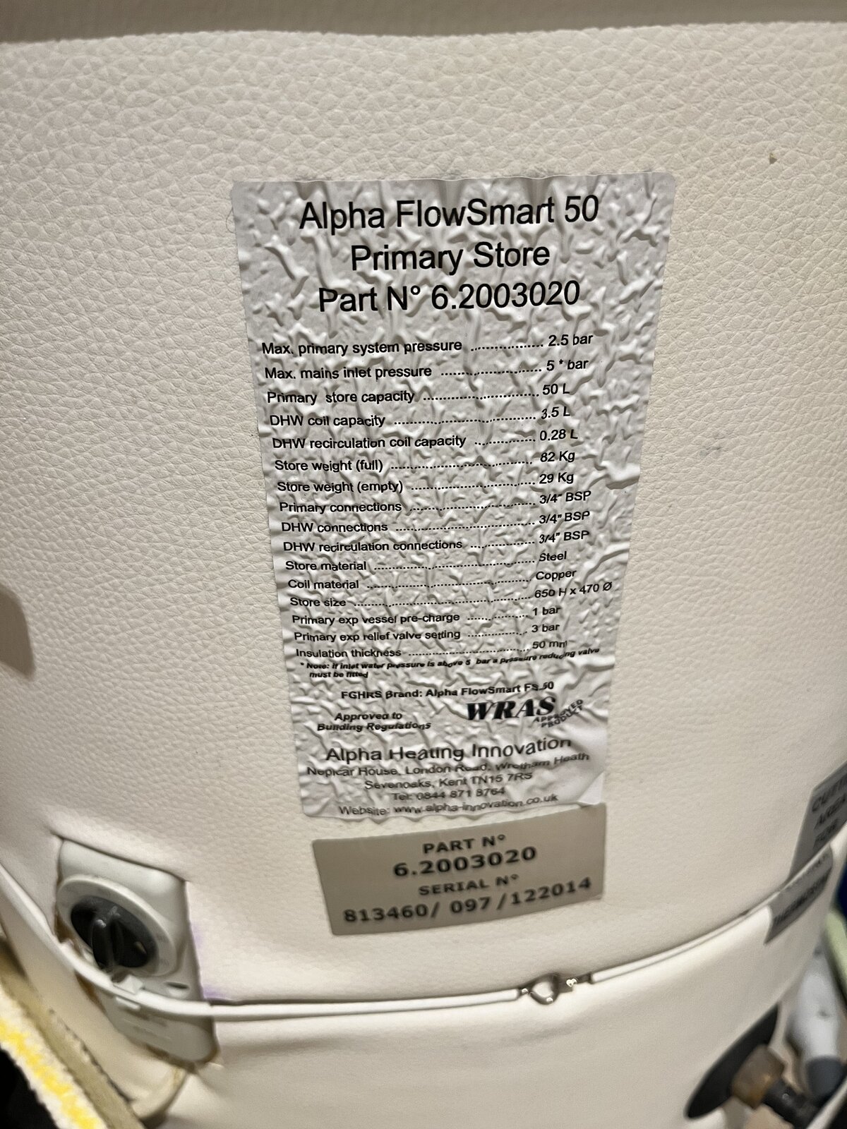

There is a cylinder under my boiler although I've never had to heat the water or anything like that, it's always hot on demand? I only use that boost button for the heating. We have two bathrooms and a separate WC too so that's maybe why?

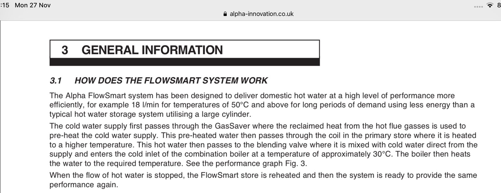

I’d say you have a hot water cylinder then it could well be setup that the Combi provides the hot water for it. I doubt the cylinder is on demand, it would need some form of heating up.
I agree with CBW; unless your combi is equivalent to Sellafield, that is :D
(It takes at least a couple of minutes to boil a kettle, so any cylinder bigger than that could not possibly be heated "on demand", to my mind).
I have this which I’m assuming is the hot water cylinder. But I’ve never turned my tap on and the water be cold and then had to push a button or anything to make it hot.
I’m a total novice at this so apologies but is this thing always heated? Or just at certain times? And does this mean I’ll need the dual channel hive?
