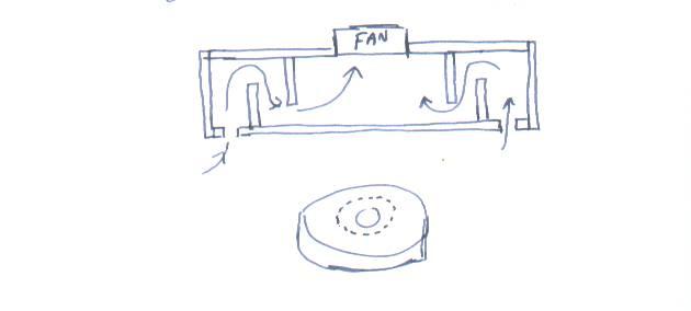

Is there space to build an internal light proof box over the fan ?
Fan sucks from centre of one side. Ring of holes around the periphery of the other side take air from the dark room.
Inside the box are two baffles to create the necessary bends in the air way
Circular box say 6 inches thick and 2 foot diameter. Circular wall around the fan and a second , larger radius wall inside the ring of holes.

I intended on putting a vent axia in-line fan in the void and duct it out via lead slate - problem solved. client insisted that wouldnt be good enough. and said he would buy fan so i left him too it!
problem resolved though made a black box with 2x 90* bends. managed to make it 110mmx110mm 90mm deep with a slot in the middle.
ventilation has also been taken into concideration and other means have solv ed that issue.
