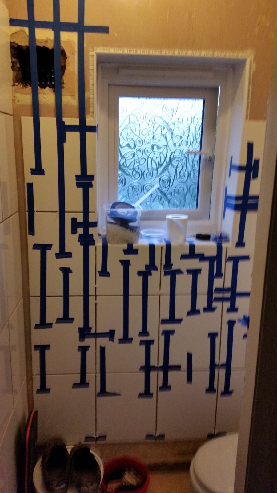

I've supported tiles with masking tape before, if you have a line of set tiles you can tile under and support them from slipping with tape until the adhesive sets.
Worked well for me, large tiles and hand mixed powdered adhesive.
I know this does wind people up but it was a night time project with kids in be so couldn't start drilling batons in.
Used the same idea in the kitchen as well and worked a treat.

The tape method rarely works for me. I use gorilla tape but still find that tiles are slipping. Is there a more reliable way of tackling this?
