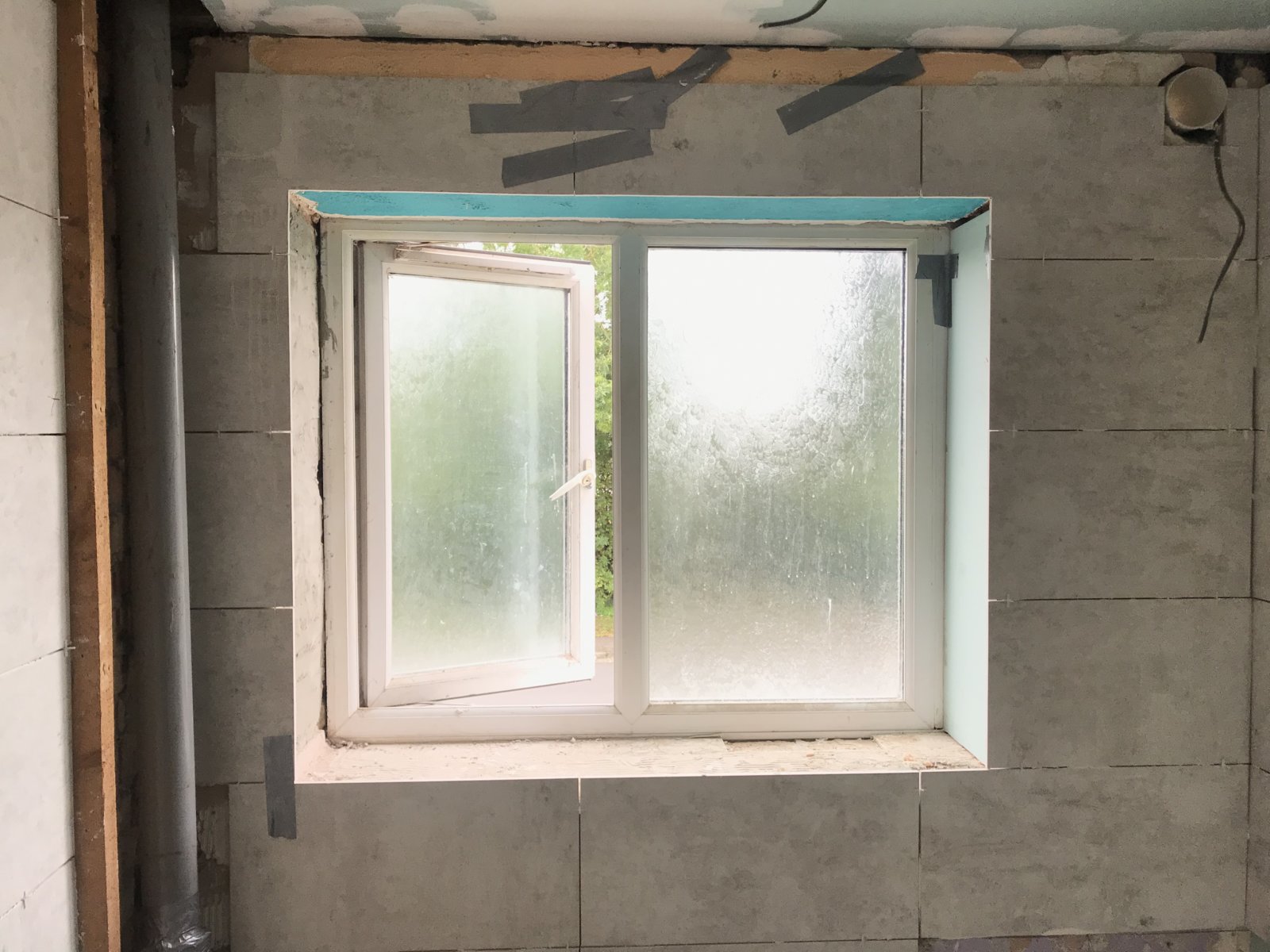

Update: Based on the advice above, I set the batten two tiles down (and a tiny bit of wriggle room). I dry fitted the tiles before screwing in place. It worked a treat. Here's a pic with the lowered batten:
Looks great, what grout gap have you run?.

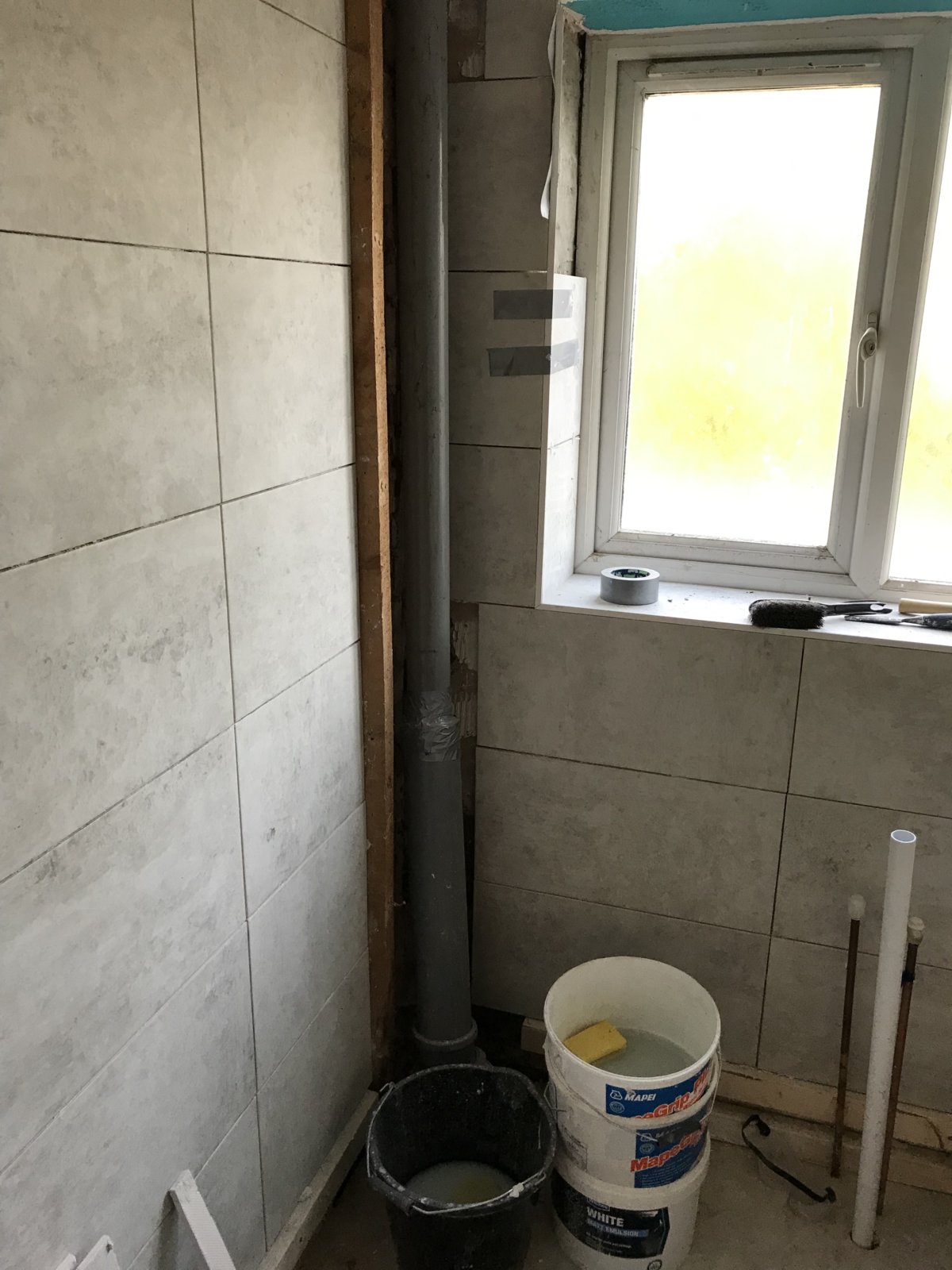

You didn't centre the tiles on the window, and what's that pipe thing in the corner with duck tape around it?
3mm gaps for grout.
The pipe thing in the corner...
That’s the vent for my soil. I had to convert it from 110 to 85 as that’s what a going through the roof. I used a rubber adapter and added duck tape for added protection.
I now need to box this and either tile or paint.
Also, I was able to get 3 full tiles on the window wall and opted for this rather than centralising on window
