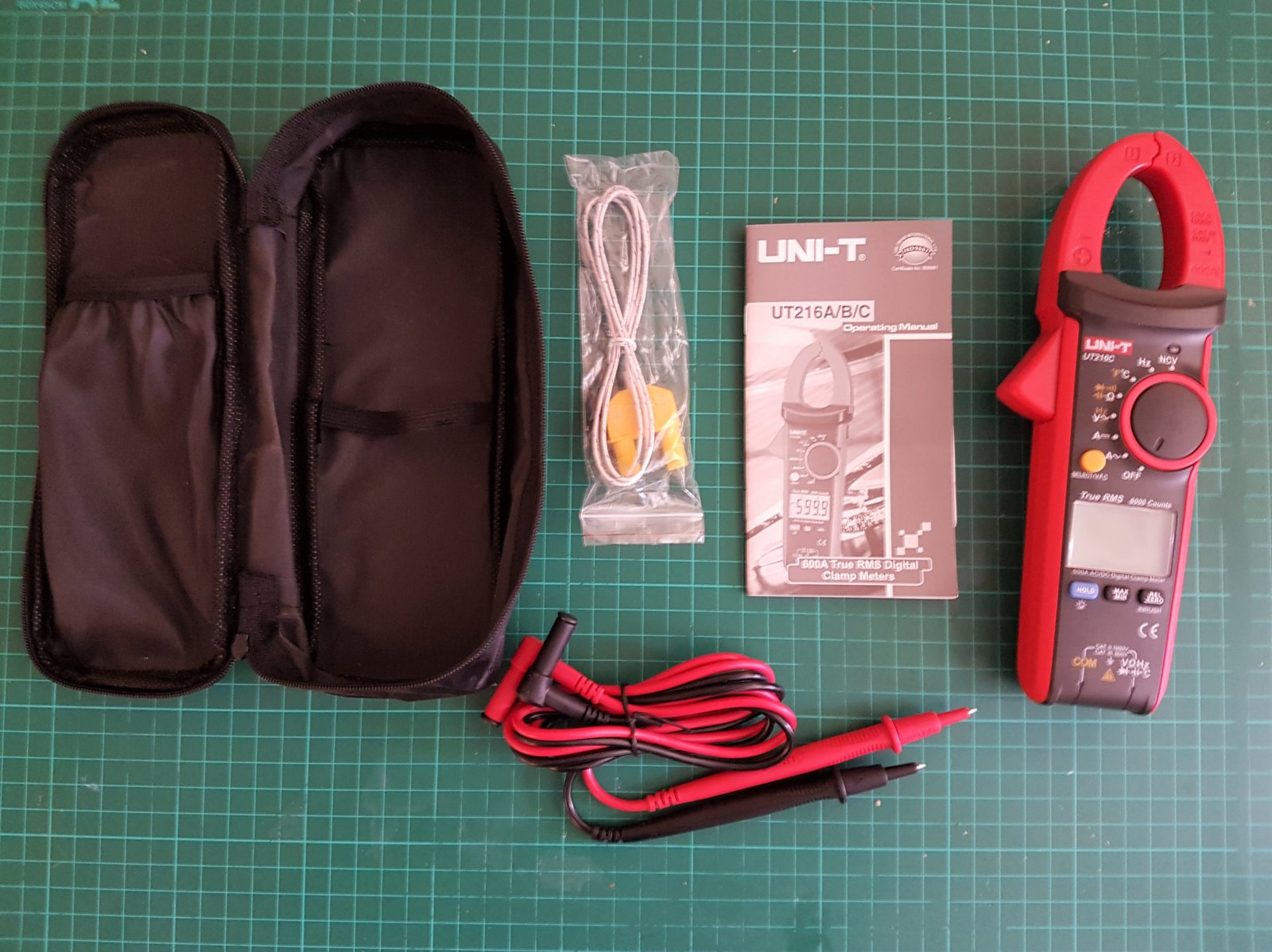

My tired old Fluke can't do true RMS, nor frequency, capacitance, etc, so I bought a UT216C...
The case is awful, that other thing is a thermocouple. (y)

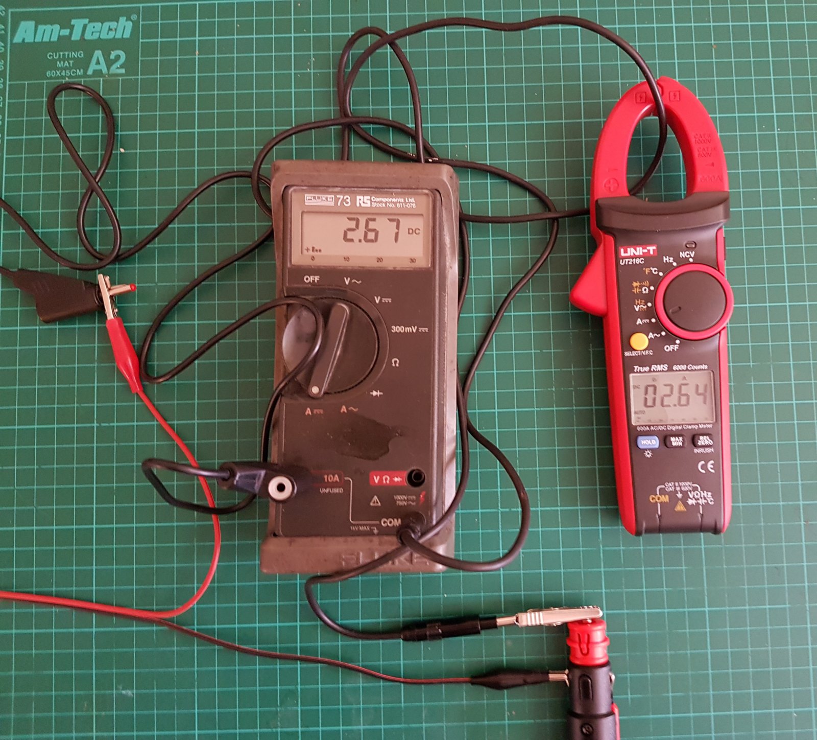

Only just got it today, so this is not a review, but I was just very impressed with the very first thing I wanted to try out, DC current, so I thought I'd share my findings. This is readings of an in car fridge, hooked up to a 13.8v power supply...
I'd say that's near as dang it! :cool:
I thought it would be picky about the position of the wire going through, or picky about keeping the wire perpendicular, but it isn't. I guess I still don't understand how the DC ones work!! :oops:

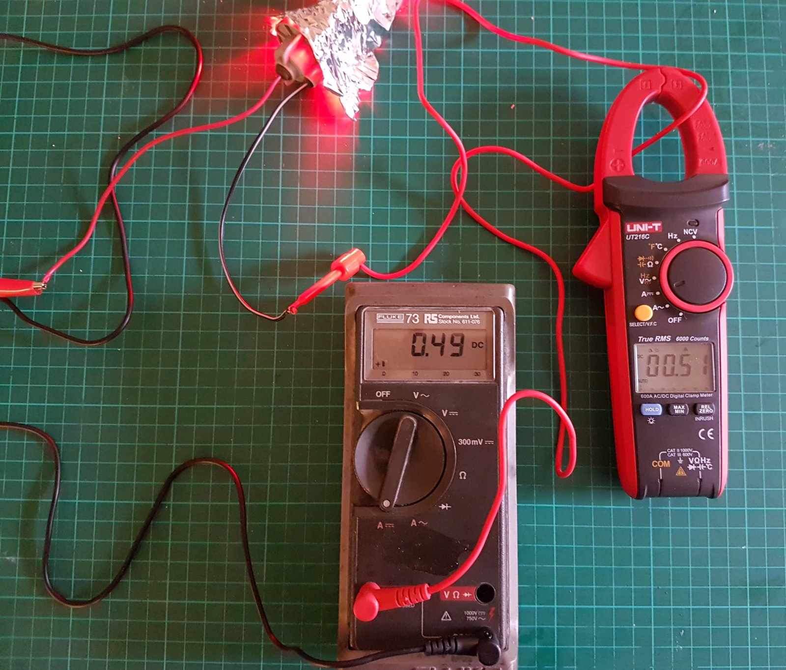

Still close enough at half an amp, the reading was stable...

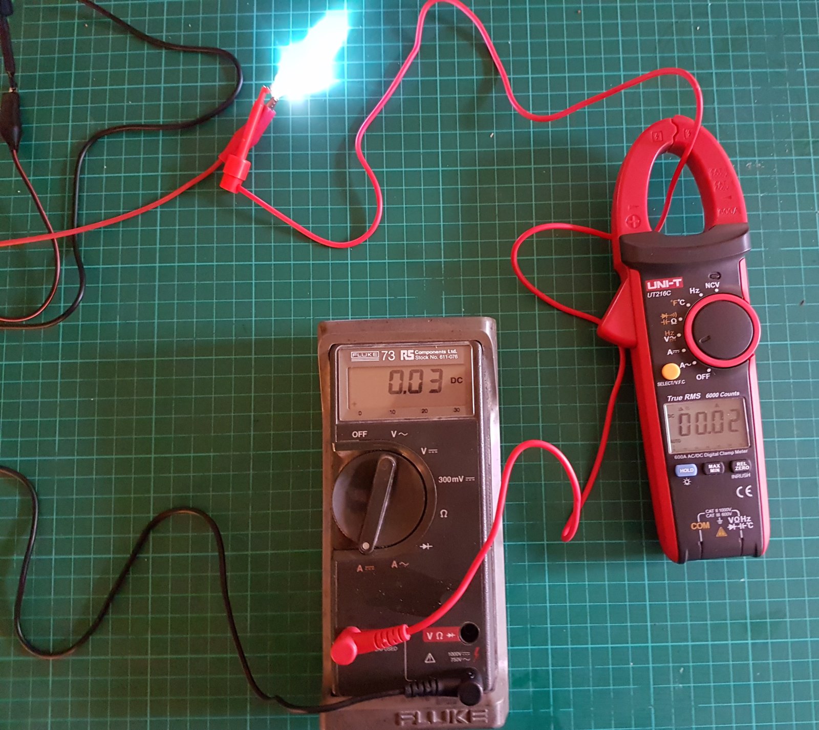

Red 12v 382 LED, (tinfoil so the photo is legible!)

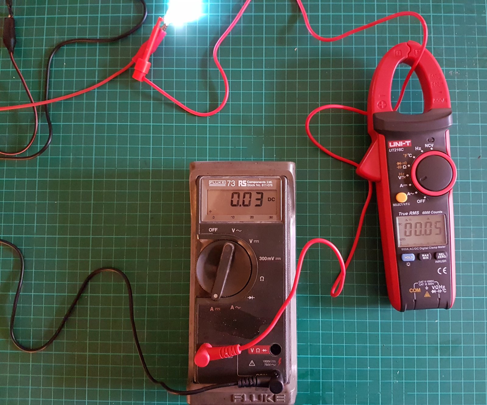

With a small 501 LED, it was fluctuating between 0.02 and 0.05, despite the Fluke staying at 0.03. I was not moving, the meter hadn't moved. The only other possible nearby influences nearby was the PSU, a switched off TV and the phone/camera of course.
It has it's uses, for sure, I'm pleased with it. But accuracy at below about a quarter of an amp is not to be trusted.
