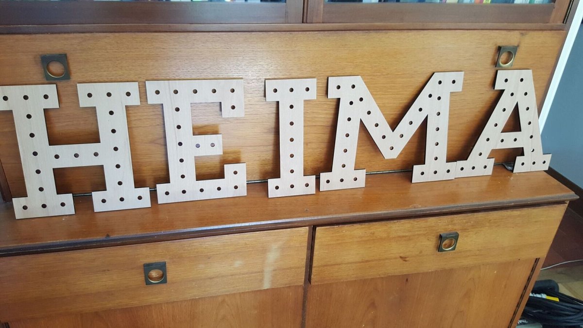

I'm making some marquee-type light-up letters like this:http://bit.ly/2avcDhJ.
I'll be using a DC current with little MES bulbs like this: http://bit.ly/2aKpIVr (table of current/power/voltage at bottom of the page). Want the highest wattage ones practical and all bulbs to be the same.
There'll be five letters with the following number of bulbs:

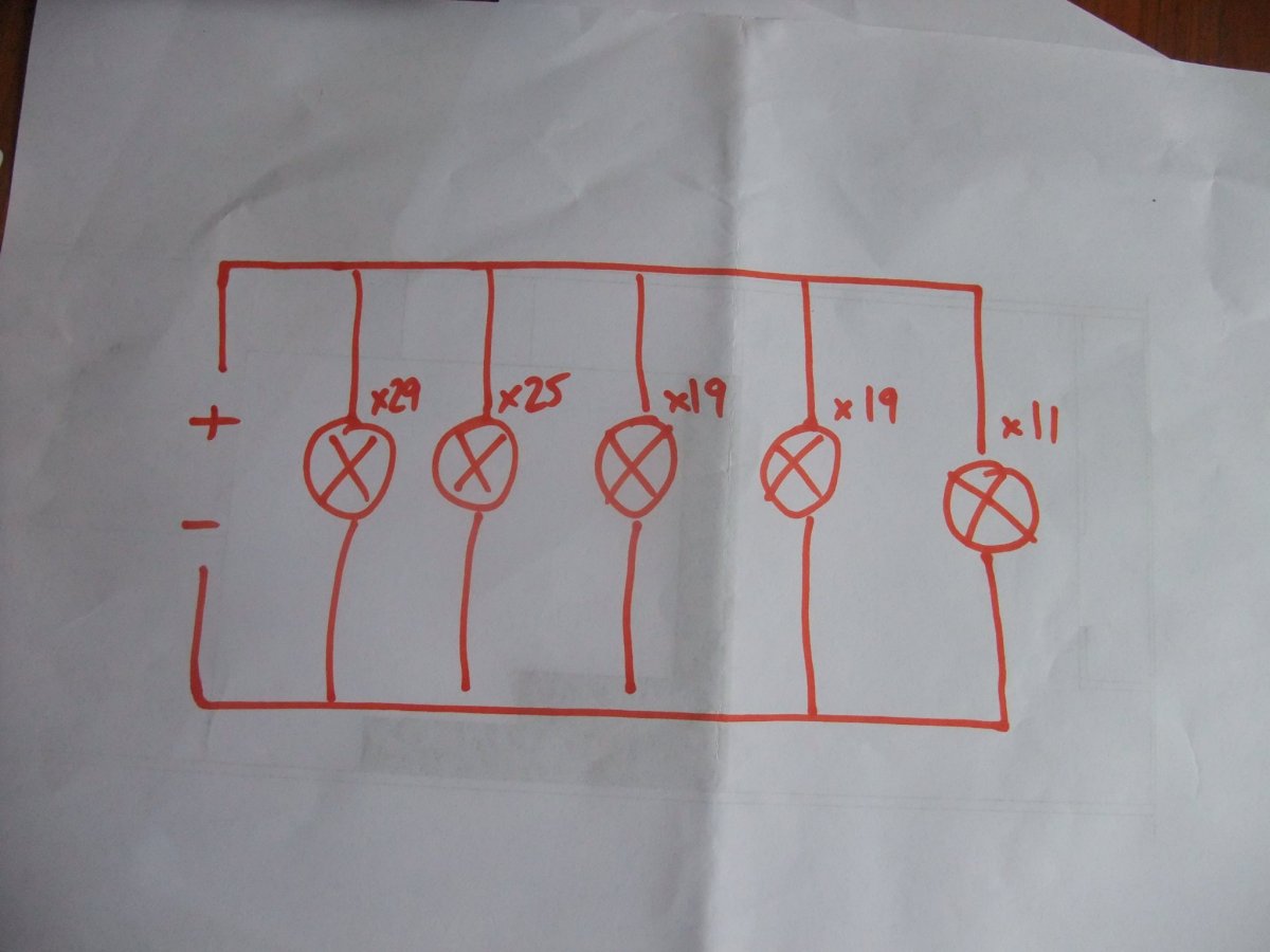

I'm wanting to use the most powerful bulbs that would be practical in terms of powers supplies etc. Guess they'd be wired in parallel like attached image. Would preferably wire them off one power supply but could split them into two. Guess I'll have to add resistors on the four lines with less than 29 bulbs to make the total resistance the same on each line but I'm basing this on an incredibly hazy memory of GCSE science/technology!
On second thoughts, if it's gonna be a lot easier I could just do five separate circuits and power supplies. Use the same, say, 12V supply but stick a resistor in the four smaller circuits. In any case would the bulbs themselves be wired in series or in parallel?

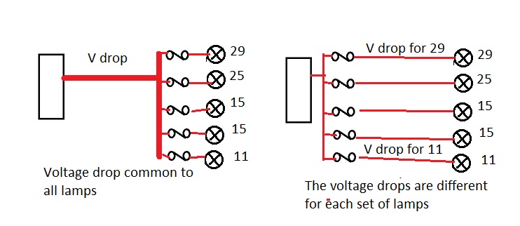

There is no need for balancing resistors but if the length of cable from supply to individual letters is more than a few metres then voltage drop needs to be considered.
A single heavy conductor from the supply to a distribution panel with 5 fuses close to the letters will means the viltage drop along the supply is common to all lamps.

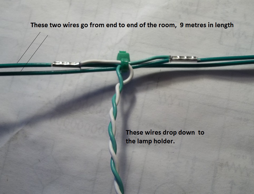

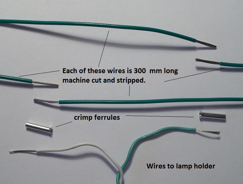

For the wedding lights I used this method of connecting the wires from the lamps ( 7/0.2 ) to the "ring main" wires (16/0.2 )
The 300mm lengths would not be 300 mm but would be the distance between lamps. Using a fexible tails to the lamp holder makes the assembly much easy. Maybe you could take all the tails from a letter to a pair of terminals and not use a ring in the letter.
