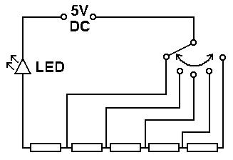

As I've said, ultimately I would like to rehouse my power supply in the original box and use a set of resistors to gain a range of voltages off the rotary switch. I made a little circuit diagram to illustrate this:
I haven't done a circuit diagram since school, but I think it's quite strait forward and should work. Based on this calculator and a 5V power supply I calculated that my primary resistor (furthest to the left) would need to be about 2 ohm with at least a 1w ratting. If I make each of the others 1 ohm I should get a good range of brightness.
What do you think?
So I thought I'd wire my LED in series with my power supply set at about 3V and slowly work up until the LED illuminates at around 3.6V.
NO that is likely to burn out the LED
LEDs must have a controlled current supply, unlike a filament lamp they do not have any significant internal resistance, once the applied voltage is greater than the forward bias voltage the LED will start to conduct current and will take all the current the supply can provide. In effect the LED becomes a short circuit across the power supply.
The current MUST be controlled by the power supply.
LED lamps that run on 12 volts are an LED and a driver in a package, the driver controls the current,
I am not up to date with modern high brightness LED'S but the early ones needed around 2 volts at 20mA max. Generally a 560ohm resister in series with the LED gave maximum brightness off 12 volts. Modern LED's may take currents. It must be remembered that LED's are a current operated device, i.e. constant voltage. In your circuit your resister values should be calculated to drop 3 volts at your selected current.

The constant voltage on the LED terminals is created by the LED when the current through it is within it's safe operating limits. The power supply ( or driver ) feeding the LED element must be constant current. ( or constant average current if in pulse mode control )

Thanks guys. I did some research and finally managed to get my head around how this all works. You'll be glad to know that I have successfully illuminated the LED, without burning it out in anyway. I'm surprised by how quickly it gets hot though, I think I will need to get some kind of heat-sink. I still haven't got all my goods to put it together in the microscope, but once I do I'll be sure to post some pictures :D
