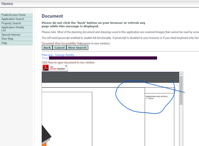

De Minimis (margin of error) help regarding new drawings & application.
The process is reliant on the plans being accurate
The plans can be accurate and still include a tolerance. There are always tolerances. Nothing is perfect. e.g. https://www.engineeringtoolbox.com/building-tolerances-d_1790.html
For a planning app why wouldn't you put a tolerance on - seems sensible to me??
here's mine passed with no issue.

Nonsense tolerances. Is that a yank site? They don't actually apply to drawing standards anyway.
Just because your plans were approved with a specific statement, does not mean that the statement is actually valid. If its a basic run of the mill extension its not going to be significant to planners anyway. The more contentious the proposed works, the more the plans are studied, and then the more relevant the details on the plans become.

Why random? As I hadn't chosen final materials I selected a workable tolerance for my planning purposes that seemed sensible. In my own industry we often come up against minor dimensional tolerances and have to make allowances. The buildings we install in to are built to tolerances which we have to work around e.g. https://construct.org.uk/wp-content/uploads/2017/01/NSCS-Edition-4.pdf section 10. Funnily enough a whole section on geometric tolerances.
This whole thread started with a question on what is accepted as De Minimis in planning applications. I'll stick with 100mm, because my own experience is that this is accepted. Perhaps others have different experience. AFAIK it isn't written down anywhere, so it is subjective.

The original extension has brick face up to DPC, that measures 4 Metres spot on from left to right, then it's rendered above the DPC, this added 20mm each side, so at the bottom below DPC it's 4 Metres across and above DPC it's 4.04 Metres. The original plans state 4 Metres.
A neighbour of mine had some sort of "Monocouche" type stuff applied to his house. Must have made it 2-3cm wider and 4-6cm deeper. Doubt he would have needed permission to extend his house by that amount.

Then when the digger driver turns up and wants to know the trench lines, and sees a drawing with plus or minus 100mm, where does he dig?
And then if he does plus 100 and the bricky decides to do minus 100 because that works bricks, that could be awkward.
Compare with just writing a specific dimension on the drawing.
It actually is written somewhere, in both the planning regulations and precedent in that the drawing is accurate, and there are various BS for drawings and CAD as well as for the subsequent construction - in which there are tolerances for materials and construction. But that's not to say that the specified dimensions have random tolerances, rather to allow for say a wall that is specified to be 4m long may be 4.01m long when built. You don't specify that a wall might be 4.01m long.
Exactly where did I indicate these were drawings for construction? They are PLANNING drawings!! Usually why planning drawings have "do not use for construction" on...
I didn't have any dimensions on my planning drawings - it was just a drawing with a scale..
