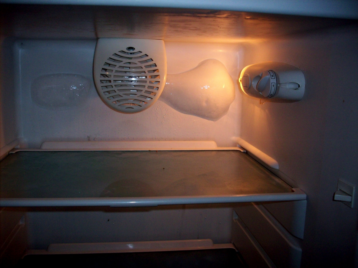

Dead Fridge
I give up - mods, can you help??

Moderator's note
Large pictures seem to need to go into your "Album" although smaller ones can be pasted. I can see your album but it runs to 25 pages and I can't see a fridge. If you make a new album called "Fridge" and put your pics in there you may be able to insert them (click on the camera icon) or if not I might be able to try again
BTW I see the fan below this note but no cold tubes or plate. If it is behind the back wall, the ducts might be clogged with ice and you need to turn off and leave door open for 24 hours or more for the lump to melt and trickle out. It should drain by a pipe into a dish on top of the motor.
If it has lost refrigerant gas pressure it is skip fodder.
