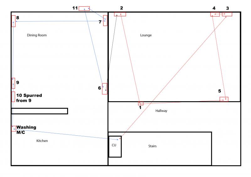

I disconnected the ring entirely, to establish which leg went where, and there appear to be no bridges, it seems its a genuine RFC.
I think the plan is now, unless somebody can point me in a different direction, is to split it into 2 x 20a radials, one for leg 1 (red) and one for leg 2 (blue). I would be happier with this arrangement anyway.
Second Round Of Test Results
End To End
CPC - 0.84
L - 0.52
N - 0.53
Interconnect
L-N
1 - 0.35
2 - 0.32
3 - 0.33
4 - 0.34
5 - 0.36
6 - 0.32
7 - 0.34
8 - 0.39
9 - 0.34
10 - 0.59 (spur)
11 - 0.35
L-E
1 - 33.8
2 - 35.1
3 - 35.5
4 - 36.4
5 - 35.2
6 - 35.8
7 - 35.6
8 - 36.0
9 - 36.0
10 - 36.9
11 - 55.9 (Outside SKT, not spur)
This is leading me to believe there is a problem at the outside socket, as to what that problem is, not a clue.
If you have (intend to) split the ring into two radials WHY are you bothering to show the second batch of ring final test results - aren't they the same as the first round.
As I suggested earlier treat each leg as a radial and test accordingly.
What should you expect as you move away from the consumer unit
from your R1+R2 results?
They're the ones that should give you clues to what the problem is - take them and put them up here.
Splitting it into 2 radials is an option, not something I am settled on just yet, I would like to resolve the existing fault rather than just ignoring it by splitting.
Second round of test results were to confirm I hadn't done something silly yesterday. Today was more systematic too, same technique at every socket outlet etc
I only just finished establishing which leg supplied which side of the ring when I posted earlier. I obviously could have just broken the ring 'half way' but now I know exactly which socket joins the two legs, so can break it there tomorrow and get accurate results.
R1+R2 will increase as you move away from the CU on a radial, meaning outlets 2 & 6 will have the highest reading if I break at outlet 2.

By the way you are not spliting the ring final circuit into two 20Amp radials for testing you are just splitting the ring final circuit.
In other words pick a socket on the ring take out one set of conductors from the socket - leaving the others in place.
Back at the CU put the L and E together into a terminal block and test each socket.
If you immediately start to get the high readings at the first socket on the new radial then you should disconnect the outgoing cable from the socket and only have the CU side cable in place - conduct the test again.
If you still have a high reading, then just for sanity sake connect the outgoing L/E together in a terminal block and continue to test along the circuit - with any luck you should get a low ohm reading.
If you get low readings all the way along then you know the problem is on the other radial so start the same process again. ;)

Why has the r1+rn gone up from spot on 0.26 yesterday to 0.32-0.39 (excl. spur)?
There is nothing you can add to two conductors of 0.52 & 0.84 (jointly measured in parallel) to give a result of 33.8-36.9 (excl. o/s socket).
I'm a bit suspicious that the r1+r2 results are (exactly) one hundred times higher than they should be.

There is no point splitting the RFC in to two radial circuits as there is still a high resistance somewhere and this will more than likely end up at one of the circuits.
You need to divide and conquer and follow the steps that riveralt has pointed out above.
Out of interest, have you taken a r1+r2 reading at the in/out-coming legs points at the CU, also have you taken any test with socket fronts off, testing across terminal points?

Surely this would give me one socket as higher than the others / unless they're all faulty. I suspect the outside socket needs replacing.

Obviously a pretty high possibility. But mergers are pretty straightforward. Connecting L1 to CPC2 and L2 to CPC1 with connector blocks in the CU. Measuring resistance between live and cpc at the socket outlets. Test leads nulled, using socket tester and verified a couple of readings at the back of the socket outlets.

It's the almost perfect end to end results that are confusing me. I can't see how L-E can be so high when the end to end's are basically perfect.
L - 0.52
N - 0.53
CPC - 0.84
0.53x1.67=0.89 ohms. Meaning the cpc is only 0.05 away from calculated for end to end, which is within tolerance. Just can't get my head around the massive difference & don't understand how it can happen. It's all about experience I guess

I mean't, where you have cross connected the two legs of r1 and r2.
Have you taken a reading at that point, across the two legs at the CU, as if it were a socket outlet?
Not end to end but cross connected!
