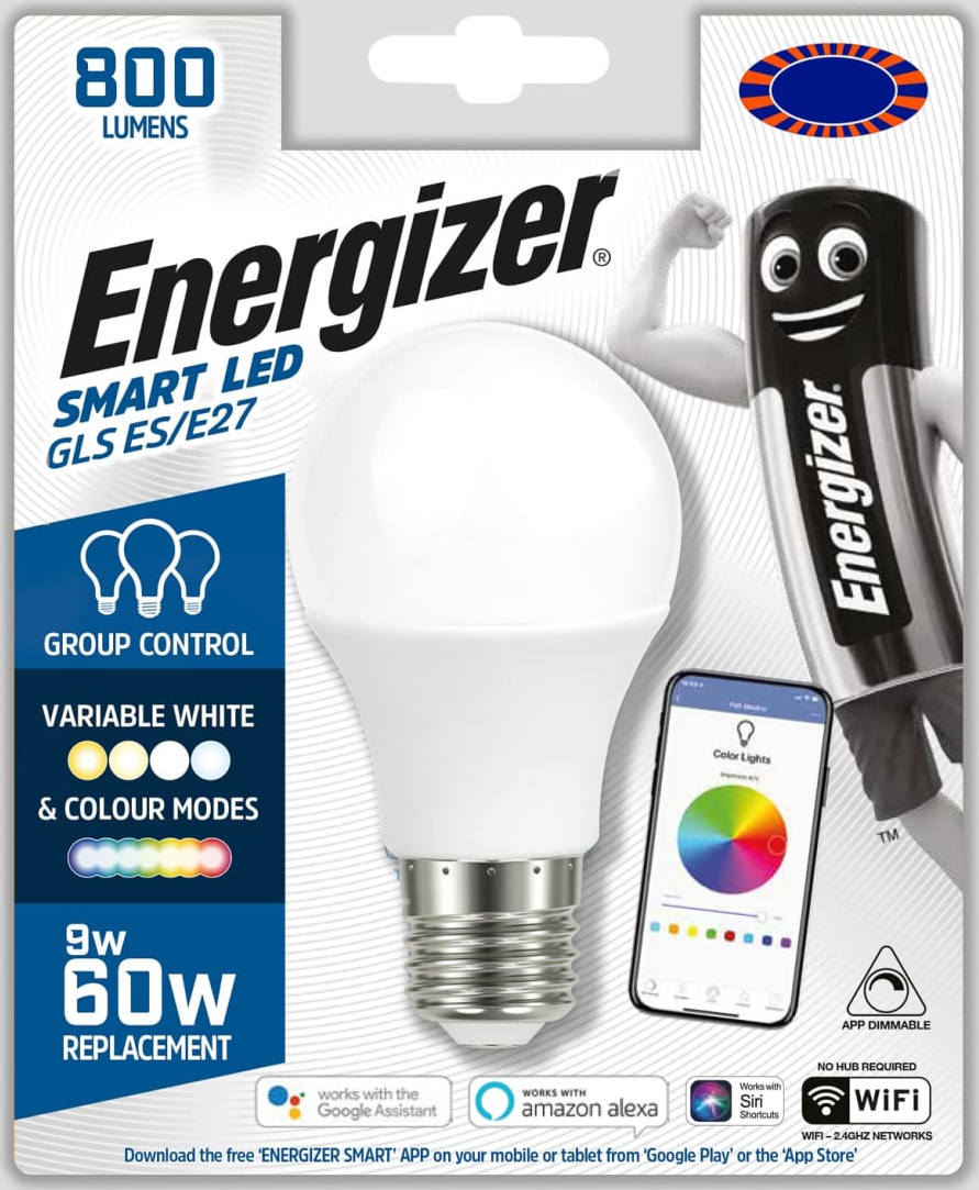

This 1699255134825.png I see as a problem, 1699255197441.png one looks at the package and sees 60 watt, only when one looks more careful do you see really only 9 watt, and they all seem to be the same. Also this
one sees the dimmable sign, any yes can be dimmed but not with a standard dimming switch.
