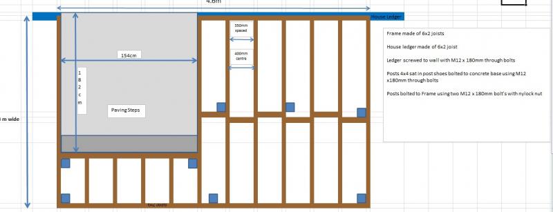

I have been planning a deck project and wonder if the below would be ok.

I plan to put a deck on the right hand side removing the 4 slabs on the floor and the 4 of the raised area but leaving the support walls underneath as extra support for the deck. I wondered if the below design was ok with enough support legs to raise and hold it off the ground by 30cm.
All joists will be 6x2 as will the ledger board which will be screwed to the house using M12 x 180mm through bolts (not sure how many I would need).
All leg posts will be 4x4 and will sit above the ground. I plan to dig holes and pour concrete into them (leaving for 3 days to cure) then drill holes into the concrete and use post shoes to bolt the legs onto the concrete so it looks something like this.
The 8 support posts will then be bolted to 6x2 frame using M12 180mm bolts with nylock nuts.
The question does this design look ok and will it be solid enough or converesly is this overkill and I should just sit the raised frame on some concrete slabs ?

Chris, I'm a diyer, but have built a 'floating' deck. And your design looks sound to me... just think of how you'll use it... everyday family use will be fine i reckon, but a 30 man rugby squad round for a BBQ might just test you calculations !!
Thanks sombrero
Do you think it would benefit from more support legs or noggins to give it more strength. I would like it to be as solid as possible without going OTT - makes sense to do a good job now
Cheers
I would suggest you support every joist - if you have the room underneath the easiest way is to have a couple of 6x2s running perp. to the joists, so supporting your joists from below.

Not much point just attaching supporting joists to the frame........
Put three posts in a line and attach to them a pair of 6x2s across, either side.

I remeasured and i dont have enough room underneath for another 6x2 im only raising the deck 30cm at maximum point so take 15cm for frame only leaves 15cm so it would effectively be sitting on the ground.
I thought if it was 4x2 I would need extra support but 6x2 wouldnt need as much as less likely to flex ?
Would more noggins help ? Again I was told that on 3m run of 6x2 I would only need 1 set of noggins in the middle.

Noggins dont add much structural support - they really only stop it shearing.
Therefore I believe each joist needs supporting in its middle somewhere.
You can have one post supporting two, by clever positioning of noggins either side of the post (so two joists "share" a post)

Floating deck is easier, cheaper and so very much quicker.
Sit the deck on pallets -screw pallets together . Screw the decking boards to the pallets . Rolls Royce job.

Could you dig out a channel for the supporting joists?
Do as I said - use one post to support two joists.
