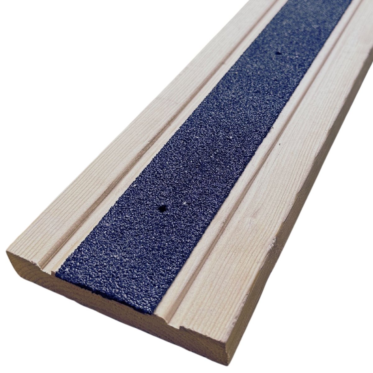

Hi all
We have a very large decking area to the rear off the house (long story as to how we ended up getting it!).
Sadly the rear of the house is the main entrance.
Now autumn and winter are on the way it is turning very very slippy.
As its now to wet to paint/varnish we are looking at some anti slip measures.
The deck grooves run in the direction we are walking to get to the side of the house and that is about 4.5m and the "walkway" would be about 50cm wide.
I looked at the gripping strips (screw on type) which are 5cm wide. leaving a gap of 5 cm between each strip I would need about 24 so thats about £100.
So my next thought was chicken wire, cheap, effective but looks horrible.
So I am now looking a wire mesh.
I am thinking of galvanised steel which I will staple to the decking and remove in the spring.
Unsure on whether to go with 6mm holes , 13mm or 25mm .
My thoughts is that the 6mm will be too small a hole.
Any thoughts and advice (apart from gritted paint etc)are appreciated.

25mm weldmesh would be fine, I would say get a heavy gauge, and don't try removing it in the spring
Surely putting all these little holes in the timber is only going to shorten its life?
you can buy anti-slip strips to align across the decking cheaply enough.

if you mean something like this
Thats what I mentioned in my original post, saying they were too expensive.

£2.75 @ Suregrip.co.uk
It all depends how big a price you want to put on being safe rather than sorry - cheaper alternatives may not suit your decking style and reduce the quality.
