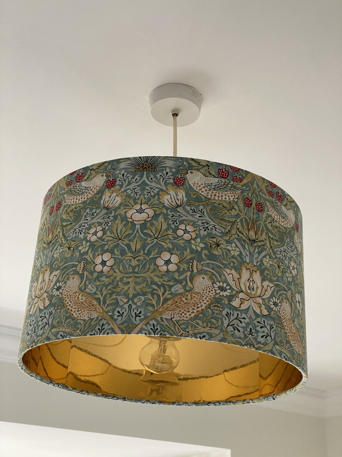

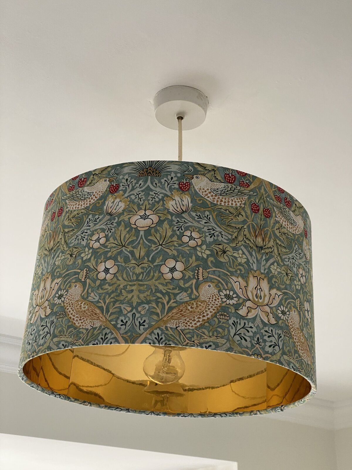

So I’ve bought a decorative polyurethane light weight ceiling rose just to add that little something to our newly decorated room.
Currently we just have a big standard plastic rose with lightbulb and light shade. We want to keep this but just add the decorative rose.
My dilemma is making the rose work with a plastic pendant. My idea was to just drill a small hole in the rose and then for that over the screw on plastic cover so only the wire is visible once the rose is up? The concern then is that the wiring is not accessible.
Any suggestions how I can overcome this or do I have to cut out a larger piece of the rose so that it fits over the hole top part of the pendant and then it can be screwed on or off and the wiring accessible? Hope that makes sense?

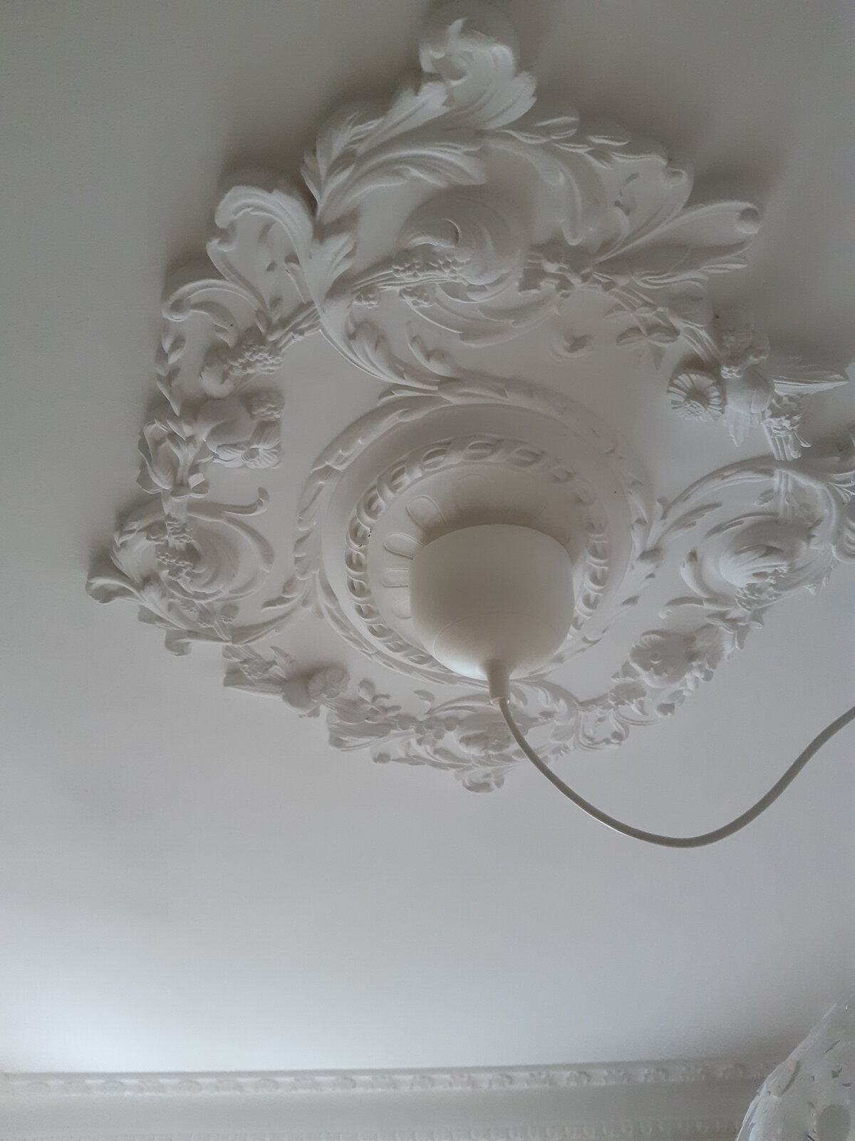

So I don't know if you have these in the UK, but in France you can get these plastic domes in all shapes, colours and sizes. Inside there is a domino thing for joining the cables that is a closed plastic box, and a cable gripper on the dome that stops the cord slipping through. The plastic cone has a ring inside that you hang on a hook in the ceiling. Photo attached.
Here Link to similar.
If you get a nice one it looks ok. Ours is not great but we have no earth so we are limited.

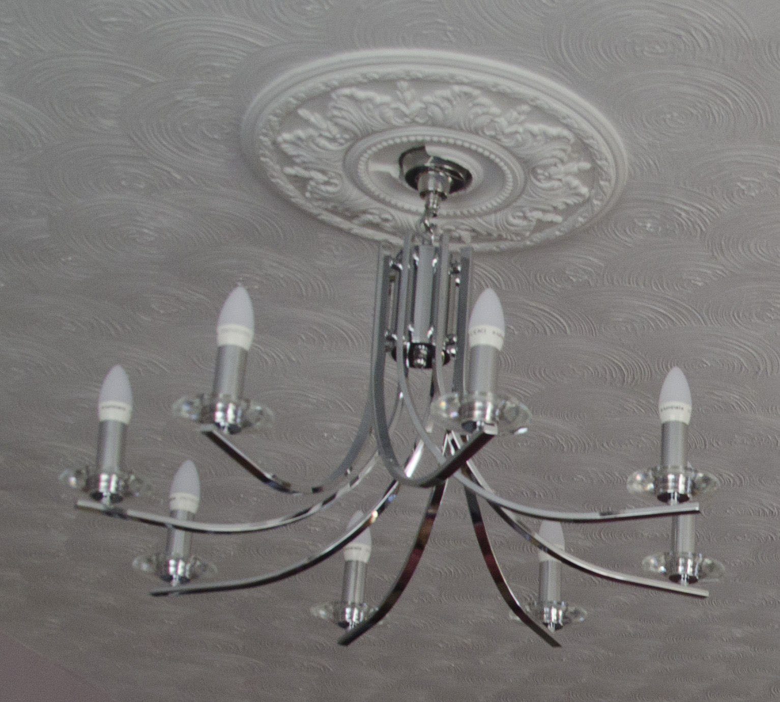

I typcially put the electric ceiling rose ontop of the decorative ceiling rose.
(ie Ceiling, decorative ceiling rose, electric ceiling rose)
Long screws from electric ceiling rose, through the decorative ceiling rose into the ceiling.
I do not counter sink the electric ceiling rose into the decorative ceiling rose.

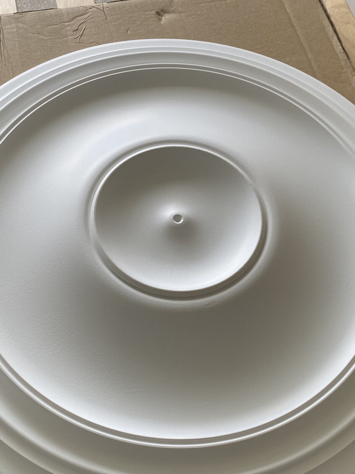

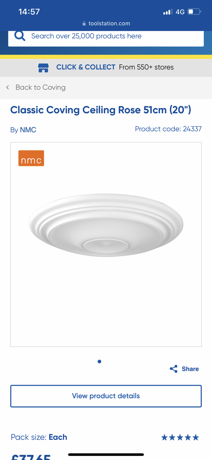

thank you for all of the advice. This is the rose we have, it’s only
Lightweight polyurethane.

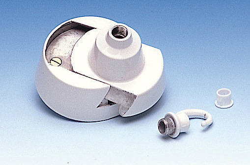

Two options.
These hooks will take a wire through the hook. You attach a chained light on the hook. They wires will be behind the ceiling rose.

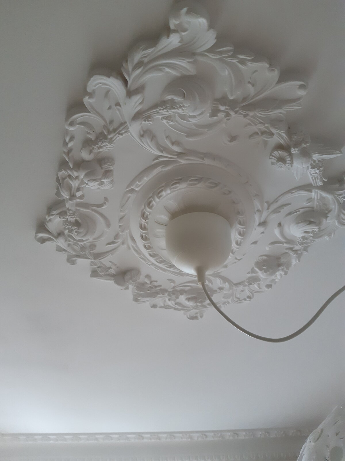

The problem I found was getting the electrical ceiling rose to slide in with the plaster rose in place, the electrical rose needs to be able to support 5 kg according to regulations, so it needs to have good screws holding it to the beams, Ceiling rose.jpg but to fit the lamp you only have a small clearance and the plaster had to be cut away to fit the lamp which really defeats the whole idea of the plaster decoration rose.
I really wish the previous owners had not put it there, DSC_4714.JPG took ages to carve away the plaster so lamp would slide in and out.

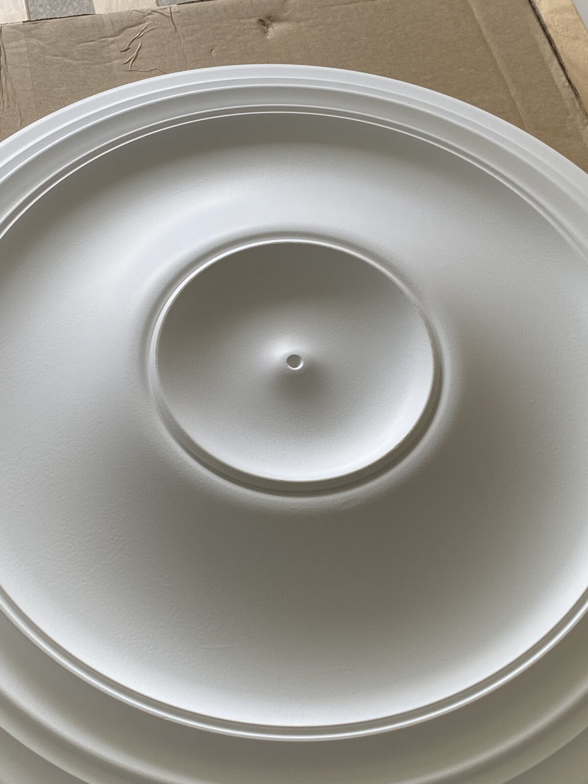

We don’t want a heavy light fitting, it’s just a standard plastic one with a simple light shade.
Here is the rose we have bought, it’s very light weight so doesn’t need to screwed in place

Sorry think you’ve misunderstood? The pendant with the wiring that holds the bulb will obviously be screwed to the ceiling, as it is currently. The decorative rose doesn’t require screwing as it is polyurethane
