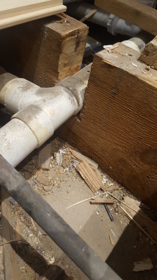

Deep joist notch

Just started redoing my bathroom and lifted some floorboards and noticed a serious bit of notching in the joist for the sink waste. Basically its a 7" joist and the notch is 4" deep. Is also only 30cm from the outside wall which am I right makes it even worse. I was wondering if I could screw a brace down the sides of the joist or something? I know it must have been like it for at least 10 years but still looks wrong.
If it's only 30cm from the end of the joist, it's not as serious as if it were near the middle.
The adjacent joists will also be helping.
Have any neighbouring joists been notched this deep?
Not as bad no the waste goes through the next joist but it's a hole drilled near the centre of it instead of a notch.

That's now performing as a 30mm joist. There are no span tables for 30mm joists in between 175 joists.
Perhaps a block in the notch and some timber, ply or steel plate across the notch would make it even less serious?
That's what I was wondering about. Screwing maybe a bit of 2" x 1" across the notch on each side of the joist? If I take it right up to the wall and a fair bit further the other side? Got to help a bit hasn't it?

I would be tempted to "reinforce" that timber with a length of timber above the pipe, it might not resolve the problem, but it would make me sleep a lot easier at night. Either side use two coach bolts, perhaps 500mm apart. I can't remember the name of the metal work that's like croc's teeth and circulate - the things you always cut your fingers on. Then tighten the **** out of all of it. Make sure the hole for the coach bolts are a 'tight fit', so you need a hammer to whack it through the hole.
Or, if you can replace the joist and route the pipe correctly !

Yes it might be OK, but the OP can't really be advised to leave it, since he now has the opportunity to do something with it.
Thanks for all the advice. I will use some wood to strengthen it above the pipe then. Will drilling through the joist for the bolts not weaken the joist further tho?
Putting in wood isn't going to do very much; find a local metal shop, and get 2 pieces 3mm thick about 50x250, and put one either side of the joist, then just use a coach bolt either end of the plate. Admittedly, it's been like that for 10 years, so it's not overly serious, but if you're going to do the job, at least do it properly.
