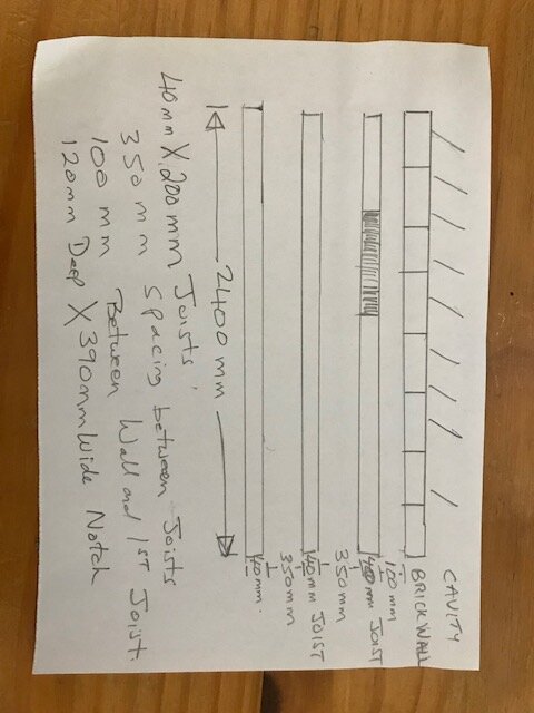

Notching joist to fit shower tray
An actual sketch of your layout would possibly help
Sketch below
There will be 18mm marine plywood fixed on joist and then shower tray on top
