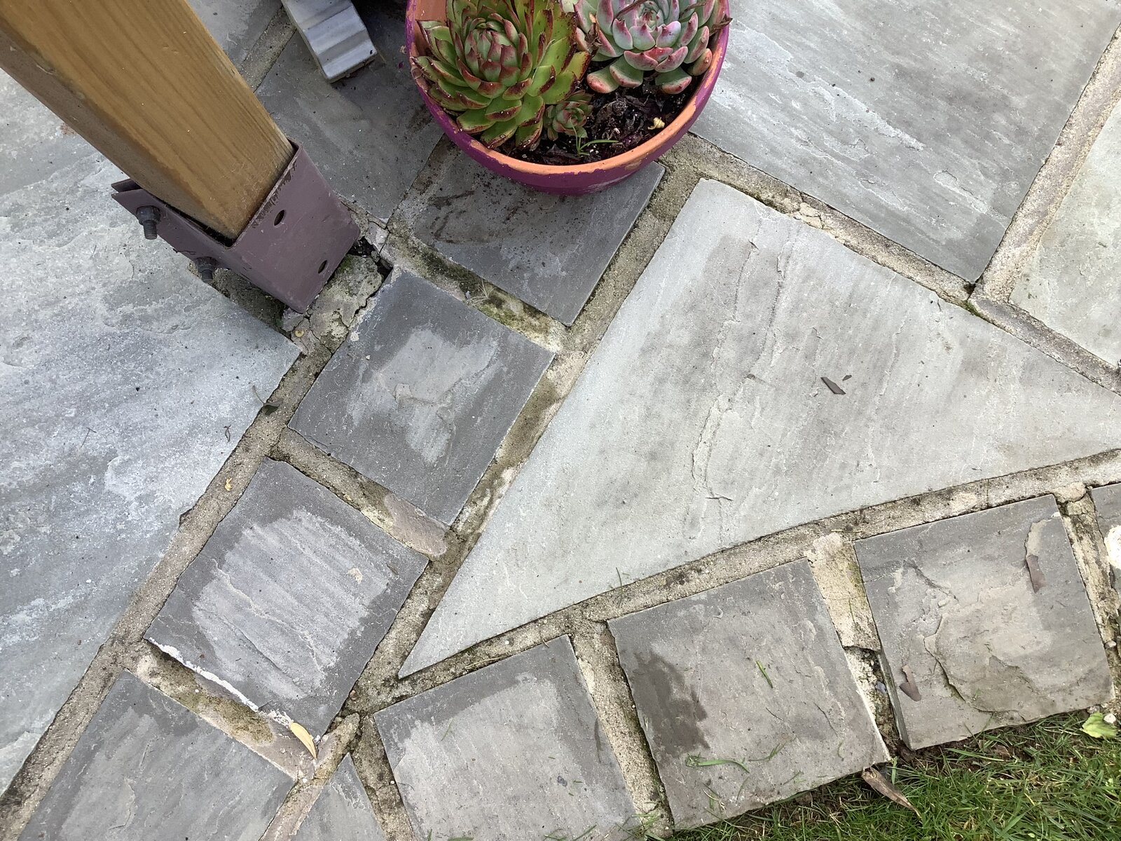

Had a patio laid professionally in 2018. A few months later I called them back as some of the slabs sounded hollow underneath. They lifted them and reset saying the mortar was faulty. Roll on 3 years and much of the mortar is coming away, stones now loose, called them back again, they said the whole patio would need to come up and that the mortar was faulty and they feared if they only part did the job it would get worse and they would go away and think about it. Two weeks later I chase them they say, we’ll replace the mortar in between the stones for free or to lift the patio, clean and relay will be £700. What would your response be? The original patio cost over £5k.

The original quote stated
‘Paving to be laid on full beds of wet concrete to provide a long lasting stable finish.
Paving joints to be pointed using the traditional mortar method to compliment the natural look of the chosen paving.’
Thanks for the responses, I asked them to come and look at it to give me a price to tidy it up, when they came to look at it they said it all needed taking up. I don’t believe for a minute a professionally installed job would need to be redone within 3 years. As for ‘a long lasting stable finish’, clearly this is not the case. I’ll contact citizens advice tomorrow and get some advice from them. I’m surprised that some of you think that it’s acceptable for a patio to need to be fully lifted and reset within 3 years and that I should foot the bill. I would pay to have it repaired if it was just a case of tidying it up but this clearly isn’t going to fix the underlying issue, the fact that they have said the mortar is faulty and the base is insecure.

Citizens advice state, I can get quotes from other paving companies to rectify the problem and it will be charged to the original company. The Consumer Rights Act 2015 covers a purchaser for 6 years for this type of problem. I do not need to give the original company the opportunity to repair but if I did, it would be free of charge, within a set timescale and at no inconvenience to me.
