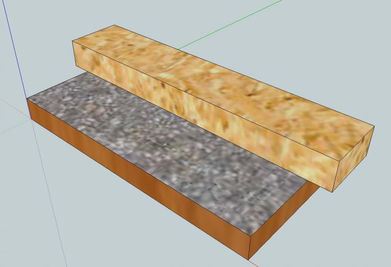

If the gaps are where panels meet it may be worth considering using decorators caulk (flexible acrylic caulk) in those joints. At least it smoothes out easily and it paints well. Where visible edges are poor you may want to consider making yourself-up a sanding board to smooth out the edge. They're basically a 4in wide piece on 3/4in MDF or plywood with a length of sandpaper roll glued on top with contact adhesive (or even PVA/rubber glue/aliphatic resin). To keep the plot square to the surface and get a true right angle edge you might want to add a fence, which could be as simple as a piece of 2 x 1in batten screwed onto the face:
The grey part is supposed to represent where the sanding paper has been glued. Hope it makes sense
As this is a childs bed, make sure that you take off any arrisses (sharp corners) by sanding them or by using a bearing-guided round-over cutter in a router or trim router (laminate trimmer). The tech is nice, but 80 grit sand paper followed by 120 grit will do almost as well
