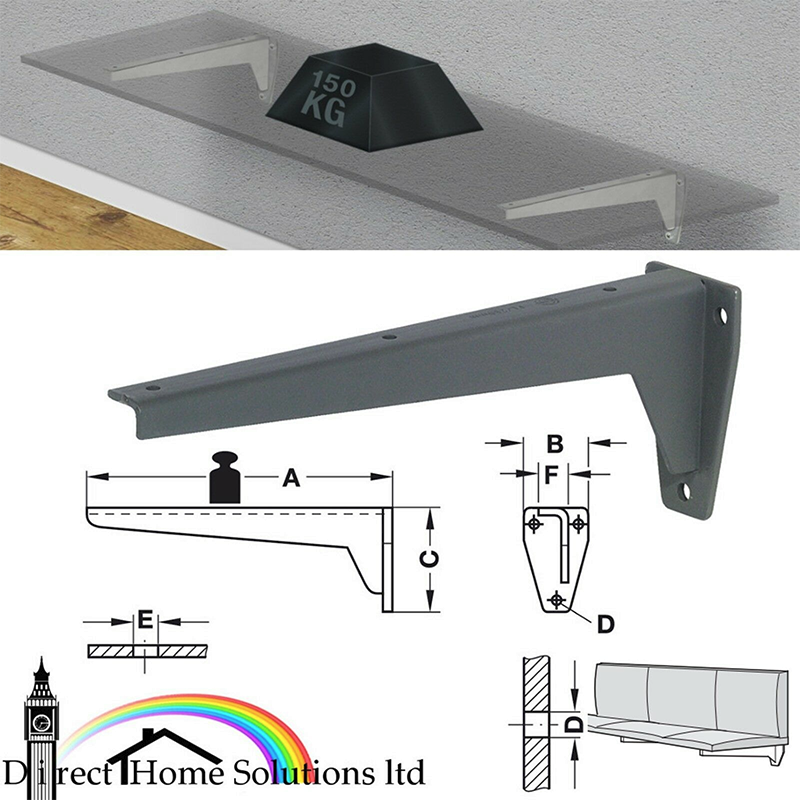

My question is would the following L bracket work?
The measurements are:
Dimensions A / B / C / D / E / F:
- 380mm / 65mm / 130mm / 10mm / 6mm / 25mm
- 480mm / 65mm / 130mm / 10mm / 6mm / 25mm
- 580mm / 82mm / 170mm / 10mm / 6mm / 30mm
The Karlby desk measures 63.5cm deep and will be cut to 160cm in length (70cm high).
Would that bracket single 380mm one work, be enough support to hold up the other end? :)
